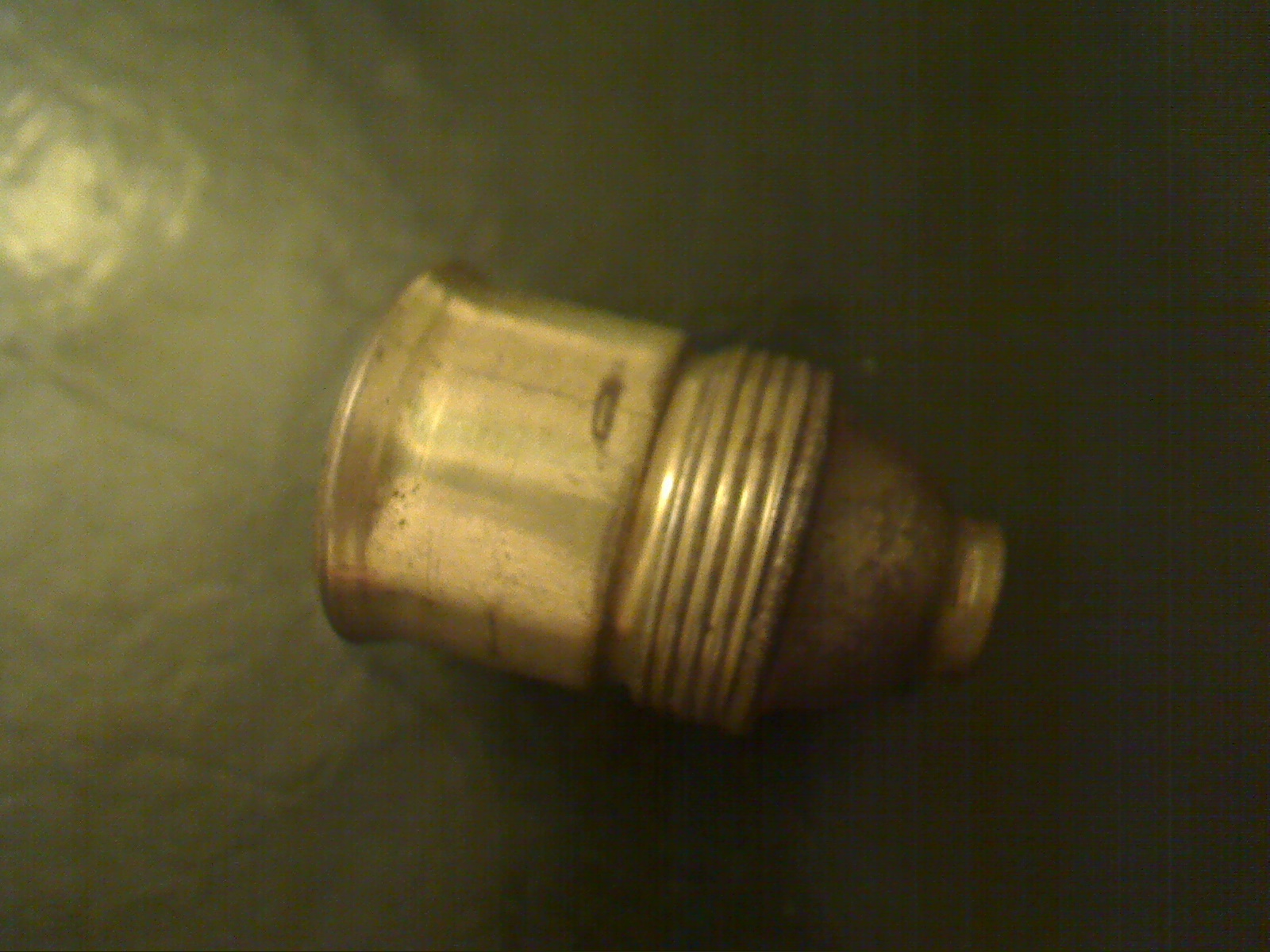

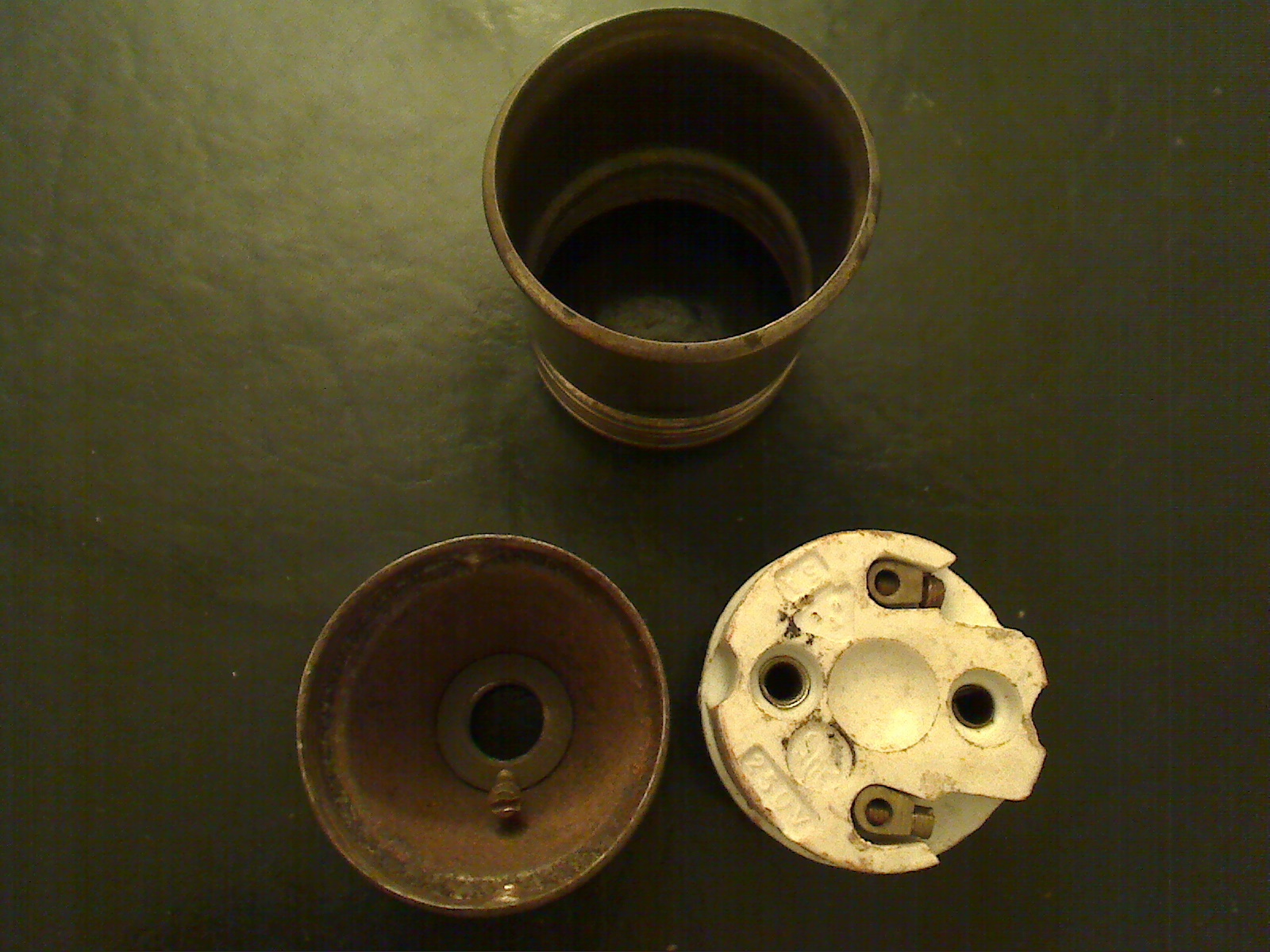

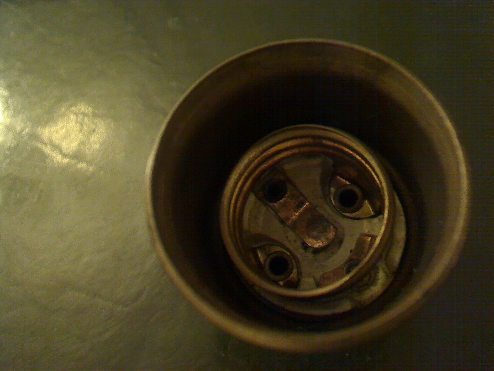

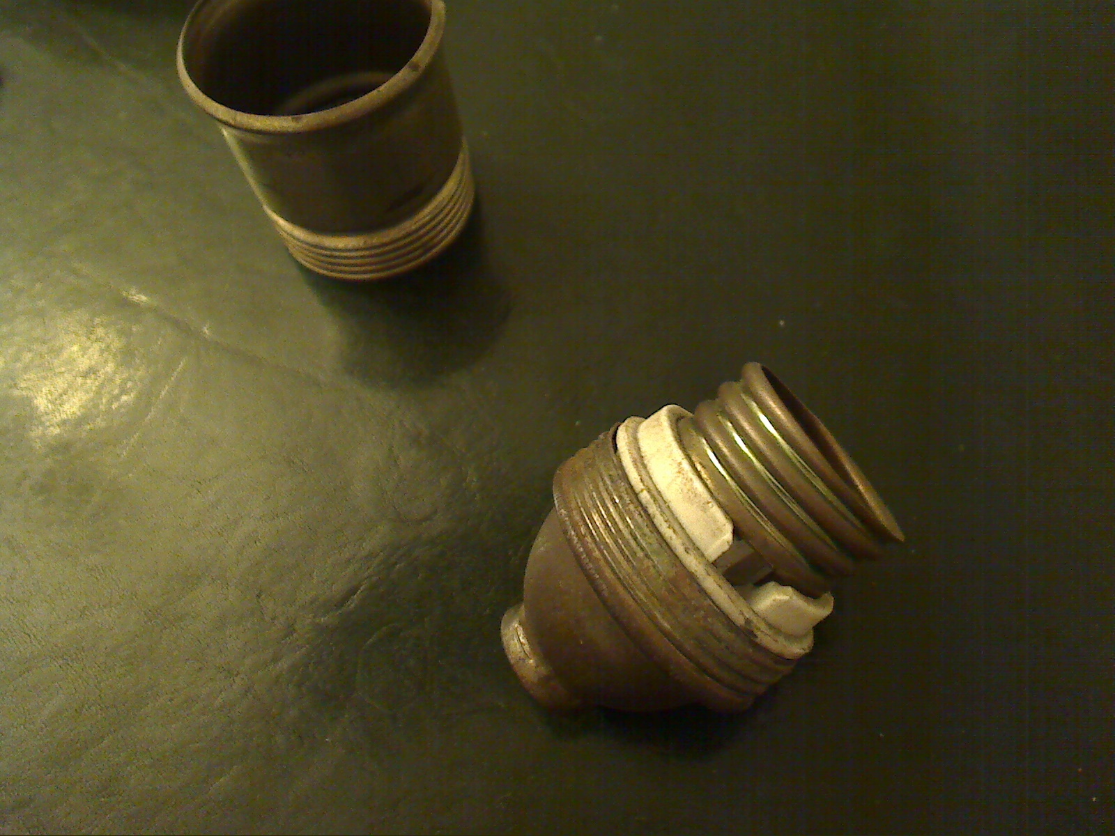

    You mentioned the frame, I took pictures, they are attached. Maybe it will allow a better assessment.

    elpapiotr
    Electrician specialist
    Posts: 12213
    Help: 1015
    Rate: 3535
    Historical beauties.
    Can not be ripped off !
    But it will not put a protective conductor into the holder anyway, because there is nothing to connect to.
    Additional sleeves are required for the stranded wires of the 3-wire cable, if applicable.

    #11 12777243
    MaleLampy
    Posts: 11
    Rate: 9
    It is difficult for me to judge whether the Lord is joking or serious ;-) with historical beauty because I have no knowledge about it. It seems to me, however, that the lampholder is much younger than the entire lamp, because when I look at the holders of the pendant lamp (the latter) from my grandmother, where everything is original, the whole fitting looks completely different and is made of the same metals as the lamp .
