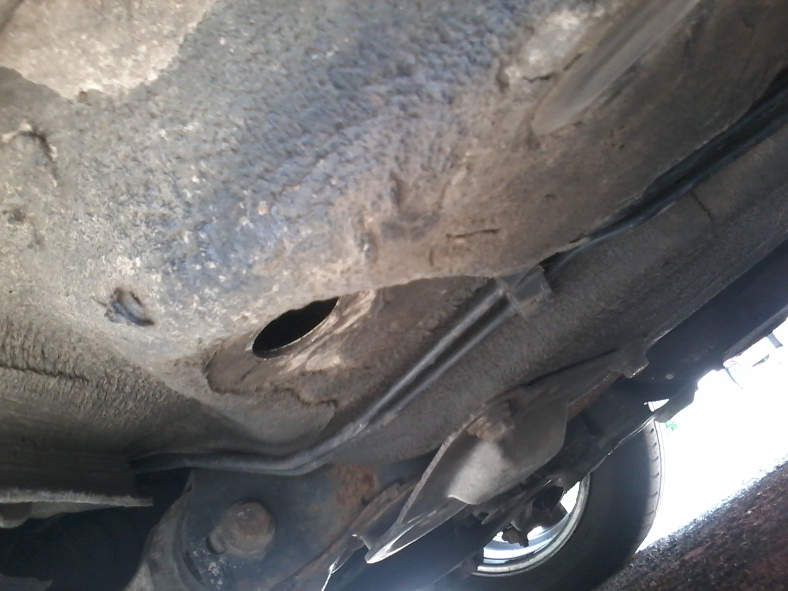

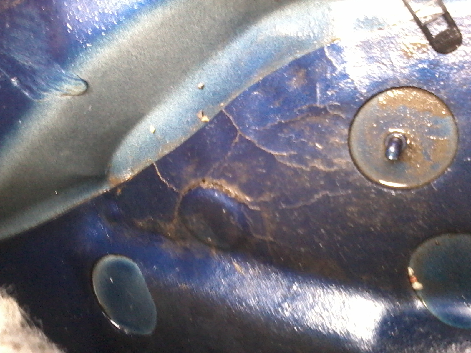

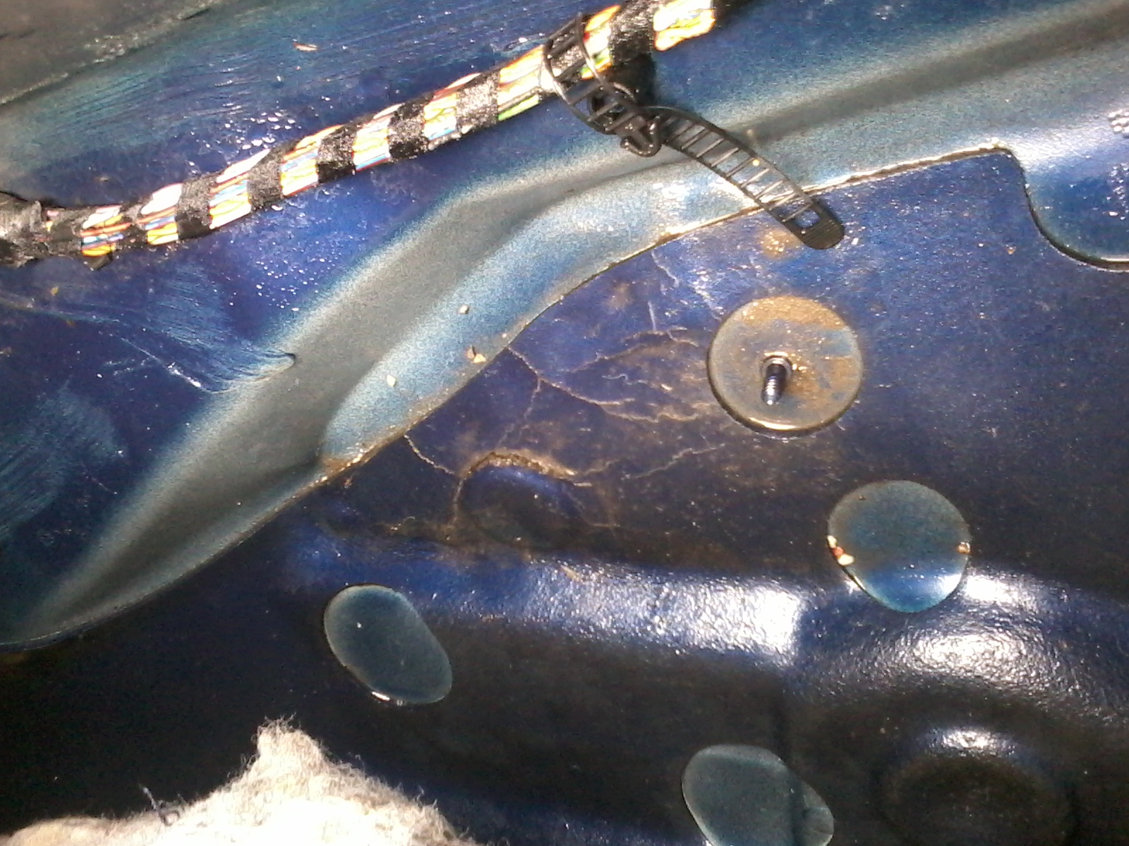

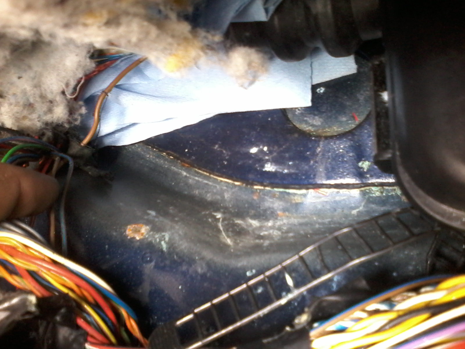

    Hello, I have the same problem and I think I found the reason - the chassis.
    Moisture is felt in the middle of the rugs, but when we open them, we see a "deluge".
    I post some photos:
    1999 VW Passat B5 – water under passenger footwell, where is the leak? 1999 VW Passat B5 – water under passenger footwell, where is the leak? 1999 VW Passat B5 – water under passenger footwell, where is the leak? 1999 VW Passat B5 – water under passenger footwell, where is the leak? 1999 VW Passat B5 – water under passenger footwell, where is the leak? 1999 VW Passat B5 – water under passenger footwell, where is the leak?
    The first two show the absence of a "gasket" on the driver's side which would indicate where water is entering. The next two are from the driver and the last from the passenger.
    You can clearly see that the sheet lined under the lining has gone away and that is where the water is getting in. The passenger is the same, but the seals (already rotten) are in place.
    I wonder what to do with it.
  • #35 12513304
    sen5i
    Posts: 311
    Rate: 30
    It's not the floor though. It's dripping down the cables somewhere. The computer is also sealed and I no longer have an idea.
