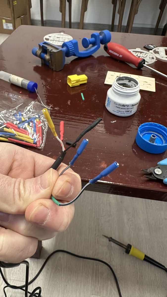

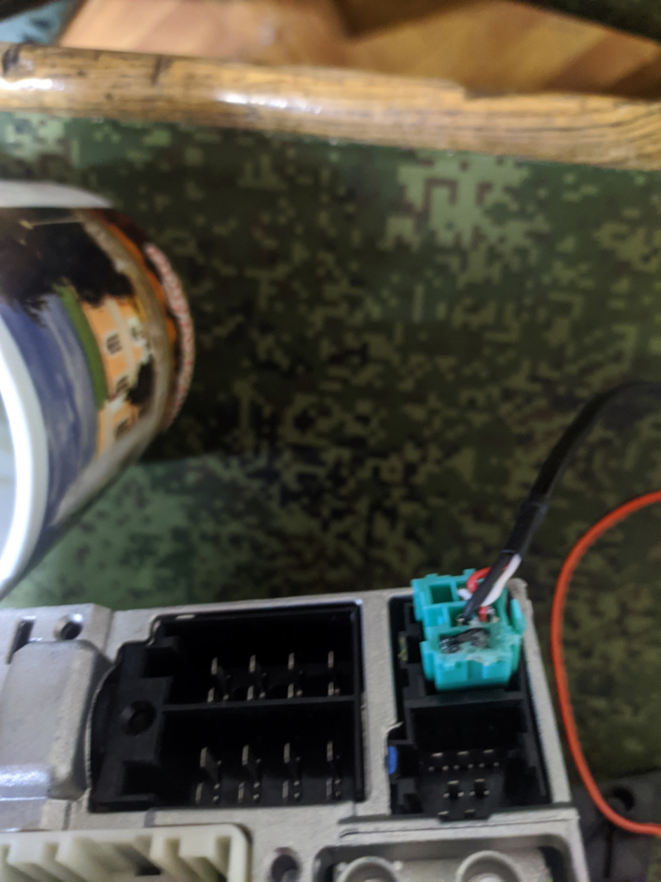

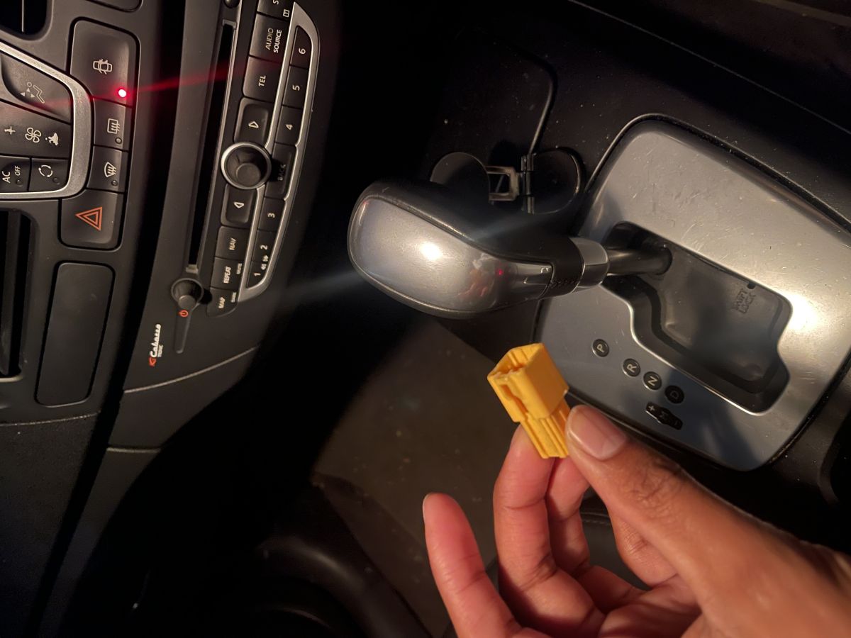

  • AUX activation by wiring a new mini ISO plug
    #11 19754842
    grabiasek
    It's time to dig up the topic, Lord tomato999
    So far I am a happy owner of Laguna III, BT0H, 2.0 T 170KM, Radio TYPE: RAD02 , Navigation system level: NINAV6 , Vintage car 03.2008
    The main guest, that is: Radio Carminat Cabasse Tronic
    1: https://obrazki.elektroda.pl/5768834200_1639104842.jpg
    2: https://obrazki.elektroda.pl/6311704500_1639102129.jpg
    First of all, like the above-mentioned colleague, I have a radio in which there was no aux, and the aux mode could not be turned on from the EXPERT Menu (because it is not there), and you could only turn on the CLIP.
    Secondly, the subject of the yellow mini ISO cube [C1] was on the agenda. Well, a friend's plug on the radio, as in mine, is not plugged directly into the radio, but through ... I don't know what to call it - distance? In any case, the yellow bone has no electrical connection to the radio.
    3: https://obrazki.elektroda.pl/1558393700_1639105014.jpg
    I was tempted to see what would happen if I stepped on her directly. I did it and the AUX mode appeared on the display,
    and nothing more, silence, or rather the whistle of the engine in the speakers - it cannot be like that.
    I bought a Bluetooth module, but it came with a mini ISO [C2], which I don't even have anywhere to connect to the radio, I recommend buying a C1 plug with pins. This photo shows the factory fitted radio and info about my measurements.
    4: https://obrazki.elektroda.pl/3591515200_1639102918.jpg
    When we have a Bluetooth module and a yellow mini ISO plug [C1], we connect it as follows:
    We take the Bluetooth power supply from the mini ISO [C1] pin 6 ( photo 4 ) (and this is where the usefulness of this factory C1 harness ends), plug the mass into the thick black wire ( photo 4 ).
    The rest is the assembly of a new, own mini ISO bone [C1]
    5: https://obrazki.elektroda.pl/9625524800_1639105888.png
    Pins in the mini ISO [C1]:
    1 empty - no connection to the radio chip, it will show in the next photo ( photo 5 )
    2 ------ bridge with pin 5 ---------
    3 common audio
    4 Right audio
    5 ------ bridge with pin 2 ---------
    6 Left audio
    I hope that someone will find this information useful, because it is my weekly effort of free time, and that I will not be hit by the electrode bastard that "not this topic" or "read the regulations" etc ... I sweat this post with a good heart.
    I wanted well ...

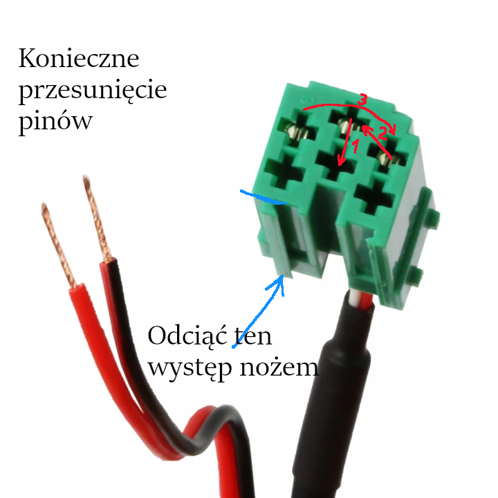

    Activating AUX on Laguna III 2008 Cabasse Tronic Navi with Alpine Changer: How-To
    Since the pinout pattern is different than that used in the CUBASSE TRONIC CARMINAT radio socket, I had to put the pins in the right places (as described in your description) and additionally cut off one of the longitudinal protrusions leading the plug with a wallpaper knife. The method of pin shifting and the place of cutting the leads are shown in the next photo.
    After inserting such a modified plug into the radio in place of the yellow one (and of course activating the AUX input), the module works properly and you can play music from the phone.
    In addition, the BT telephone connection still works (it was already working before the conversion).
    If someone finds it difficult to extract the pin from the plug and move it to another place, you can purchase a new plug with cables, which can be soldered to the output from the BT module. Such a green plug is available in electronics stores
    under the name ZRS-ISO-3-Z (green) for a dozen or so PLN. However, you still need to cut the corresponding protrusion with a knife.
    The issue of connecting the power supply of the BT module is probably obvious, so I do not mention it.

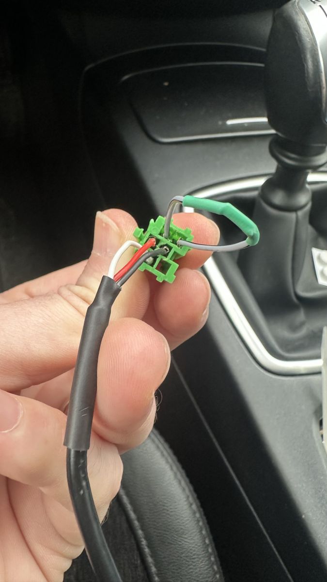

  • Need for bridged pins 2 and 5 in AUX connector

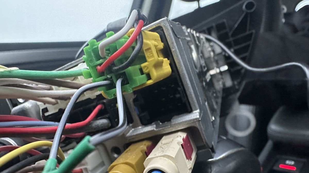

    #19 21369078
    emaildanielcovaci
    Level 4  
    adytt2000 wrote:
    This is such detailed and great information I have found right here and I'm really grateful as I also own a Renault Laguna 3 with Cabase Tronic Navigation and bluetooth that only work as a handsfree and is not able to play music from my smartphone.
    I will use the information posted here in order to fit a new aftermarket bluetooth module just as eLolek used in order to be able to also play music from my smartphone, so please let me know if I understood the information posted here correctly:
    1 - Activate the AUX function by using Clip or DDT4all
    2 - Modify the green connector of the new bluetooth module by shifting the pins according to the schematics provided here - only 3 pins are used GND, LEFT, RIGHT
    3 - Insert the green connector in place of the yellow one on the back of the Cabase Tronic Navigation player
    4- Power the new bluetooth module as described in upper posts from the black thick wire for minus - and the positive 12V white wire from the yellow mini iso harness that will no longer be connected to the player.
    Still I have 1 question I need and answer before I proceed in order to be sure I understood properly.
    - When modifying the green connector is there a need for inserting 2 more additional pins that needs to be bridged as for connecting to the pins 2 and 5 described in photo nr 5 https://obrazki.elektroda.pl/9625524800_1639105888.png or there is no need for such thing and everything works just fine as long as you have the AUX function activated by CLIP or DDT4All.
    -I ask this because on other forum there is something similar posted but it looks like there are 2 additional pins added inside the green connector that are bridged together. They also say that there is no need for activation via Clip or DDT4all as the aux function appears by itself in the menu as you plug in the green connector. Could that bridge between pins 2 and 5 inserted in the green connector be the reason for the AUX function activating itself and appearing inside the menu. Kindly see the picture attached below.
    I did exactly like in your photo and no aux menu showed 😢
    Close-up of a car's electrical wiring with a green and yellow connector inside the vehicle. The image shows a hand holding a plug with wires in a car.

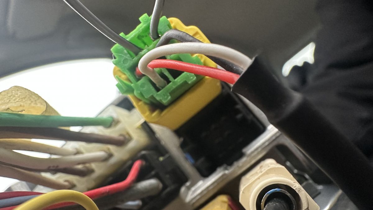

  • #20 21370117
    emaildanielcovaci
    Level 4  
    After a sleep off I made a new configuration
    But still no success 🤯 Close-up of connectors and wires inside a car.
  • #21 21370123
    albinjoseph
    Hi
    you need to remove that yellow connector out of the unit and plug the bluetooth directly to the unit. It will work.
    Hand holding a yellow connector in front of a car console with gear shifter and control panels.
  • #22 21370140
    emaildanielcovaci
    Level 4  
    albinjoseph wrote:
    Hi
    after a cup of coffee I saw that
    now I have another problem, my connector is no good, it does not fit there
  • #23 21370154
    albinjoseph
    I have pointed two sliding grooves with green arrow in the image. You need to cut off those grooves using a knife. Then it will fit.
    Green arrows indicate grooves to be cut on a green wire connector.
  • #24 21370174
    emaildanielcovaci
    Level 4  
    I have done a more direct approach 😂 and yes now it works 🕺🏼🕺🏼🕺🏼
    The aux is there
    10q guys, have a great year 🙏
    Car seat with tools, a phone, and instructions. Person holding a set of wires with colorful insulation against a table with electrical tools.

How can I fit a green plug that does not physically match the radio?
Trim the two lateral guide ribs with a craft knife, then push the modified plug directly into the radio after removing the yellow spacer block [Elektroda, albinjoseph, post #21370154]
What should I do if AUX still does not appear after bridging?
Clean contacts and confirm both bridge pins touch radio sockets. If still absent, perform CLIP activation—some late-2008 units need the software flag despite the bridge [Elektroda, emaildanielcovaci, post #21370117]
Dealer activation vs. DIY bridge—which is quicker?
Dealer CLIP session averages €20 and under 10 minutes [Service Pricelist, 2023]. The bridge method takes about 5 minutes at zero cost but requires crimp terminals.
3-step How-To: Bridging pins 2 & 5
  1. Remove the yellow spacer and extract the C1 plug.
  2. Insert two spare terminals into positions 2 and 5, then crimp them together.
  3. Refit the plug directly into the radio; AUX appears on display.
