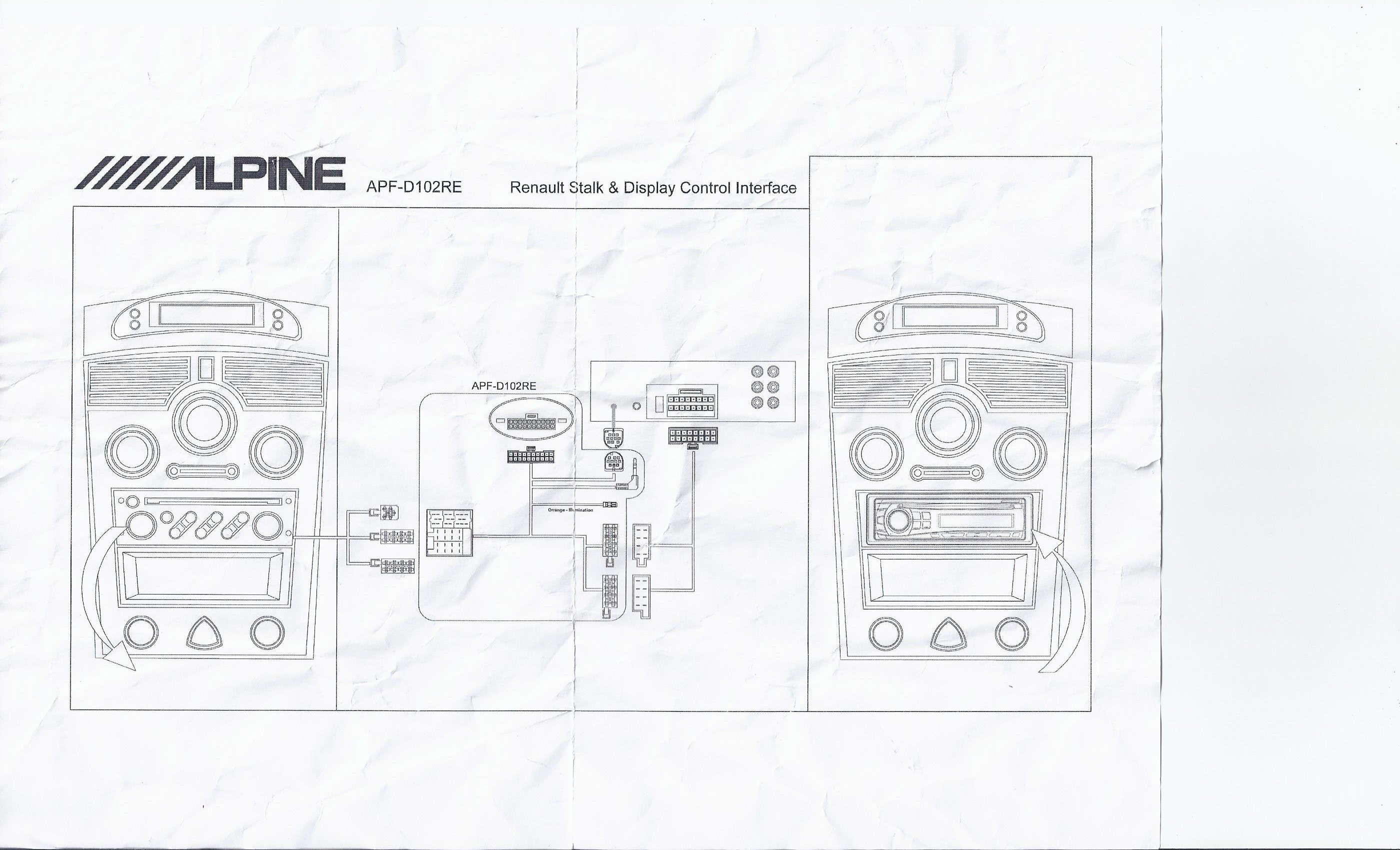

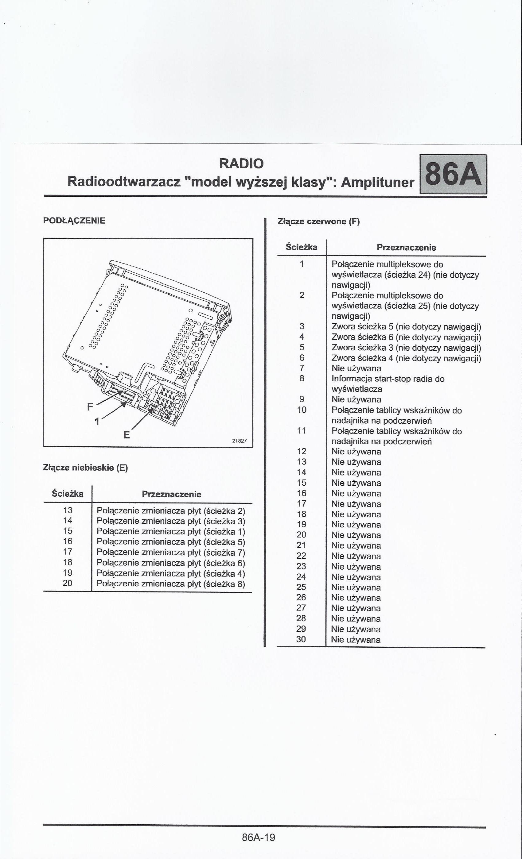

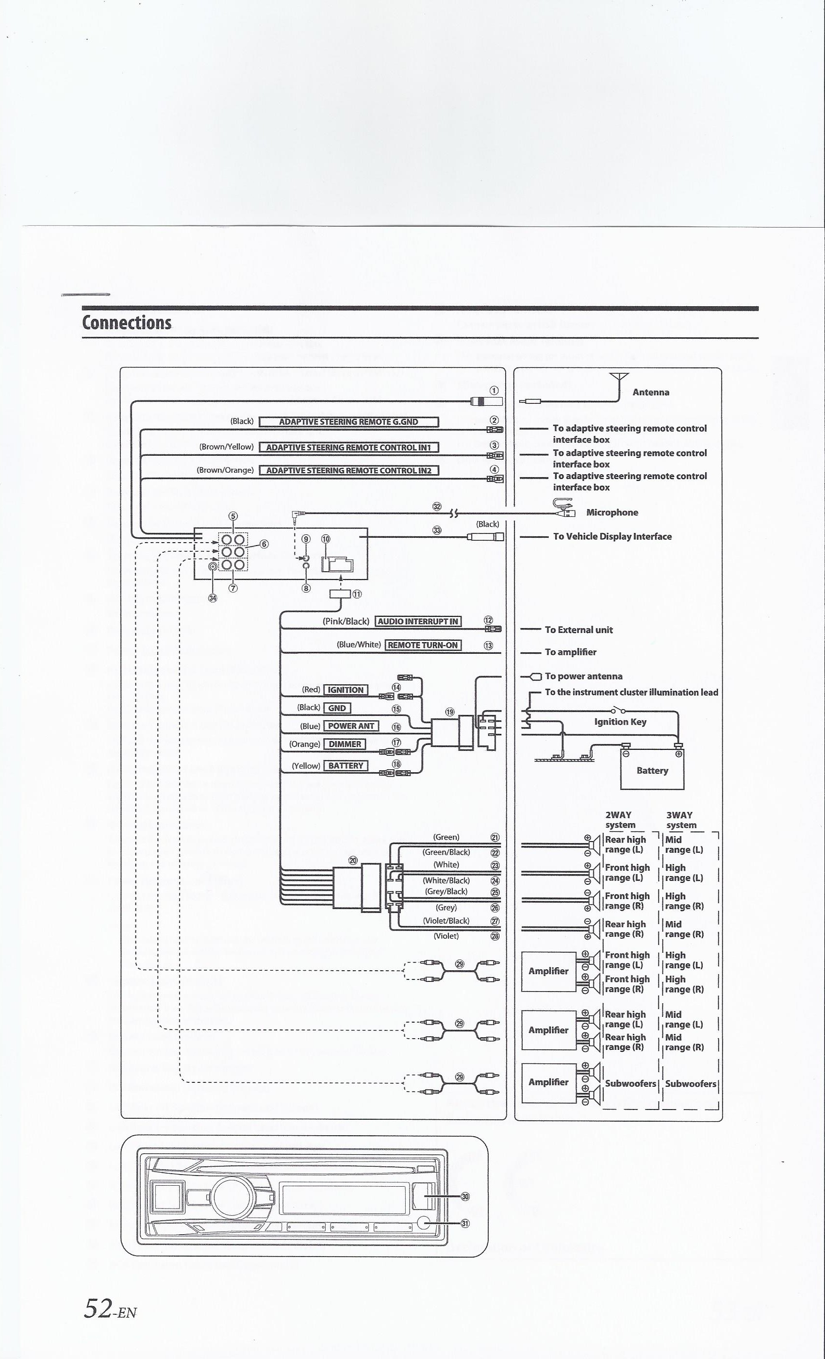

    I am writing to you asking for help with connecting the radio with the steering wheel control interface and operating the display in the dashboard.
    My vehicle is Renault Espace 4 JK 2004.
    The original radio is located at the rear of the storage compartment on the left (RENRAT120-52).
    The new radio that I intend to install is:
    Alpine CDE-196DAB
    The interface (which was supposed to work) is:
    Alpine APF-D101RE (if needed, I can take a picture of the center)
    The problem is that after connecting the radio plays but the control and display in the car does not work.
    On Internet, apparently people managed to connect, but probably in younger cars after 2006.

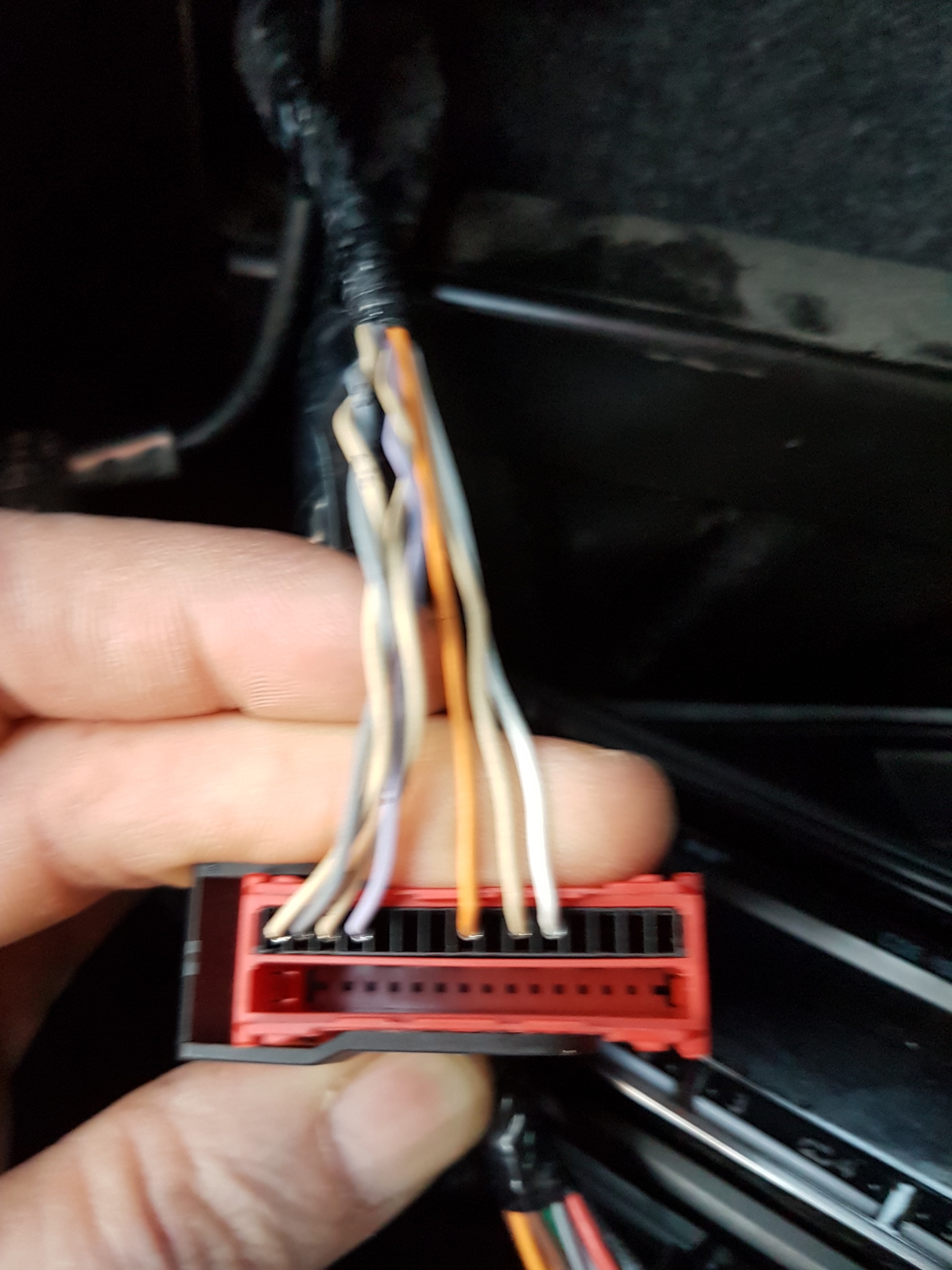

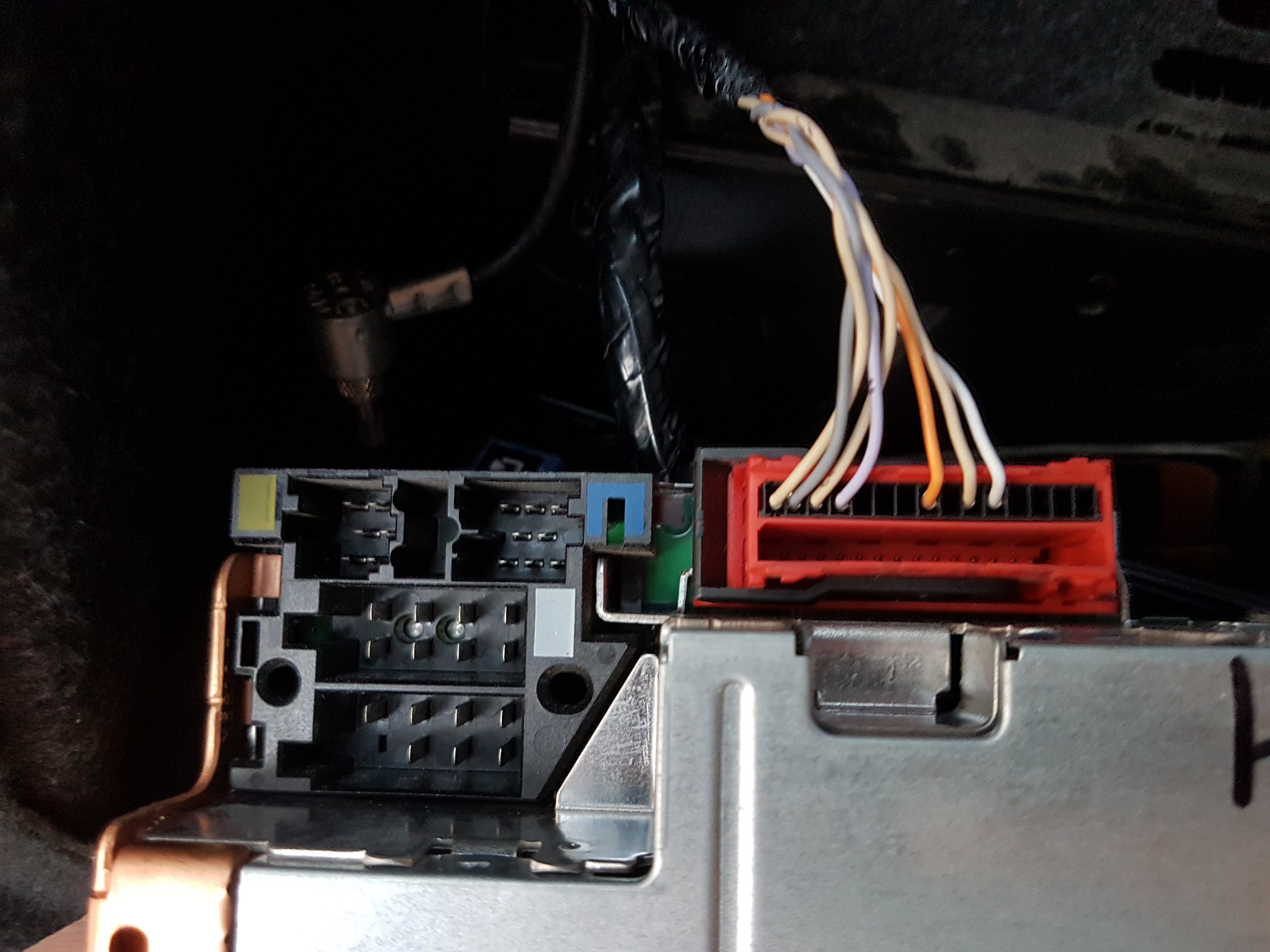

    I noticed that I do not have a yellow mini Iso in the car installation,
    and in the old radio the control and display is connected through this red rectangular socket on the radio, I'm not mistaken 30 pin of which only 7 is used.
    If it is possible to connect, please explain it step by step.
    Below I attach pictures of connections.
    Thanks in advance for the hints.

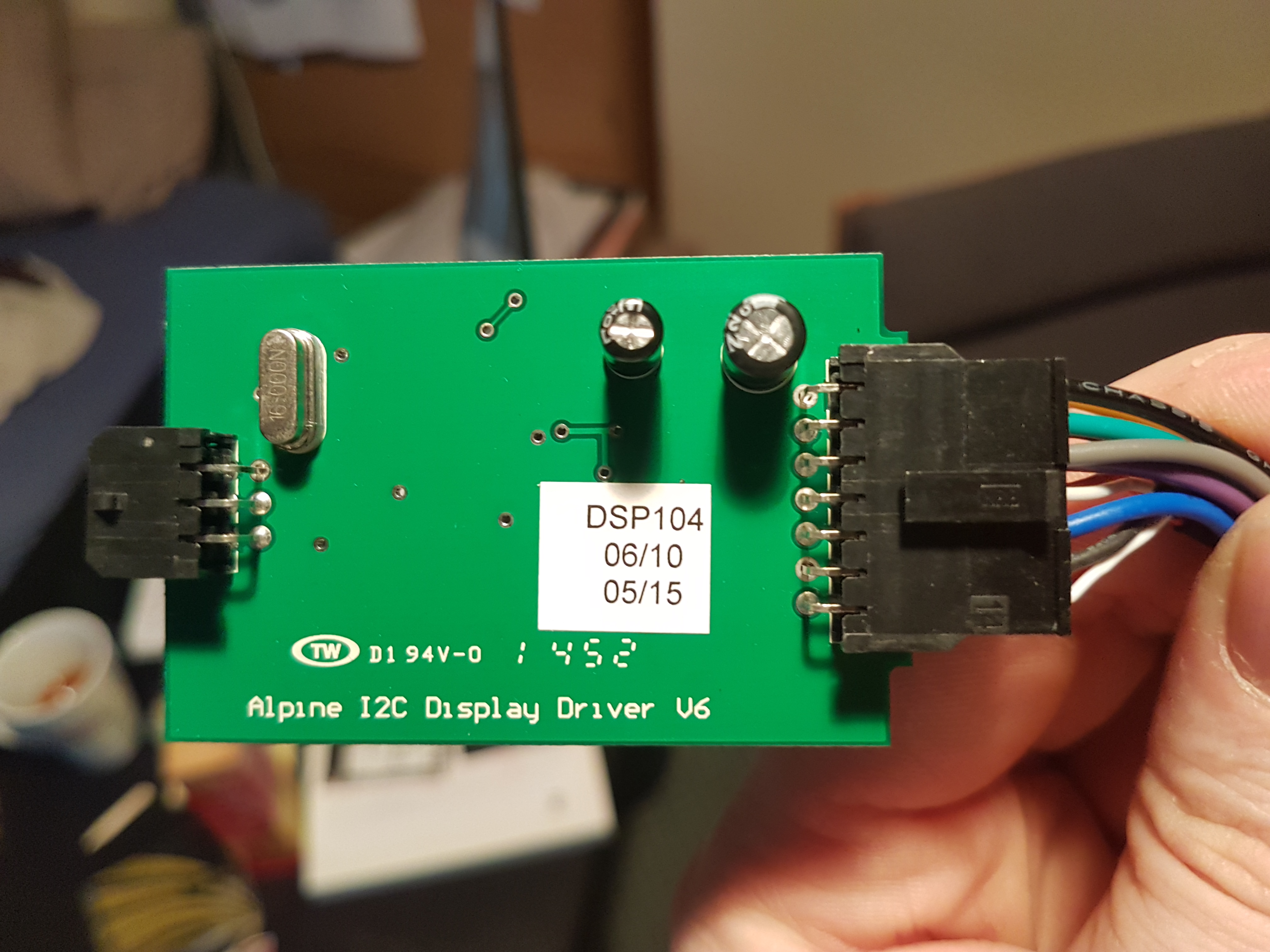

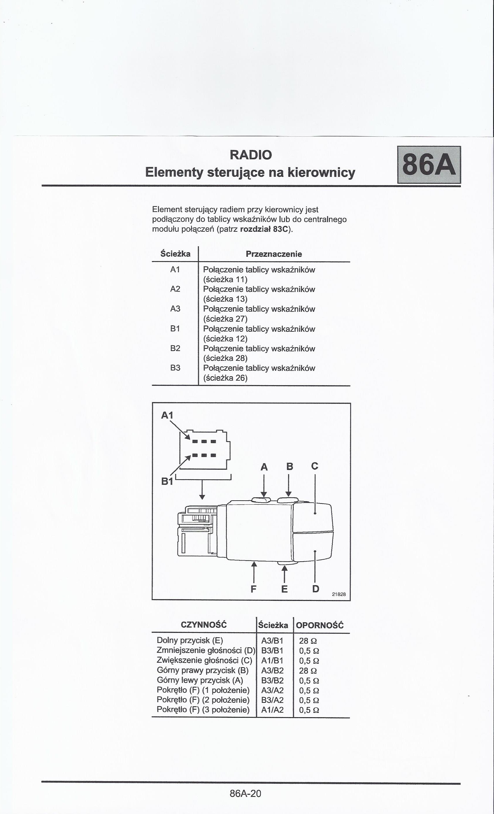

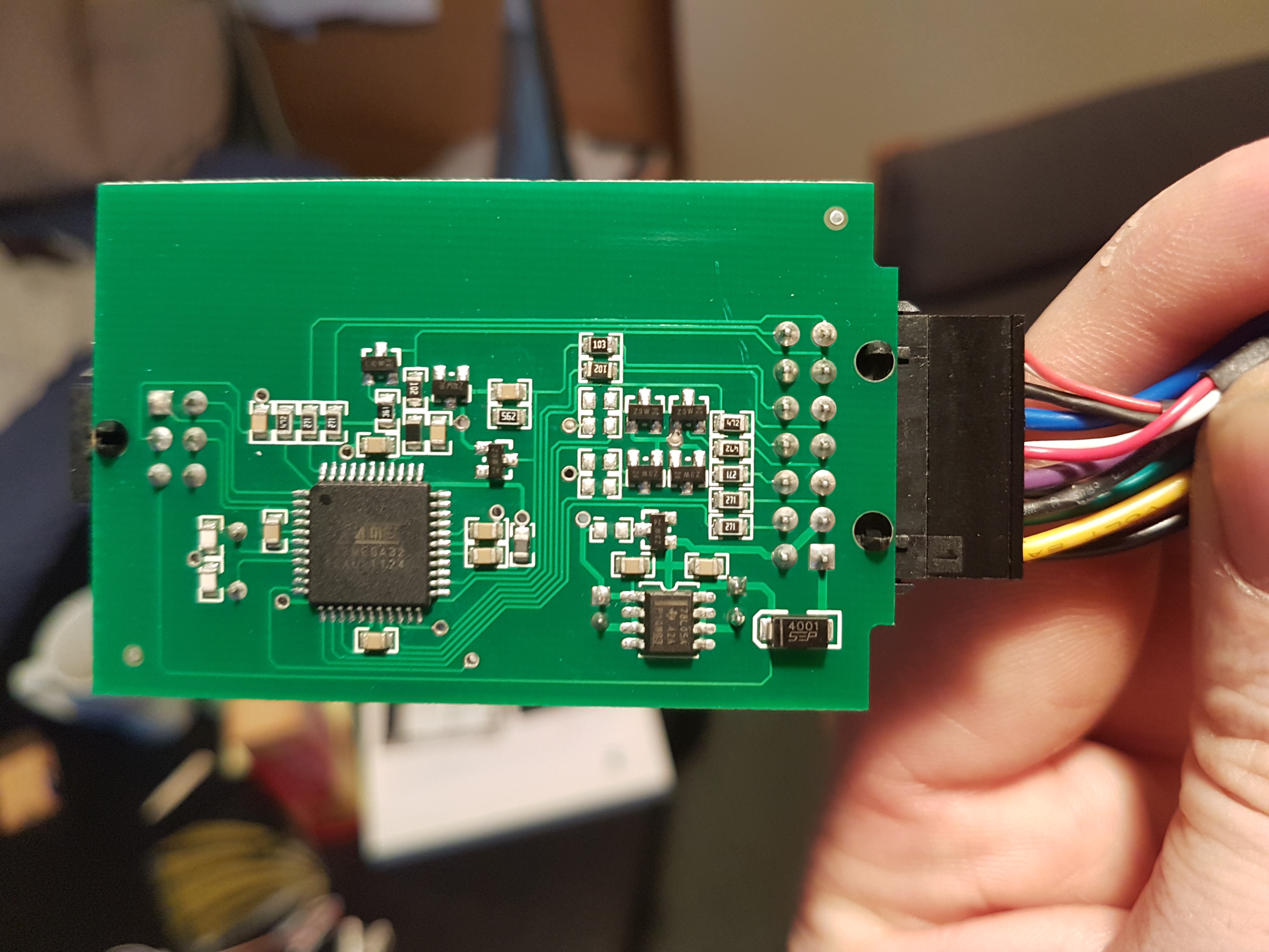

    I also attach photos of the mini iso cube + cable description, interface board and all the information I collected.
    I hope they will be helpful.
    (scan0001 shows the APF-D102RE interface that I also have, and both had the same instructions)
    Thanks again.
