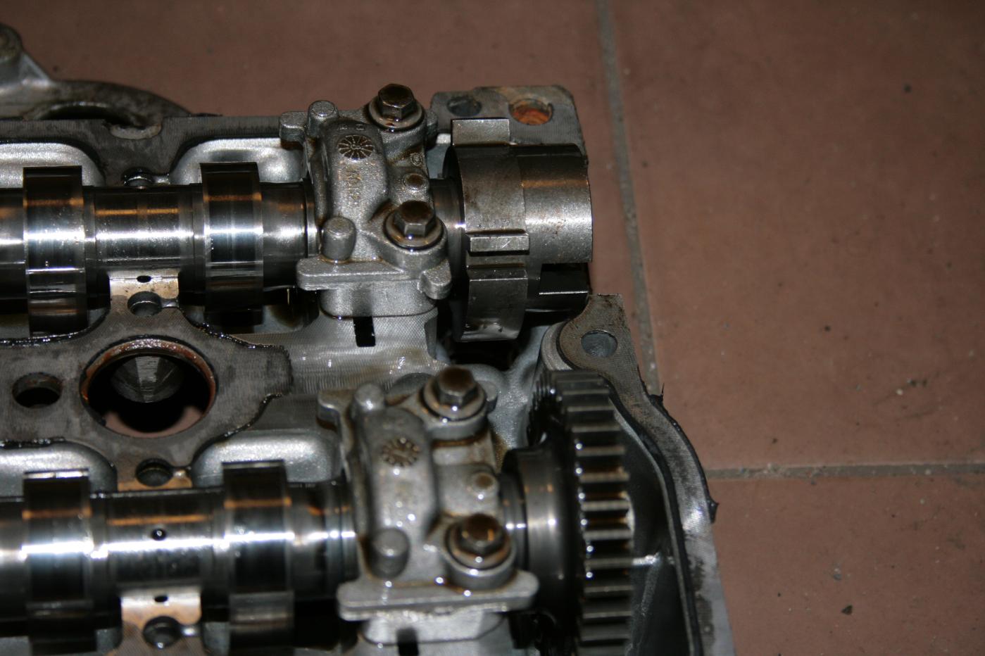

  • #37 10598624
    kozik3
    Posts: 228
    Help: 10
    Rate: 75
    Hello. Topic solved :D The car burns on the arrow and the shaft error is gone. It turned out that the engine that was inserted was M9R A 802, and the one that should be M9R A 700. The engines differ in one camshaft - the one that has a spline at the end from which the sensor reads impulses. In the A802 engine, the shaft has several splines, and I should only have one spline. I changed the shaft and now it's ok. I am attaching photos - maybe someday they will be useful to someone.
    Camshaft Sensor Error DF119 in Megane II, 2.0 dci 150KM 2006: Diagnostic & Possible Solutions Camshaft Sensor Error DF119 in Megane II, 2.0 dci 150KM 2006: Diagnostic & Possible Solutions
    Many thanks to everyone who took part in the topic and special thanks to Karol, who sent me this idea via e-mail. THANK YOU
