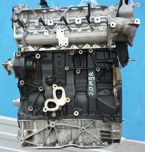

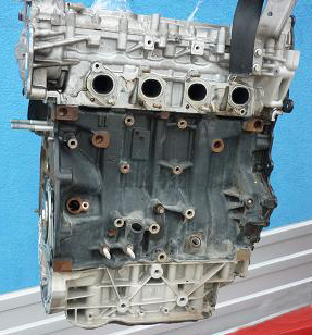

    engine front:
    Camshaft Sensor Error DF119 in Megane II, 2.0 dci 150KM 2006: Diagnostic & Possible Solutions
    engine rear:
    If anyone could point out where the shaft lock is screwed in, I'd be grateful.

  • #21 10569089
    kozik3
    Posts: 228
    Help: 10
    Rate: 75
    Hello. Today I went to work. I attach a photo where the connecting rod lock is located in the M9R 700 engine (maybe it will be useful to someone) - it is next to the air conditioning compressor:
    Camshaft Sensor Error DF119 in Megane II, 2.0 dci 150KM 2006: Diagnostic & Possible Solutions Camshaft Sensor Error DF119 in Megane II, 2.0 dci 150KM 2006: Diagnostic & Possible Solutions
    I set the connecting rod so that the marks more or less match, I screwed in the connecting rod lock, the connecting rod resting on the lock and the upper roller lock cannot be inserted (it does not fit perfectly on both rollers), i.e. the timing is shifted. However, I have a question about the short chain, in my case it is quite loose (it can be bent about 1-1.5 cm) I attach photos:
    Is it normal ? Could it be that the chain is stretched? And please pay attention to the gear wheel from the pump - is it not worn too much?
    And one more question - is the oil pump also adjusted? Is it irrelevant and I tighten the pulley without knowing how the oil pump is set?
