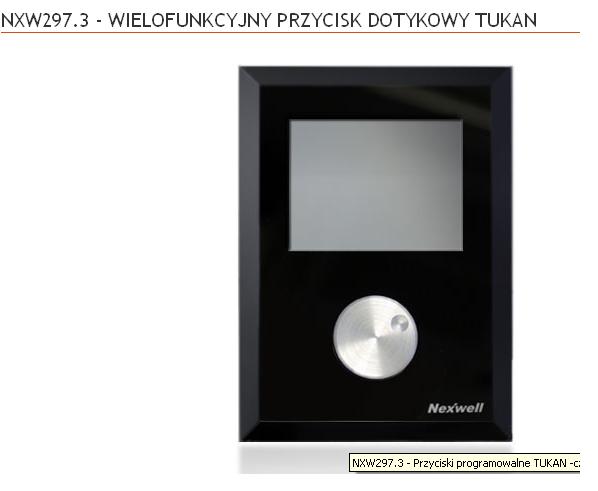

    As for the switches you’ve shown, our own Polish company offers devices that are two or three times cheaper; they don’t currently control audio systems, but it’s only a matter of time.

  • Nexwell modules lack the claimed programmable button feature

    The thread hasn’t been split off yet, but since you’ve continued it, I’ll reply here. You wanted to show off with the IR remote modules in Nexo, but you’ve failed again.
    Have another read on how these modules work in the Nexwell system, then go back to my reply about the programmable switches/buttons, and you’ll realise that this feature hasn’t yet been implemented in the device I’m describing.
    The prices aren’t just plucked out of thin air, mate; they should be available to the general public before long.

  • Ceiling metal module controls AV equipment

    So is it this module that controls the AV system, or is it that bit of metal sticking out of the ceiling?
    Yes, that ‘piece of metal’ sticking out of the ceiling controls the AV equipment, but that ‘piece of glass’ I mentioned doesn’t yet.
    Really? Very interesting. So how much does a Nexwell distribution board actually cost? As usual, it’s been top secret for the past six years.
    Anyway, it doesn’t change anything.
    I don’t know, I don’t use their switchboards – wouldn’t it be better to give them a ring? Or do they not like you there either?
