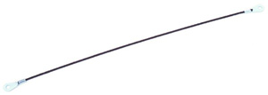

  • #10 1094029
    elektronik8
    Level 19  
    Posts: 415
    Help: 19
    Rate: 77
    It seems to me that it is like a tile saw blade, it is round and has such roughness and mo noun on it and ik at cut out

    #11 1094087
    Błażej
    Posts: 23620
    Help: 1923
    Rate: 3627
    The one in the photo is actually the glaze saw blade. It clogs fairly quickly when cutting plastic. The balls I mentioned look as if a twisted trichinosis ball is tightly twisted into the wood. Such "barbed wire in miniature". You can buy castorams and others of this type in packs of 10. They are even of different thickness. Unfortunately, it is not a drill attachment, but a hand tool. It is a delicate ball with a short blade with a very high handle that allows the ball to be maneuvered in any direction.
