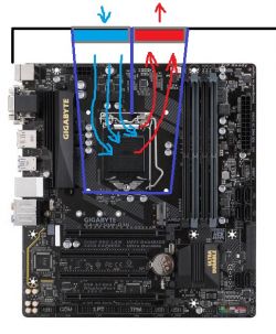

    Another thing: cooling
    I'm going to do something like this:
    DIY Lightweight PC Case: Choosing Putty & Paint for 100% Plastic Housing, Resin Canvas, & 2mm Gaps
    Made of canvas and resin as a tunnel cover for the CPU and heat sink.
    Two fans are mounted on the wall of the housing (one draws in cold air from the outside and the other pushes out warm air).
    Something like this will pass ??

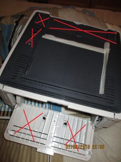

    I would already take the first photos of the new housing :-) but during the work I realized that it was still too high and I took it apart again for cutting for tomorrow. At the moment it is 17cm but it will be 13cm. 1x 5.25, 3x 3.5, matx and a specific power supply (without housing) will easily fit there.
    At the moment it looks tragic because I'm making what I have, but ...
    Top from the printer, sides from another, front from the scanner, back from another printer :-)
    Today, the design has also changed. I decided to fit the front to this housing from the back of the printer. The flap that opens looks cool and all those ventilation grilles. I started to play with the front panel and it was a massacre. I need a lot of ports on the front (card reader, usb3.1, mic, audio, sata power, sata plugs on extensions, BR drive ... and when I put it together, it was a tragedy, so there will be a flap and all that in.
    DIY Lightweight PC Case: Choosing Putty & Paint for 100% Plastic Housing, Resin Canvas, & 2mm Gaps DIY Lightweight PC Case: Choosing Putty & Paint for 100% Plastic Housing, Resin Canvas, & 2mm Gaps DIY Lightweight PC Case: Choosing Putty & Paint for 100% Plastic Housing, Resin Canvas, & 2mm Gaps
    Everything that is marked in red will disappear and on the front there will be a panel with HDD / PWR LEDs and PWR buttons (and a reset and Bios reset behind the flap). I am also thinking about fitting the display:

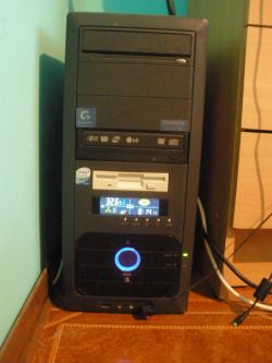

    This is my case from 9 years ago and the display differs from this:
    the fact that it has something that the latter lacks, i.e. a battery that supports an hour, and it is in color. The time is displayed even when the PC is disconnected from the socket and the screen is then in negative.
    The entire housing without the base currently weighs 390 grams. The result I expected. In the power supply section, there will also be a surge protector inside the housing, and on the back of the housing there will be a possibility to connect 2.3 devices (monitor, printer).
