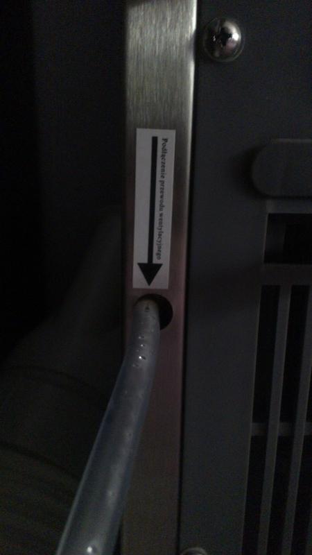

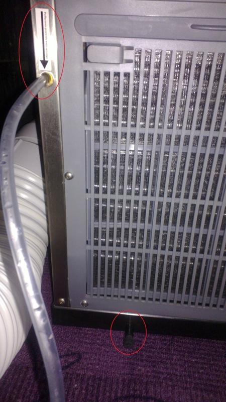

    Hello, I have a question, I bought a ladycook lpc-sp09 portable air conditioner, but I have a question because it is not clear in the instructions on the back of the device, there are two holes, one somewhere 30cm from the ground with the inscription "connection of the ventilation duct" and the other at the very bottom with a rubber stopper. And now it kind of has a container for condensed water but I don't understand how to remove it. Do you put the attached hose where the inscription or put something under the device and remove the plug? And what does it mean continuous or non-drainage of water? and is it normal that after 3 hours of work it has about 1 liter of accumulated water?

    Misiek85 wrote:
    ... is it normal that after 3 hours of work it has about 1 liter of accumulated water?
    It depends on many factors (humidity, air flow, temperature difference, etc.), but it is possible (larger devices can give a bucket of 15 liters per hour :D )

    I understand, thank you for the explanation. But how to remove this water? Why this hole with the inscription ventilation duct when it is placed about 30 cm from the ground? Now I manage to put the bowl under the bowl and wait for it to fly out. What does water drainage mean?

    fan duct it's probably a warm air discharge (i.e. a pipe and out of the window - that's what most people do).

    In the back you have a flap and a condensate tank under it and you should empty it, and if you have the opportunity to drain it, for example, to the sewage system, then you pull out the rubber plug, connect the pipe and to the sewage system.

    Hello, ok, I can attach a photo of what I mean.

    Probably tank vent.

    Well, maybe so, but why this inscription?
