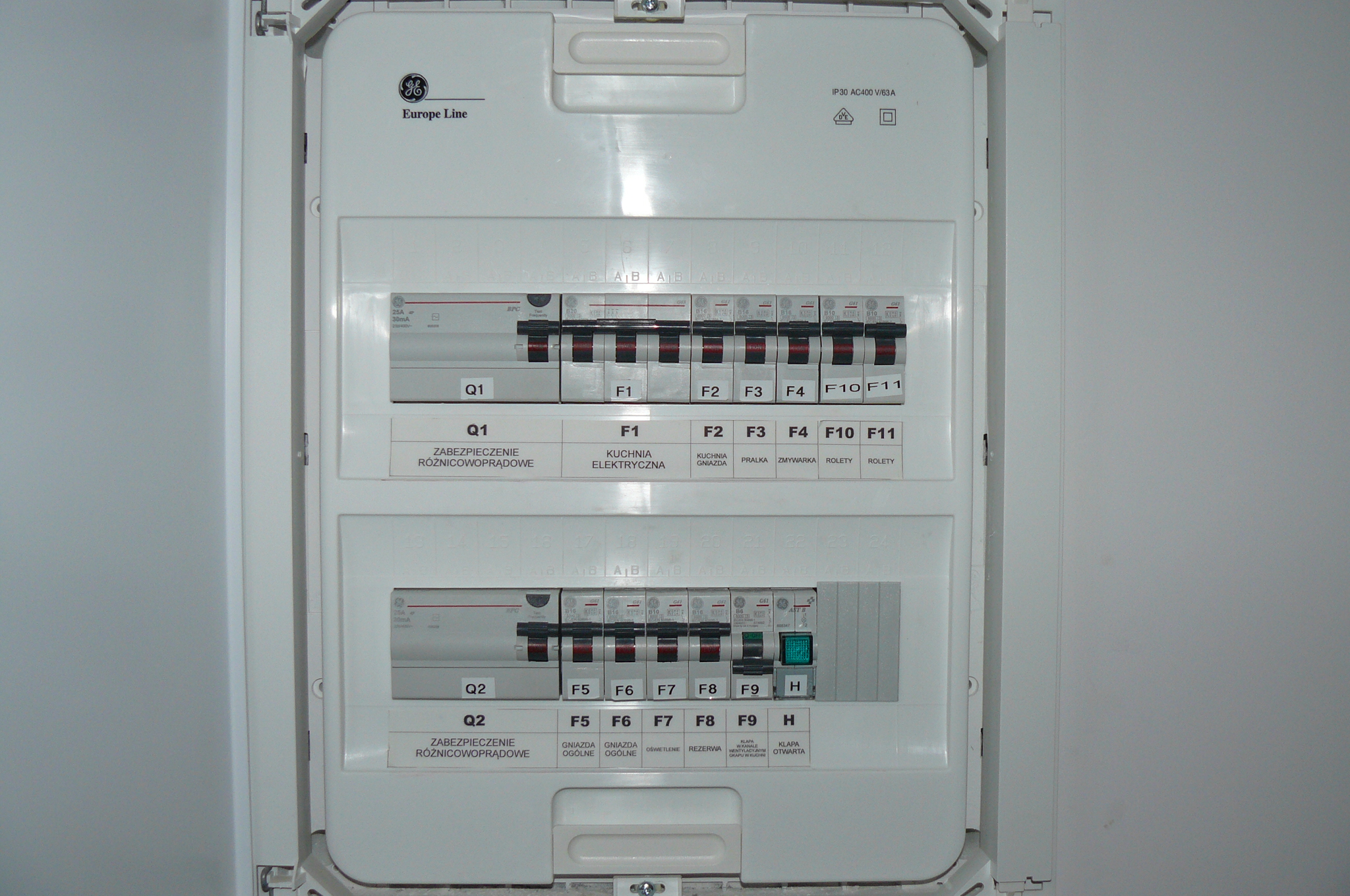

    I have a little problem:
    Well, I bought an apartment, there are 3 phases in the apartment - connection power 12.5 kW.
    I don't live there yet - I'm in the renovation phase.
    Last week I had a 3.5 kW air conditioner installed, and this is where the problem arises. When I turn it on, a slight squeak comes out of the fuse box, a high-pitched sound. He's not very loud, but from what he knows, it shouldn't be. When turned off, there is blissful silence...
    Does anyone of you have an idea how to solve this?

    I finally managed to write something, I just didn't know that there were requirements such as correct spelling, but to the point, the fuses squealed so squeaked, in response to earlier questions, squeaking, or what my wife called "sizzling '' starts about 2 minutes after turning on the air conditioner.
    And here is a photo of this invention, I circled the place from which this noise is probably coming from, the ear method :)
    Didn't I say in post #8?

    The B16 circuit breaker with a load of 3.5kW works almost at the edge of endurance, writing in a colloquial language. You can try to replace it with another one, from a different company, e.g. EATON.
    Switchgear made cheaply, with incorrect denomination of lighting protection. Scandalously small number of circuits for the current times. Such "expanded" installations were made in the early 90s.
    Somehow I do not see a separate circuit for the air conditioner or it is common with something or the cost of something.
    As far as I can see:
    1. 400V plate,
    2. Kitchen outlets?
    3. Bathroom outlets?
    4. Sockets rooms?
    5. Lighting and bell?
    Where are the circuits dedicated to loads above 2kW, such as a washing machine, dishwasher, oven (if separate) and air conditioner?
    There is no main switch in the switchgear, and the four-pole RCD looks as if it is going somewhere. General disorder, lack of comb rails, phase on the blue wire from the bell. N-controlled bell.
    No room for possible expansion.
    Who did the "electricity" for you?

    So in order for it to have at least some arms and legs it's a decent electrician and to change pretty much everything????
    And instead of these B16s can some more powerful ones be fitted???? The air conditioner is connected to the socket simply....
    And what happens if I switch on, a 7.2 kW induction????? Will it work???? 3 phase of course.

    So if I have an air conditioner on, and I turn on, for example, something else in the same circuit, let's say it comes out 5kW, 3.5kW from the air conditioner and plus something else there, what then? Will the overcurrent circuit breakers switch off? Even if I replace them with those made by Eaton, as my colleague wrote?
    And do I replace everything in this box with this Eaton????

    Following this line of thinking, you'll blow the installation in your apartment.... probably 1.5mm² B16 protection and about 3.7kW on the circuit....
    The only sensible solution is to run a separate circuit to the air conditioner, protected as recommended by the appliance manufacturer.

    A separate circuit with separate protection should be connected to the air conditioner.
    The protection of the lighting circuits must also be replaced (use B10).
    It is worth bringing at least one additional circuit for the dishwasher to the kitchen.
    I do not want to comment on the LVS modular equipment, because I have never dealt with it.
    In your place, while you still have the opportunity, I would throw out the current switchgear and put in at least 2x18.
    Then the main switch, voltage presence indicators will fit and there will be a lot of space for connecting new circuits from the air conditioning and dishwasher, and maybe also from the washing machine (if it will be in the kitchen) and the oven (if it is separate). think it over.

The discussion revolves around a high-pitched sound emanating from the fuse box when a 3.5 kW air conditioner is activated in a 12.5 kW apartment. The user, currently in the renovation phase, seeks advice on the issue. Responses suggest potential causes, including the inverter operation of the air conditioner and issues with the switchgear, such as poor filtration or inadequate circuit protection. Recommendations include consulting an electrician, taking photos of the switchgear, and possibly replacing circuit breakers with higher-rated ones, such as B20 or from brands like EATON. The user later identifies the noise source as a faulty device related to the circuit protection, which was resolved by replacing it with a Legrand component.
TL;DR: Within 12.5 kW flats, a 3.5 kW split AC draws 940 W/4.4 A (73% below rating) [Elektroda, maniek998straz, post #15592491] “Culprit was the RCD with the TEST button” [Elektroda, maniek998straz, post #15596884] Swap cheap breaker modules for certified ones to silence squeal.
Why it matters: Persistent squealing signals arcing or vibration that can overheat protective gear and start a fire.
• Apartment supply: 12.5 kW, 3-phase 400 V [Elektroda, maniek998straz, post #15584744] • AC electrical draw: 0.94 kW cool / 1.05 kW heat, 4.4–4.9 A [Elektroda, maniek998straz, post #15592491] • B16 breaker trips in 0.4 s at 48–80 A (curve B) [Elektroda, haneb, post #15592366] • Polish §188.2 requires separate circuits for >2 kW loads [Rozporządzenie MI, 2002] • Branded 2-pole 30 mA RCD ≈ €18–25 (retail 2023)
Why did the fuse box squeal when the air-conditioner ran?
The air-conditioner’s inverter created high-frequency current that made a low-quality residual-current device (RCD) vibrate; replacing that single module stopped the noise [Elektroda, maniek998straz, post #15596884]
Is it dangerous to keep using power while it squeals?
Yes. The sound means internal contacts vibrate or arc, which raises temperature and can weld or burn contacts [NFPA, 2019]. Switch off the circuit and call an electrician.
Which exact part was found faulty in the thread?
A four-pole RCD with a “TEST” button from an economy LVS line caused the squeal [Elektroda, maniek998straz, #15591680; #15596884].
