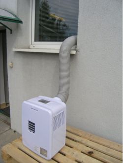

    Ladies and gentlemen,
    I'm going to buy this air conditioner:
    http://www.castorama.pl/produkty/instalacja/w...zenosny-z-grzaniem-blyss-12k-btu.html#product
    I know all the pros and cons of general information on portable air conditioners, but unfortunately I have no other choice. I have a built-in balcony and the community does not issue permits for installation on the facade.
    Coming back to the topic - I need to cool a 12m2 room with a TV and 2 computers. The room connects to the 4m2 kitchen with no door. The room is also connected with a built-up balcony of 2.5 m2. All rooms have windows on the sunny side (the sun is banging on the windows practically from morning to evening), about 8-9 meters in total. Last summer, the minimum temperature in the apartment was 38 degrees ... I could use at least 25 .. Does it make sense to buy this air conditioner? Has anyone used? How's your impressions / opinions? Do you recommend possibly something else up to PLN 1,400?

    There are two options:
    1. Through the window in the room (secured with a collar, or cut white, opaque plexiglass the size of a window with a hole for a pipe).
    2. I will open the windows on the balcony and lead the pipe to the balcony - it can be hot there :)

    Second control question
    Where does the air for cooling the condenser come from?
  • #6 15695948
    Krzysztof Kamienski
    Posts: 21895
    Help: 2033
    Rate: 5167
    Rurom, Lord, Rurom :D :D The corrugated pipe from the kit must lead to the outside.

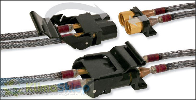

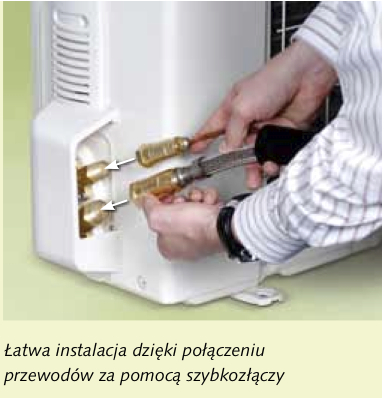

    Does this mean that in air conditioners described as "for self-assembly", this self-assembly is just an advertising gimmick, taking money and shunning the manufacturer's warranty? In such an installation, by definition, there is no vacuum and the probability of an error that invalidates the warranty seems to be high.
  • Self-assembly units use pre-vacuumed quick-coupler lines
    #20 15770775
    mirek301
    Level 20  
    Posts: 418
    Help: 24
    Rate: 52
    And here you are a bit wrong. The air conditioners described in this way have a predetermined pipeline length, i.e. 2, 3, 8 m, and the pipeline has an indoor unit. and external are terminated with "Parker" quick couplers. The vacuum is already made in them (the quick coupler has a valve similar to power hydraulics lines) and after connection it fills the lines with the refrigerant accumulated in the outdoor unit. Such an installation can be moved, etc., without loss of refrigerant and without the need for a vacuum.
    As far as I remember something like that has 'Remko'
    But to have full warranty, inspections by an authorized installer must be entered in the card.

    I have climate Blyss about such a photo borrowed
    Evaluating Blyss 12K BTU Portable Air Conditioner from Castorama for 12m2 Room
    The climate is 3.5kW and works better than it is really loud, but the performance is amazing. After a few minutes, the room (attic) is cooled down to the set temperature, in most cases the climate is set to 22 ° C. Then the unit turns off and the air is spinning ... if the air-conditioning system sucked in air at a temperature of 26 * C, it would immediately turn on again.
    The air exhaust pipe is a mistake and it gets hot, but it is enough to replace it with one covered with wool and you will not feel this temperature anymore.

    Never say never :) - there are portable "two-pipe" air conditioners, that is, taking the "technological" air from the outside with one pipe and ejecting the other, and yes, they have a performance similar to splits, although they are a bit noisy ...
    As you can see in the picture - rather easy to install in England - USA / windows that open differently than ours

    They are cooler, where you leave the entire air conditioning outside and you enter the house only with a pipe with cooled air. Photo borrowed from the Internet
    Unfortunately, such an assembly also has its disadvantages, e.g. weather conditions, but I think that it can work quite decently. Which does not mean that I would exchange my 3.5kW Midee for this one, but the Blyss is rather like that.
