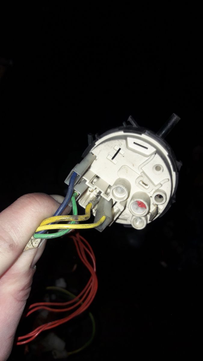

    Can someone please help , need some pictures of the connections , or wire colors for this model machine , thx
    This is how i connected them and the machine fills with water ....the PS does not stop water inlet...

    According to the original "
    2 x yellow - to P 2 x - yellow
    2 x blue - up to C 2 x - blue
    1 x red - for S 1 x - red
