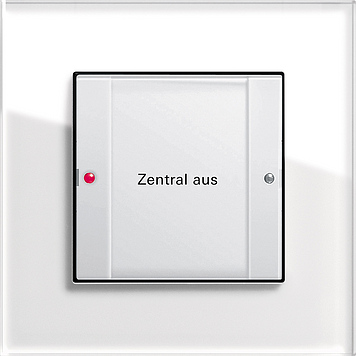

P.S. Mate, 15kVmaciej, since you’re so keen to lecture me on KNX, I’ll set you a simple task to solve:
The ETS4 demo is limited to 3 KNX devices. To set up the simplest system, you’ll need - one KNX switch, e.g. this one - one actuator, e.g. this one - a KNX power supply - a USB port, e.g. this one So, four devices. The question is: what do you need to do to set up and programme such a simple installation?
For any KNX installer, this task is a piece of cake.

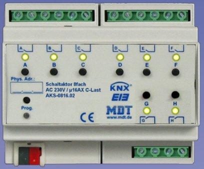

And later, how do you add something like this an 8-relay actuator
Question: what needs to be done to set up and programme such a simple installation?
1. Develop an operational algorithm. 2. Check the product specifications to ensure that these four devices are compatible and will ensure the algorithm functions correctly; also check compliance with the standards, certificates and approvals applicable in the relevant area.
3. Read the installation and configuration instructions and follow them. 4. Check to make sure everything is working, then issue an invoice

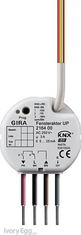

The photo shows a blind actuator – essentially a relay with changeover contacts
The switch is designed to turn the roller shutter or blind on/off, or raise or lower it. Generally speaking, it’s a trivial task that requires no development of an operational algorithm. I came up with this task specifically for that reason.

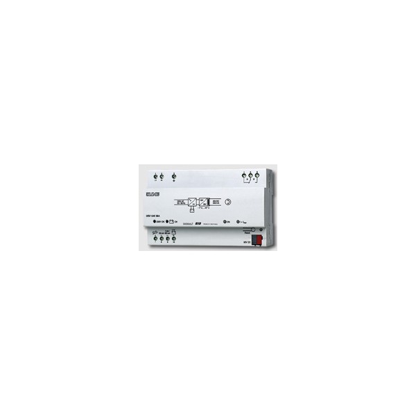

The whole trick is that neither the power supply nor the USB port need to be included in the design. Thanks to this, they don’t take up any physical addresses, which means we can use three devices whilst having a total of five.
During diagnostics, we’ll get an error saying that the power supply is providing too little current. Connecting an 8-channel actuator isn’t a problem either, as it only takes up one physical address.
So: (physical address) 1.1.1 switch 1.1.2 actuator (roller shutter relay) 1.1.3 8-channel MDT.
1/1/1 group address, e.g. for switching on a light, to which devices with physical addresses 1.1.1 and 1.1.2 should be dragged and dropped. This is a very brief description of the solution to this task.
Although the main point was that USB and a power supply do not need to be included in the design – something anyone who has dabbled in KNX or has at least read a book on KNX, such as ELECTRICAL INSTALLATION IN THE KNX/EIB SYSTEM INPE 10. Available on Allegro for 14 zł.
