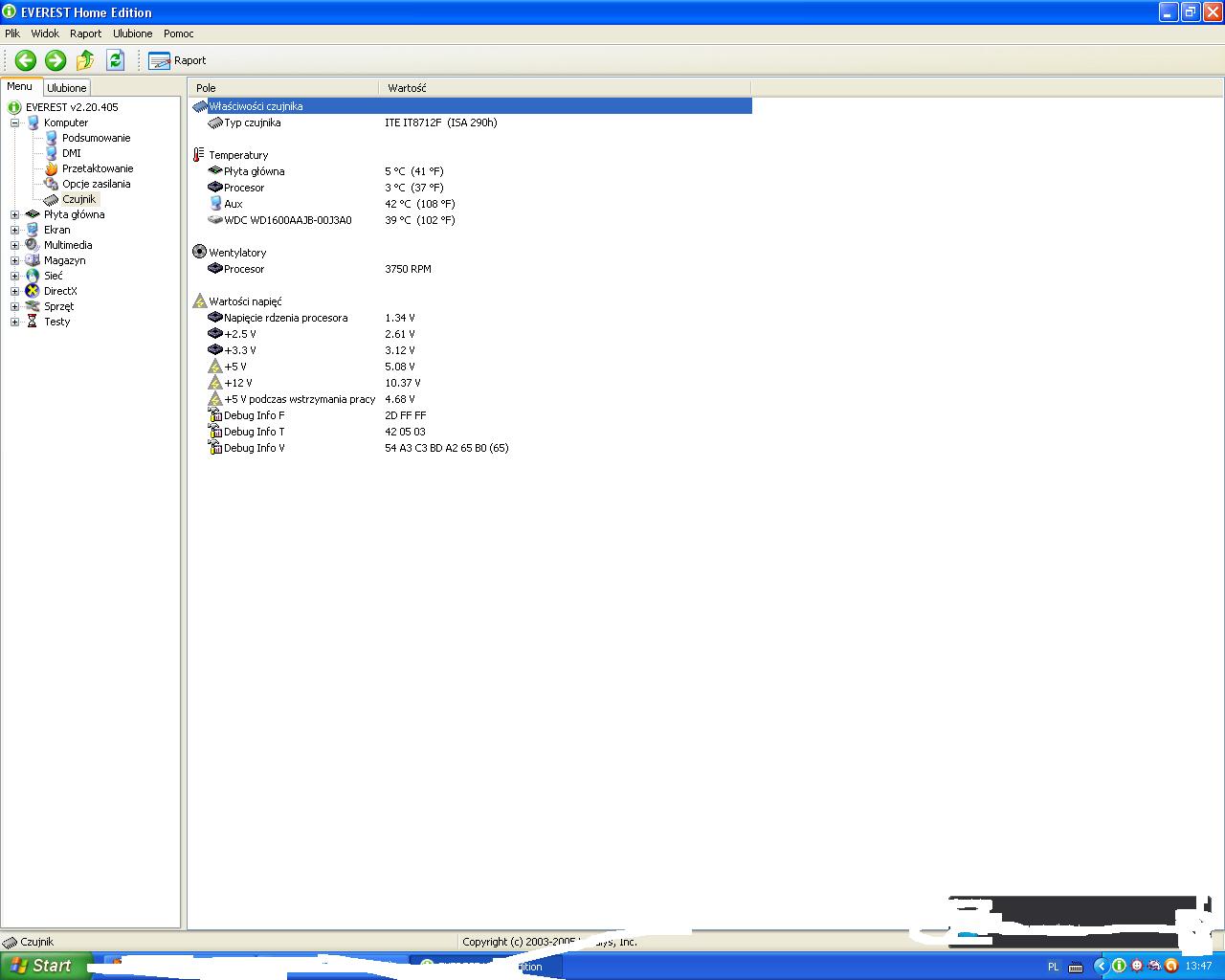

    Download the everest home edition program, turn it on, expand the "computer" category and click "sensor" there and get ss.

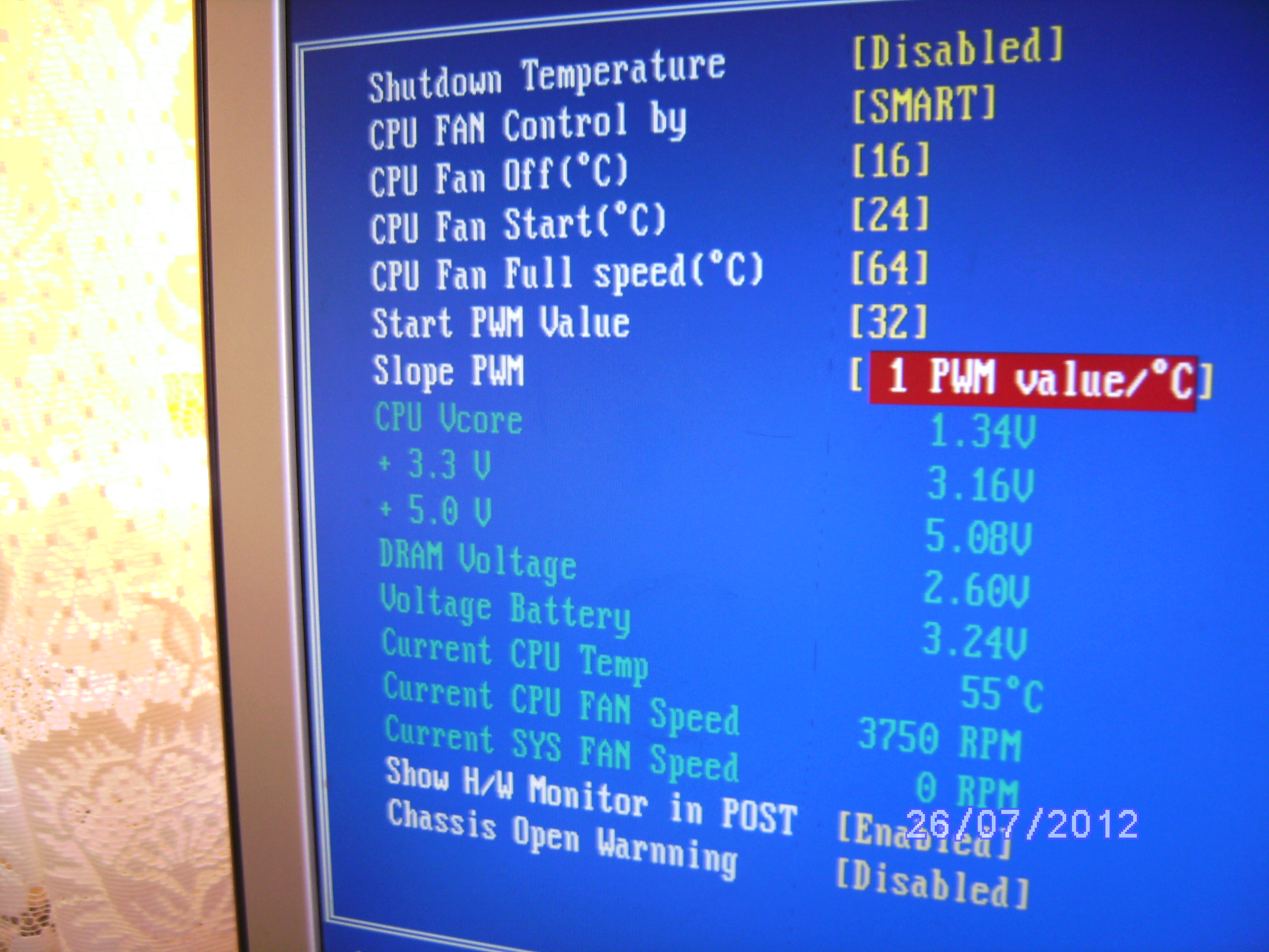

    I tried, I entered the settings that you wrote to me and I can not change anything there, but it wrote rotation + 3k: d
    I'm going to go into the bios right now and take a picture, then post it here.
    Added after 7 [minutes]:
    https://obrazki.elektroda.pl/5044096000_1343305611.jpg
    #9 11145590
    Replace thermal paste and improve case airflow
    #11 11146392

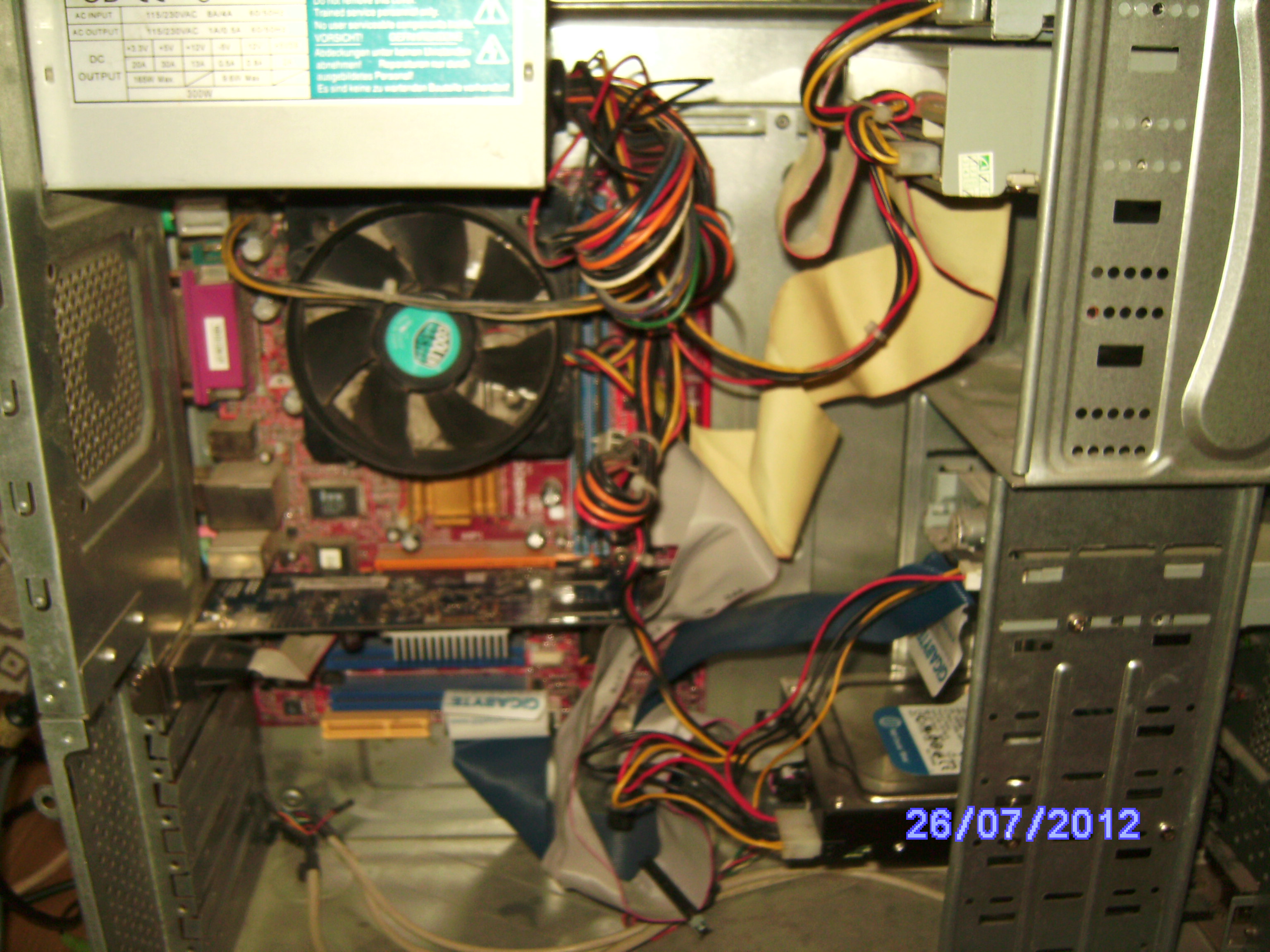

    Also include the power supply in the photo? Previously, the turnover was normal, I would like to return to them, there is no need to buy this computer because it is, you can say "szrot"
  • #13 11146447
  • #14 11146449
    Marson96
    Posts: 123
    Rate: 11
    https://obrazki.elektroda.pl/5567152400_1343322695.jpg
    Old crap, 4-5 years old ..
    Added after 38 [seconds]:
    Is the power supply about this cable or is it a box with a fan inside?
    Added after 9 [minutes]:
    I just mean mute this fan, how to do it. It is so loud that it is impossible to concentrate.
  • Clean the cooler, replace paste, add rear exhaust

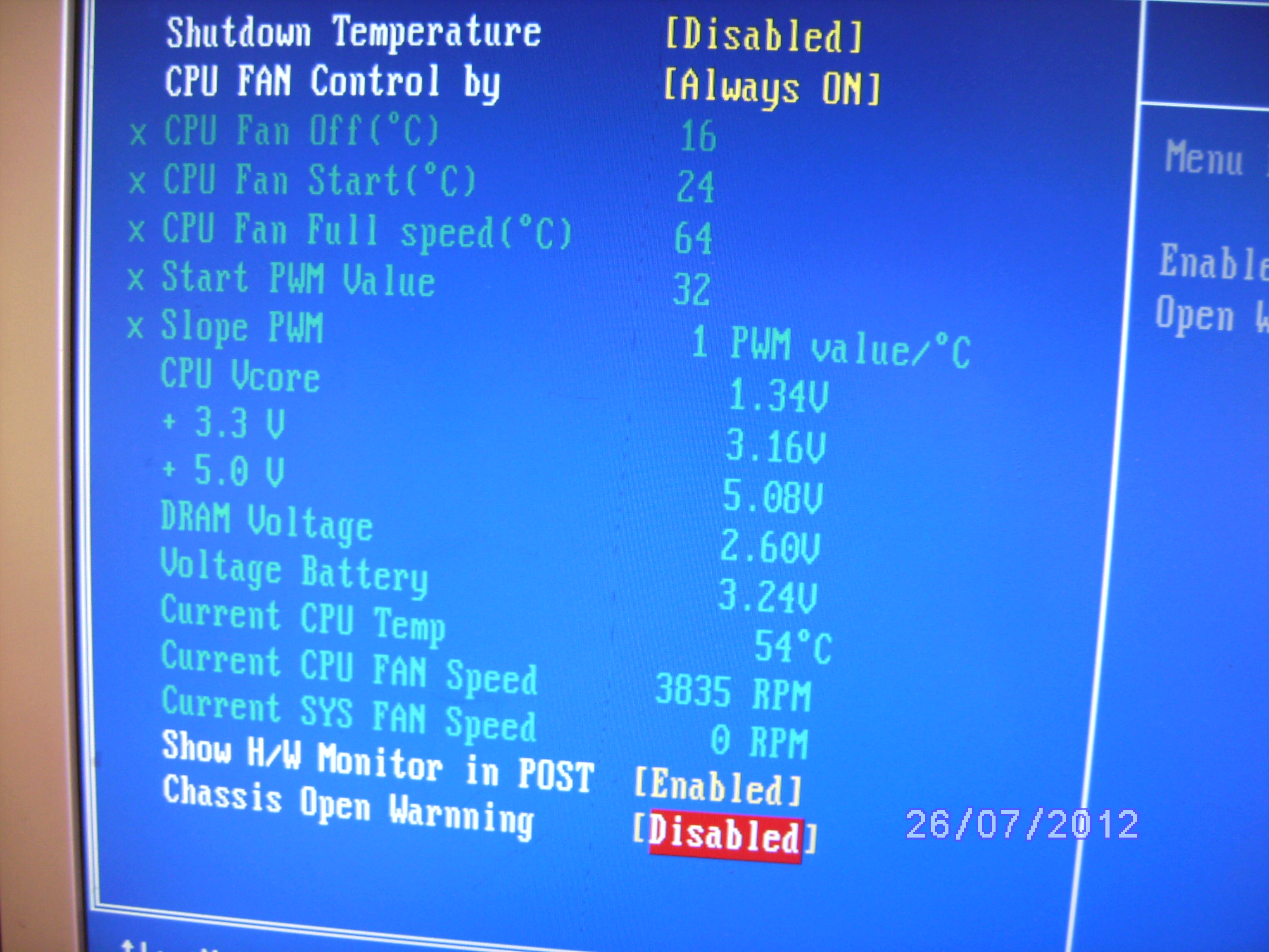

    I have just checked my motherboard at any time, it said "unknown". I have already reduced the speed of the fan, but I do not know exactly what these temperatures are for, it was written there.
    On this SS. https://obrazki.elektroda.pl/1898897800_1343324634.jpg
    It's exactly about the Shutdown Temperature. What does that mean anyway?
  • Clarifies fan terminology and BIOS shutdown temperature
    That was supposed to be a joke?
    We put large pictures with a thumbnail - the code with the thumbnail should copy itself to the post (at least in my Opera it is like that)
    Windmill -> fan .
    Shutdown Temperature -> temperature limit at which the computer turns off
    The motherboard model is probably painted on the laminate with thick font.
