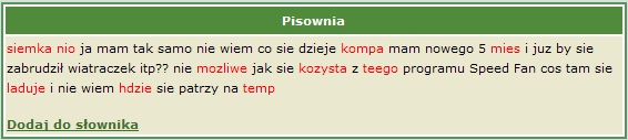

  • #27 3999871
    rafcio_120
    Hi, I have it, I don't know what's going on, I have a new 5 months and it would get dirty, etc ?? it is not possible how it ends with this program Speed Fan something is loading there and I do not know where to look at the temp
