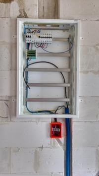

    the question may be trivial but I would like to be sure.
    I ran out of power to the switchboard and extended it this way as below in the photo (red box). 4x10 wire is extended with a 4x10 wire.
    I would also like to ask for a comment if I divided the PEN cable (as in the picture) - connected to Pe and Pe connected to N (cables connected only for show because I did not have 10 sleeves). Of course, I will connect the Pe rail with 16mm2 from SW.
    With Fr the wires will go to the distribution block.
    And the last question - does anyone have a way and what to connect the phase indicator to, because there are 6 or 4mm2 cables all around and 2.5mm2 to it, and connecting two cables with different cross-sections in one clamp is a bit unprofessional.

    Lord, where are the sleeves on these links?
    I omit the fact that the print industry starts to come out in the switchboard (4P RCD supplies 1P S-k).
    It had to be extended with ZUG connectors which are mounted on a DIN rail.
    nominal wrote:
    I would also like to ask for a comment if I shared the PEN cable (as in the picture)
    It would be appropriate to mark the PEN wire properly.
    And where is the protection for the controls :?: what is the protection for this switchgear :?:
    Such connection is not allowed !!!
    Extending 4x10 Power Cord, Dividing PEN Cable, and Phase Indicator Connection Methods
    This is FR, RCD and SPD :?:
    Thanks for the hints.
    It is possible, but it is advisable, that both the wire and the rope be enclosed by two clamps. Of course, the cable in the sleeves (they are longer on sale, so no problem)
    For phase indicator, use a distribution block and, if required, provide protection for this indicator.

    Correctly, the sleeves are not there yet, but they will be, I'm looking for long enough to make the contact as big as possible.
    And apart from the lack of sleeves, the idea of connection is acceptable?
    Ski connected to the RCD temporarily.

    Actually, these ZUGs will probably be the best, the can will be removed.
    I didn't think about securing the controls, but they will be added.
    In fact, the connection is not very professional - it will be changed to 2X6
    SPD will of course be - I'm waiting for payment, because the switchboard + equipment is almost free ;)
