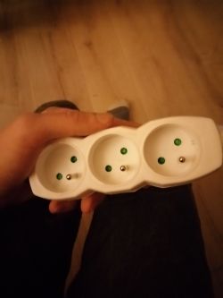

    Hello, I have a very amateur problem, I can't put anything into the sockets that are in the picture. How to unlock these sockets? There are some green "caps" that block anything from going into the extension cord.

    When inserting the plug at the same time, pressure on both plugs unlocks them. To prevent a child from sticking a nail into one hole.
    Sometimes it jams and the pins of the plug are not able to move them away.
    The only thing left is to take them out.

    And how to throw them out? Do you have to unscrew the whole extension cord?

    Unfortunately yes.

    If this is a cheap Chinese "extension cable", there are no screws on the back, only rivets. Only drilling the rivets, i.e. the destruction of the housing, remains.

    With it disconnected, loosen these caps with a small Phillips screwdriver.
    Later, they should yield to the pressure of the "pins" of the plug.

    If this is a cheap Chinese "extension cable", there are no screws on the back, only rivets. Only reaming of the rivets, i.e. destruction of the housing, remains.
    Not exactly.
    As he disassembles, he will find 2-3 points where you can screw in small screws and collect it together.

    These plugs are there to ensure the safety of use. Removing them is not allowed!
    They have been used for several years and it is strange that the author has not come across them yet.
    The author of the topic should practice a bit, sometimes you need to turn the plug left or right to get the hang of it.
