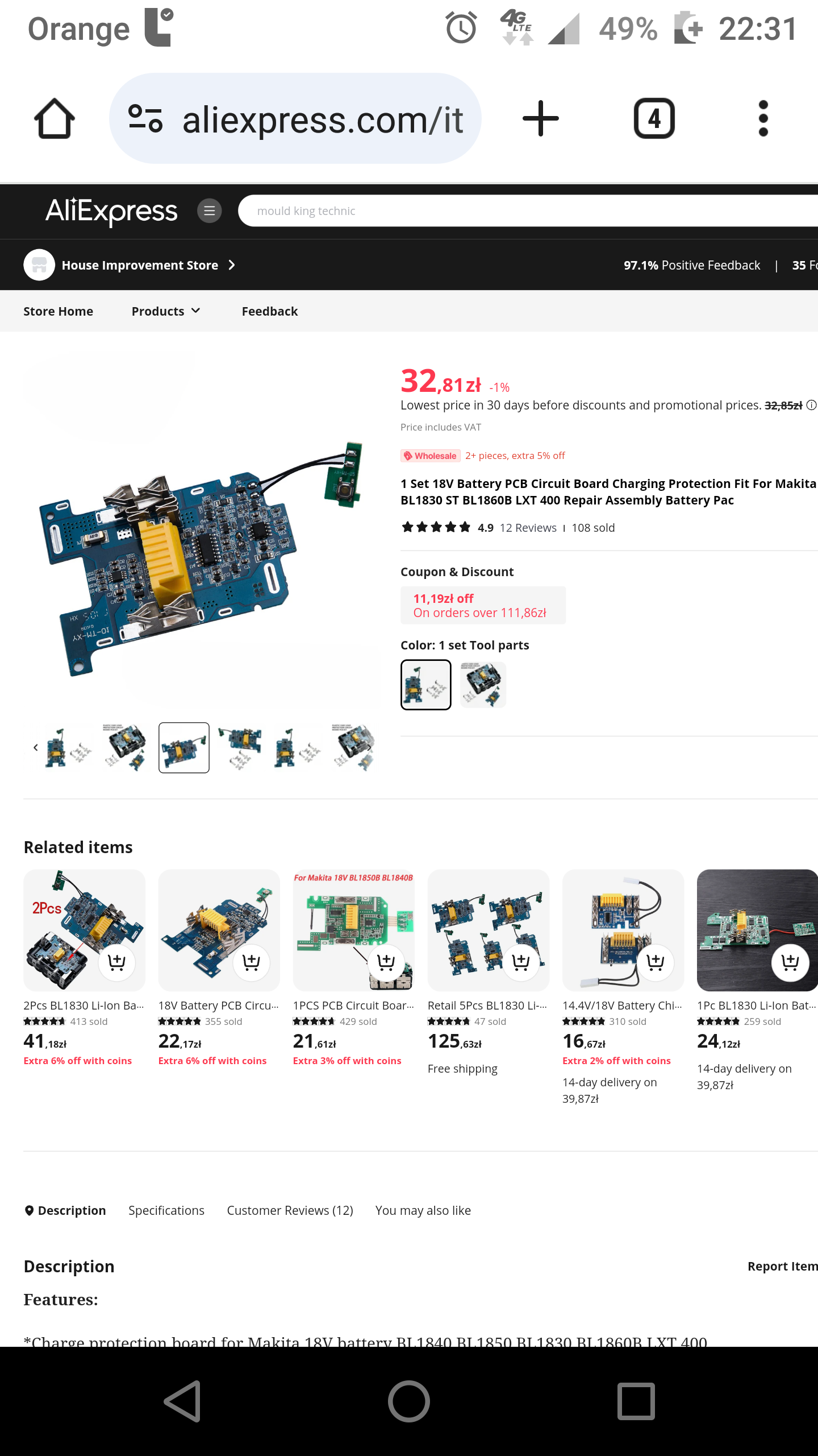

    Battery plates with a full balancer and a fairly decent 4-LED status indicator are now available on Ali.
    Example:
    Screenshot of an AliExpress listing for a 18V battery PCB for Makita charging.

    This is what I did too, the balancer connector fits perfectly in the battery before the charging connector, just cut out a 2.8x8mm rectangle. There's a video online of a guy doing exactly that.
    The Chinese guy has a board for the Makita with a full balancer (not detecting the weakest cell) but you have to give not PLN15 but PLN70 for that. And from there (adding branded cells) close to the original.
    PS This Romanian link adds little....

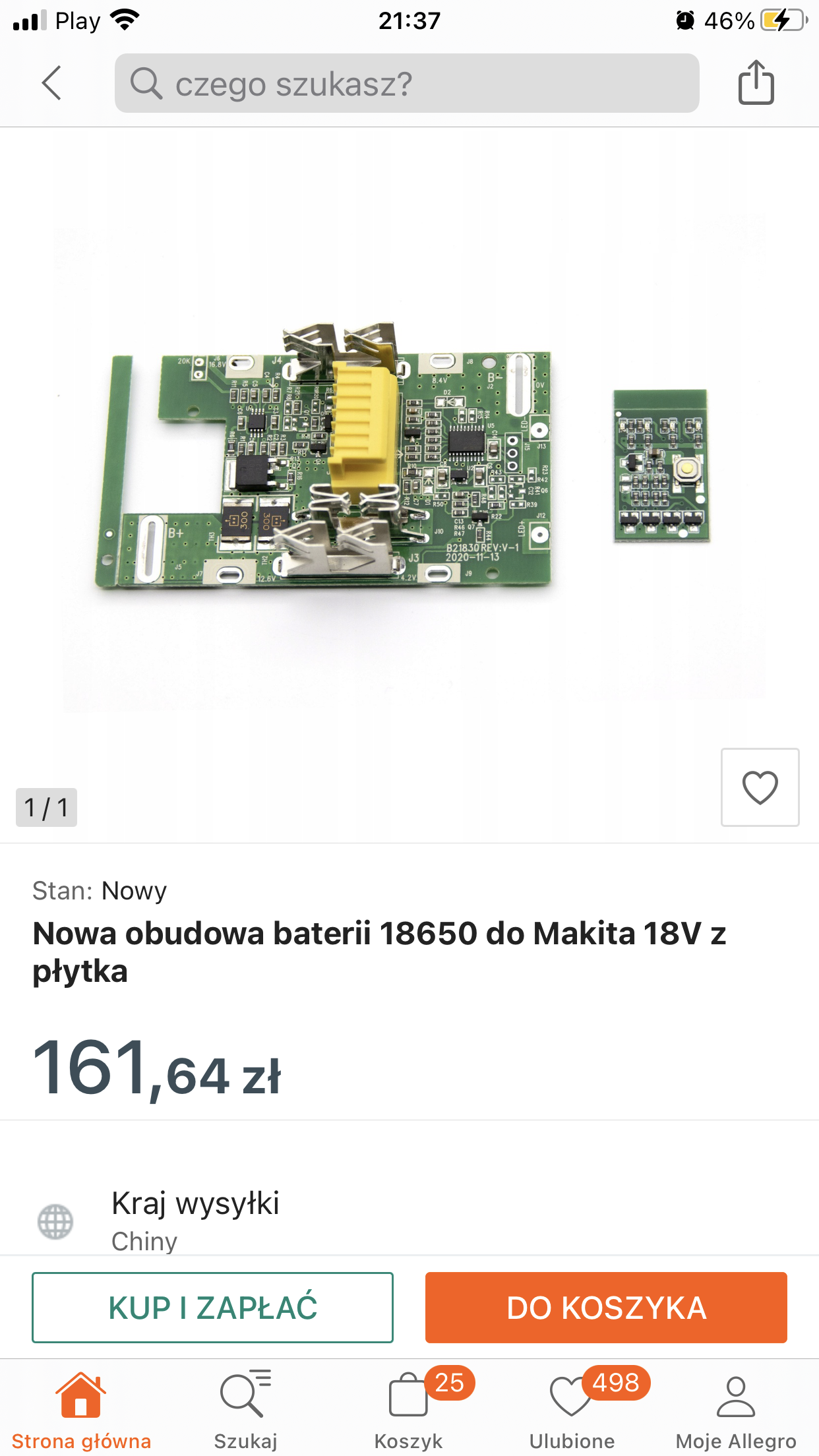

    Of course better, but on Ali the same one stands for up to PLN50.
    E.g. : https://pl.aliexpress.com/i/1005004338399094.html
    Guy has found himself a good source of income....
    I use one myself : https://pl.aliexpress.com/item/1005004831993985.html - it has a more convenient configuration for me under the tin (and red LEDs - almost like the original ;) )
    I also used to take the versions with active overload protection (those mentioned above have only active charging protection and there is only a polymer fuse at the output), but I had to add extra measuring resistors to increase the cut-off current, because otherwise the battery would shut down before the protection in the machine was triggered and circuses would ensue. Anyway, all Makita machines have overload protection built into the controllers and putting one in the battery only makes sense if you are using it via an adapter with some primitive machine from another manufacturer.
