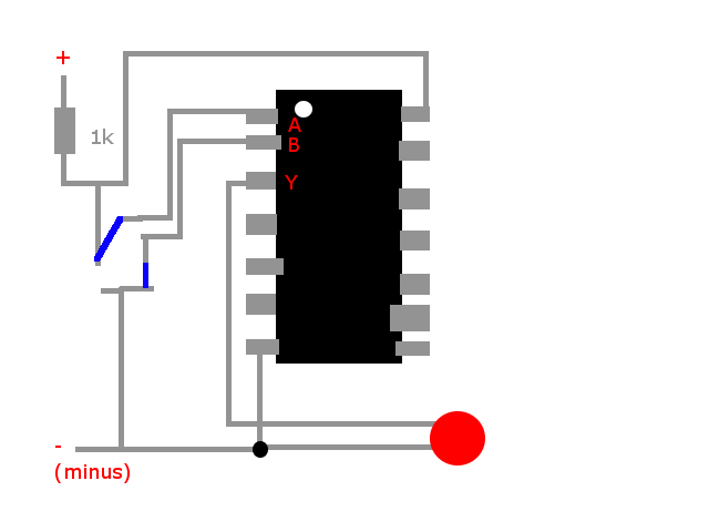

    I just don't quite understand. I'm green.
    So this:
    I bought a CD4070 (4x Xor), one led and 10 1k resistors.
    Now what do I do to make this a gate that lights up if there is one on the output. It looks trivial in logic diagrams, but I don't know how it should look like in reality.
    Maybe someone can send me a picture or a picture (not schematic) of what it should look like in reality.
    Understand me, I want to understand :)
    Regards
    @Edit:
    How to Set Logic High and Low Inputs for CMOS Chips Using Buttons in Real Circuits?
    Will the system work if it is soldered like this? The blue ones are a switch made of a needle to choose plus or minus. If not, what am I doing wrong?
    Edit: I left the pins empty for the sake of simplicity. I know they need to be connected to ground
  • #11 11331024
    tos18
    Level 42  
    Posts: 7139
    Help: 1113
    Rate: 1870
    My suggestion is to first explore the issue of reading schematics.
    The CD4070 looks like this
    You have four identical xor gates in it. The system requires a stable and filtered power supply, as a last resort it can be a battery. You connect the power supply + to vdd(14) , - to vss(7) a 100nF ceramic capacitor connected in parallel to the power supply will be welcome. connect unused inputs to ground (5,6,8,9,12,13).
    you connect a resistor to the output (3) and the anode of the diode to it. Connect the cathode to ground. you connect inputs (1,2) to resistors and their other ends + power supply.
    you will also connect switches to the inputs so that switching on the switch causes the input to be shorted to ground (open switch is 1 on the input, closed switch is 0).
    Draw what I described and present.

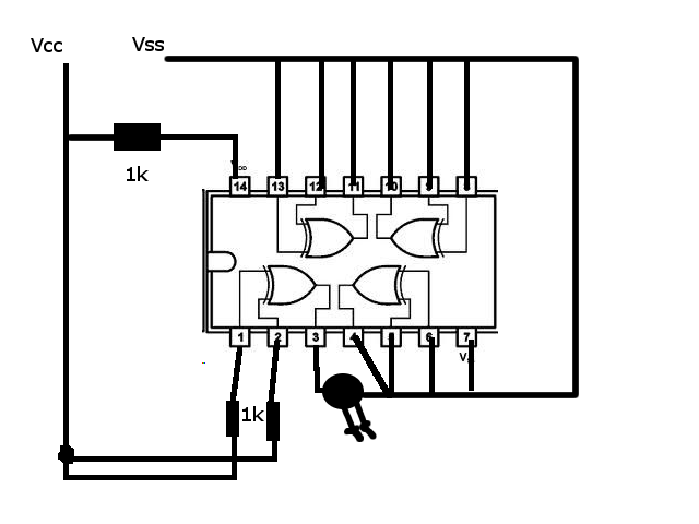

  • #12 11331079
    LordCompi
    Posts: 8
    Will this work?
  • #13 11331134
    tos18
    Level 42  
    Posts: 7139
    Help: 1113
    Rate: 1870
    You don't read carefully. It's bad. Incorrect connection of power supply and LEDs. Who told my friend to short the outputs???
  • #14 11331141
    LordCompi
    Posts: 8
    Can you show me what's wrong?
    The best in the picture
  • #15 11331192
    tos18
    Level 42  
    Posts: 7139
    Help: 1113
    Rate: 1870
    Unused outputs (4,10,11) are to be left free. There is no resistor for the led. The power supply of the system is not connected through a resistor. A capacitor is missing in the power supply between vdd and vss. The switches went out for a walk...
