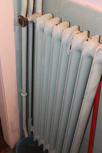

    I have a problem with the installation of what is at my home. Some radiators do not heat me up. The installation is not a new open gravity type. It is several dozen years old. Recently, I replaced the stove with a new one because the old one was already growing inside. I drew an approximate diagram of this installation:
    Installation of SOLEI EKO-KWR 15 KW ELEKTROMET CO Boiler: Some Radiators Not Heating Up Properly
    Radiators that heat are marked in red, and those that are cold are marked in blue. The new furnace is a CO boiler with a water grate SOLEI EKO-KWR 15 KW ELEKTROMET. I am also sending a photo of connecting the stove to the installation:
    I have no idea why these two heaters are not working. Certainly all the valves on the radiators are open, because after installing the stove and the first start-up, the upper parts of both radiators were barely lukewarm, then they stopped heating. I regularly allowed water to be installed once every 3 weeks for the so-called "trick". Previously, they also did not heat up with the old stove. The radiators are quite old, all cast iron. I am also sending the look of the radiator of one of the two that does not work together with the end of the overflow pipe and the photo above it of the pipes that enter the attic to the expansion tank and the pipe that goes to the other non-working radiator:
    Installation of SOLEI EKO-KWR 15 KW ELEKTROMET CO Boiler: Some Radiators Not Heating Up Properly Installation of SOLEI EKO-KWR 15 KW ELEKTROMET CO Boiler: Some Radiators Not Heating Up Properly
    In case of doubt, I can send more photos or explain the unclear ones.
    I am asking for help, because another winter is coming, and I would like the bathroom to be finally warm.
    Regards Macros1111

    Do these heaters do not heat up at all, or do they hardly heat up at all? If the latter is the case, it is also necessary to distinguish between whether only the top of the radiator heats (poorly) and the middle and bottom are cold, or whether they heat (decently) the first two ribs and the remaining ones are cold. If only the top heats up and the radiator below is cold, it means that the water flow through the radiator is very weak, i.e. there may be a silted orifice, a twig overgrown with stone that supplies water to the radiator (or return), an incorrectly selected orifice (too small hole - through which is more easily silted). If the first 2 elements heat up and the rest of the radiator is cold, there is air in it. PS I do not consider high heaters at all, because they warm my head and the legs are cold.

    Both of these radiators are cold. They don't heat up at all. In the diagram, I marked the blanked tube next to the tank. I unscrewed the cap and let the water flow in so that the water overflowed in that place. I also tried casing, i.e. screwed all the radiators on the ground floor, but it did not work. There is water in the tank, because when you move it, you can hear it splashing :)

    If they are not air-tight, unscrew them and rinse, maybe the sludge has blocked the drain.

    I think that the radiators are muddy, and besides, because they are radiators on the main riser, they had to be concealed quite significantly, and small passages can be easily blocked after many years.
    All that's left for you to do is take off those radiators and correct (clean) the passages.
    After the last time the water was drained and a new boiler was installed, a lot of the rust probably fell off inside.

    I think that if this heater is very dirty, the bowl may not be enough :) I remembered that in that heating season, when water was released, something happened that probably something happened, because the pressure indicator on the stove reached the end of the scale and wanted even more, and at one point I heard a loud gurgling, and a lot came out of the overflow pipe a lot of such black goo and the water ran down. After that, the pressure normalized.
    First, I will try to unscrew the pipe that supplies the radiator with warm water, because there may be air in it. And I have to replace the bowl with a piece of tube that I will attach to the overflow so that the water flows directly to the grate in the floor and not to the tiles :)

    Two years before the replacement of the stove, the radiator in the bathroom barely heated, only on the very top on two ribs. Later he stopped. The second heater in the room only half-full, and only for a day or two after adding water, then stopped. After installing the stove, all valves were opened to max. At least I think they were unscrewed, but they are very old and still have German inscriptions so I'm not sure if they unscrewed. The installation was then filled with water. Today is a cold day and I just lit the stove. The radiator in the room does not heat up to half temperature and will probably stop within a few hours, and in the bathroom it does not heat up as before :)

    It was enough to unscrew and rinse the radiators from the trail :)
