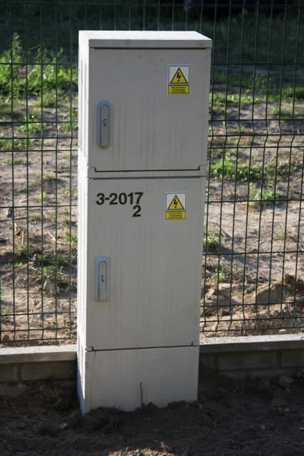

  • #36 11468845
    andrefff
    Level 36  
    Posts: 2719
    Help: 321
    Rate: 807
    This is more or less what it should look like
    Converting Single-Phase to Three-Phase: Electrician vs Company and Ownership Act
  • #37 11468863
    ok for cable installation yes ?? but overhead, that is, there will probably be a link from the pole to the top of my building, this is what it looks like for my neighbor
    #39 11468882
    masonry
    Level 30  
    Posts: 2742
    Help: 106
    Rate: 832
    Of course not.
    A lot of electricians write here, storytellers and write what they saliva on their tongue.
    If you have an overhead connection, the ownership boundary is most likely on the insulators at the top of the building and will be replaced up to this point by a power plant (if necessary). It's up to you to replace the WLZ (i.e. the riser) and prepare the pre-meter protections and the place to connect the meter.
    WLZ 4X25mm YAKY or ASXsn is more than enough, even if you ever want to increase the power. From the YDY counter 5x10mm is also enough.
    Do not buy anything until knock, you will not get an answer from ZE and you will not approve the scheme because it may turn out that you bought something unnecessarily.
