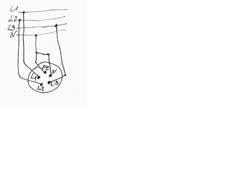

    Hello, I have a 5-pin power socket plug. And now L1 ... L3 is the individual phases! But... What is N and such ||-
    such an inverted dash and the letter T is what is mass or N is mass!

    N is neutral -> former "zero" -> blue
    The thickest one is for the protective conductor -> yellow-green

    um... Mariusz Ch. thank you very much, and maybe you know because I have to change an old metal 4-bolt flat muff to a 5-bolt round one. And now I know that I probably have to omit the grounding, but on the sockets of these new ones there are markings L1 L2 L3 NI is "T" with a line on top, which is grounding. And on this is RST and Zero. You can compare it somehow :?: :?:

    From this you can see that you have a four-wire installation and a TN-C system.
    L1 -> R
    L2 -> S
    L3 -> T
    O -> N and here we additionally connect the metal housing of the receiver and omit the protective one
    or omit N and use the guard pin.
    greetings

    If you are to convert the installation from four-wire to five-wire:
    Old Plug-New Plug
    Phase R-L1 Phase
    Phase S-L2 Phase
    Phase T-L3 Phase
    Zero N-PE Protective (Thick plugs; Cable should be yellow-green)
    (None)-N Neutral (Blue short to yellow/green)

    Hello, Mariusz Ch. you messed up a bit, we don't skip anything in the installation!
    in the new socket, connect the neutral and protective terminals with a bridge and connect the neutral wire there, the plug is equipped with a cable with five wires in which the wires are connected correctly, i.e. the protective one is the body of the device and the neutral is its "working zero" (control, signaling). A device connected in this way, transferred to any other installation, even with a "differential" will work properly. :)

    Old four-wire installation. Only the plug/socket is new. Where is the differential and separated PE and N?

    Hello, I am also amazed if you read carefully what I wrote in the socket there is a bridge between the neutral and the protective one and from the plug to the device the installation is made with a separate protective circuit, this is a standard, when buying any device it is made like this
    (the bridge is only in the socket)
