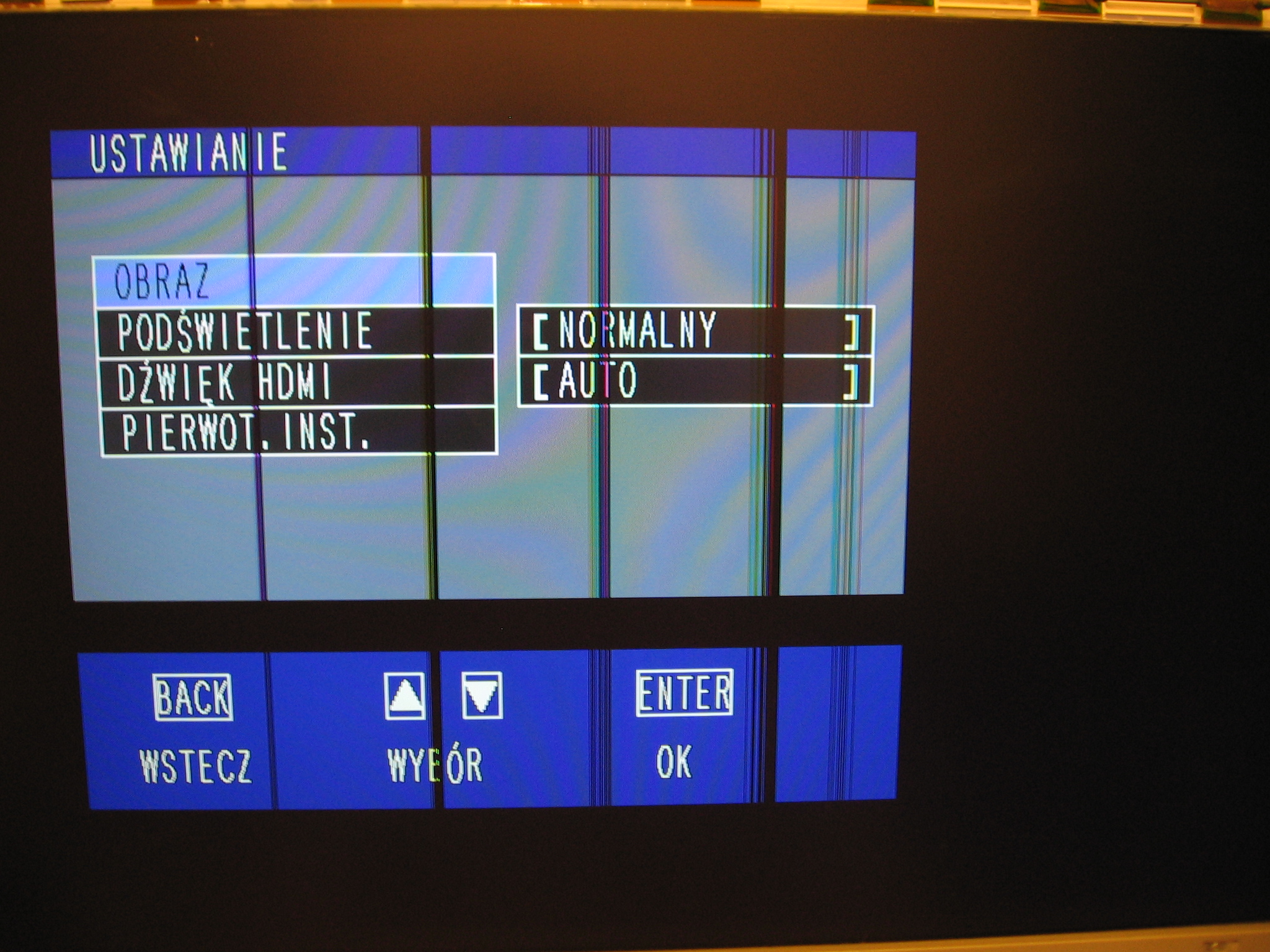

Can vertical stripes caused by the chips on the flex tapes going to the LCD matrix be repaired, or does the whole matrix need to be replaced?
The panel is effectively a write-off, and the practical fix is to replace the entire matrix [#11950025][#11954268] One reply says the damage is in a clearly identified place on the matrix and that you can only try “miracles” on that chip until the material is physically destroyed [#11954268] Another reply says that, while it is technically possible to reattach the chip, this requires hot air and practice, and even then it is just a repair attempt, not a guaranteed solution [#11954317][#11954474]

    Vertical stripes. They look like on a photo
    Unfortunately, the problem lies in the scalpers on the flex tapes going to the matrix. Reagree for tightening, moving the tape.
    These are scalers glued to the flex
    My question is if I can do something about it?

    Well, it's just a matrix replacement.

    Unfortunately, the problem lies in the scalers on flex bands going to the matrix. Reagree for tightening, moving the tape.
    My question is, can I do something about it?
    Try to call him.

    Although technologically, it is possible to "spawn" this chip again.
    I used to talk to a Chinaman from a company that produces LCDs, but so small, he claimed that if you put a scalpel on the glass wrong, you can download it and put it back again.
    It's just that in China, it does wonders.

    And in this particular case, what did you expect from us? ;)
    You have a matrix for scrap and a clearly diagnosed place of damage. You can test "miracles" there on this chip, until the physical destruction of the material in case of it.
    Hot winds are supposedly good for everything. ;)

    MaG_ wrote:
    Although technologically it is possible to "put" this chip again.
    Of course it is, I did it many times. Always successfully.

    They will come by themselves, they will have enough willingness and a little practice. It's best to change two places first.
    Of course, hot-air is needed.

    These scalers glued to flex tape? This is not BGA.

    MaG_ wrote:
    These scalers are glued on elastic flex? This is not BGA.
    They're flying in balls :D
