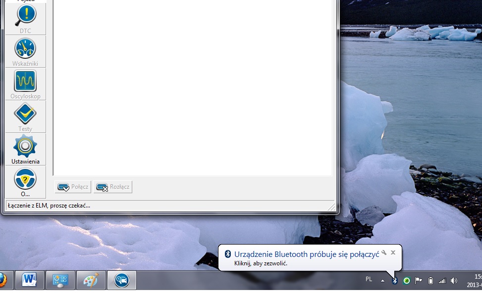

    When trying to connect by ScanXL or another program, it gets a message that the Bluetooth device is trying to connect
    Elm327 Bluetooth: Resolving Pairing Code Issues with ScanXL & OBD2 - Guide & Solutions
    It's ok and I have to enter the pairing code (although it is already paired and saved)

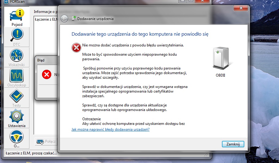

    And here's the problem I tried 0000 1234 5678 7890 and various combinations like that, no effect. Also when reinstalling, I choose the pairing code 1234 or something and the same effect (can't add device due to pairing error)
    He also requests a code via the phone or tablet. Anyone have any idea what to do with it, it can somehow be converted to a USB or bypass or crack this Password.

    You must have the pairing code that came with your device otherwise you are unlikely to bite it.

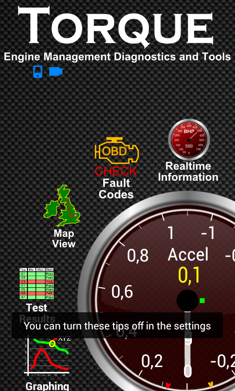

    and how did you gentlemen move? I have a similar problem on xperi p, the interface checked on HTC and tablet works, and the phone pairs with the interface as the same, and the torque will ask the code to pair indefinitely :(

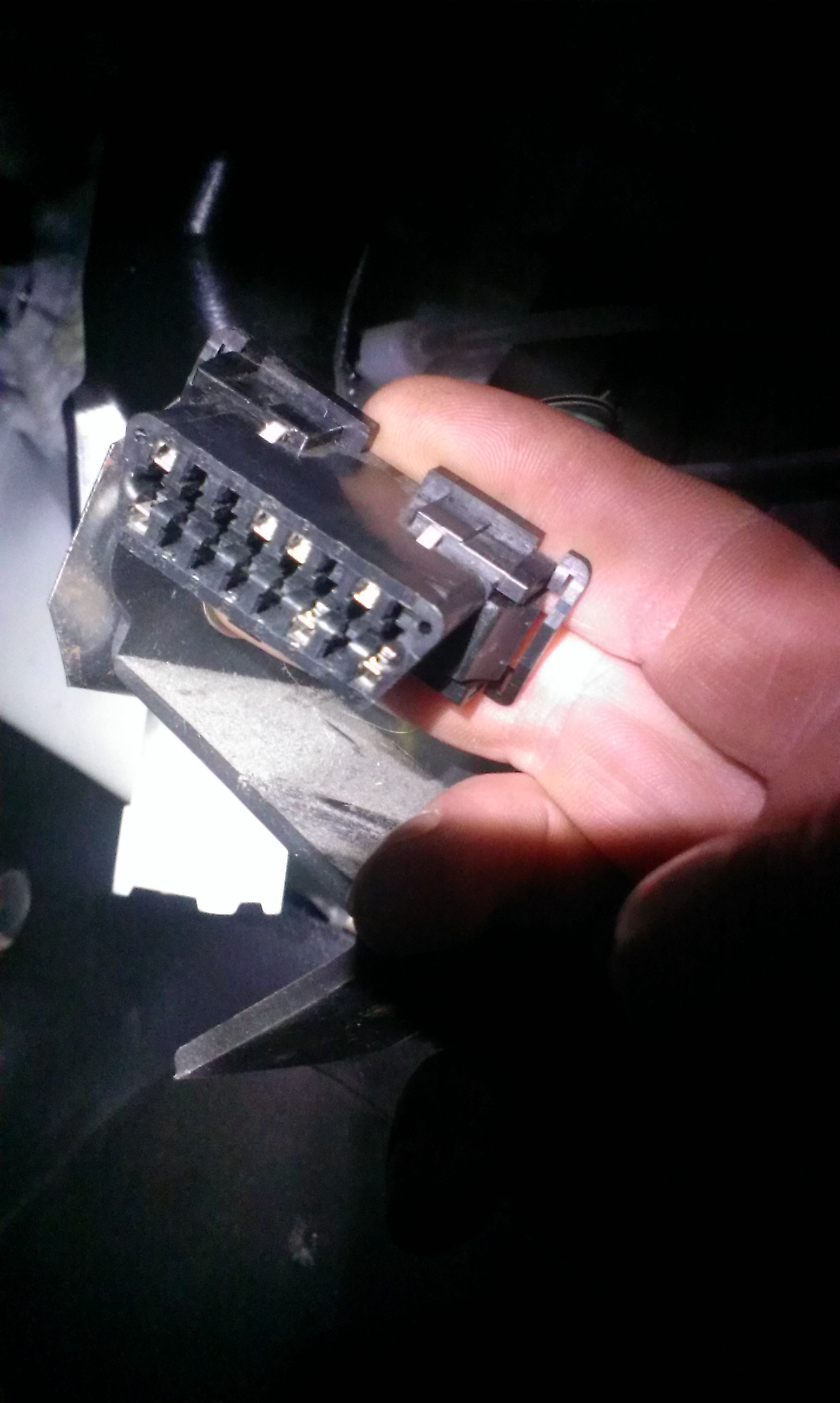

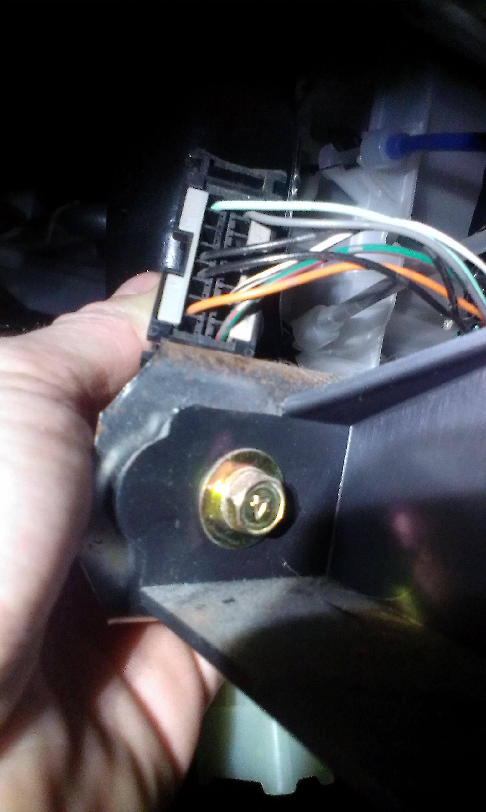

    Colleagues, can it be that I have changed wires in the socket? Well, the car is a mitsubishi lancer cs0 and elm bt in other cars it works and not for me. some AC tester connects and autocom and kts also does not. Elm327 Bluetooth: Resolving Pairing Code Issues with ScanXL & OBD2 - Guide & Solutions
    this is something that only appears to me.
    greetings
    Maybe I will add photos of my socket, as well as I ask people who know the subject to comment on what protocol my car supports.
