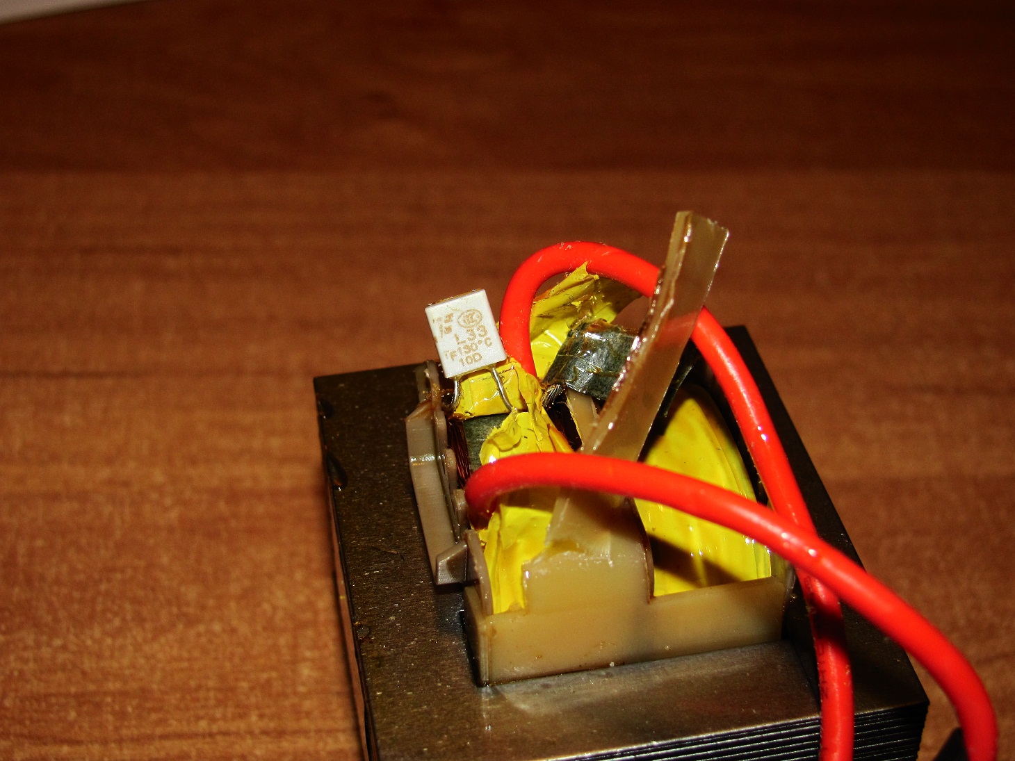

    I tried to understand (by Google translation!) the resolution of the problem of this topic:
    Link
    But from the schematic (page 16, top right)
    Link
    I don't see any fuse.
    As I understood, there should be a fuse that can be bypassed by simply connecting two pins together, but probably now I think I was wrong.
    Please help me bring this NPT-1224P transformer back to life!
    Thanks in advance
  • #2 12045359
    highlanderus
    Level 30  
    Posts: 1050
    Help: 174
    Rate: 186
    You have to find under ribbon plastic part. It is thermal fuse. Look likt this:
