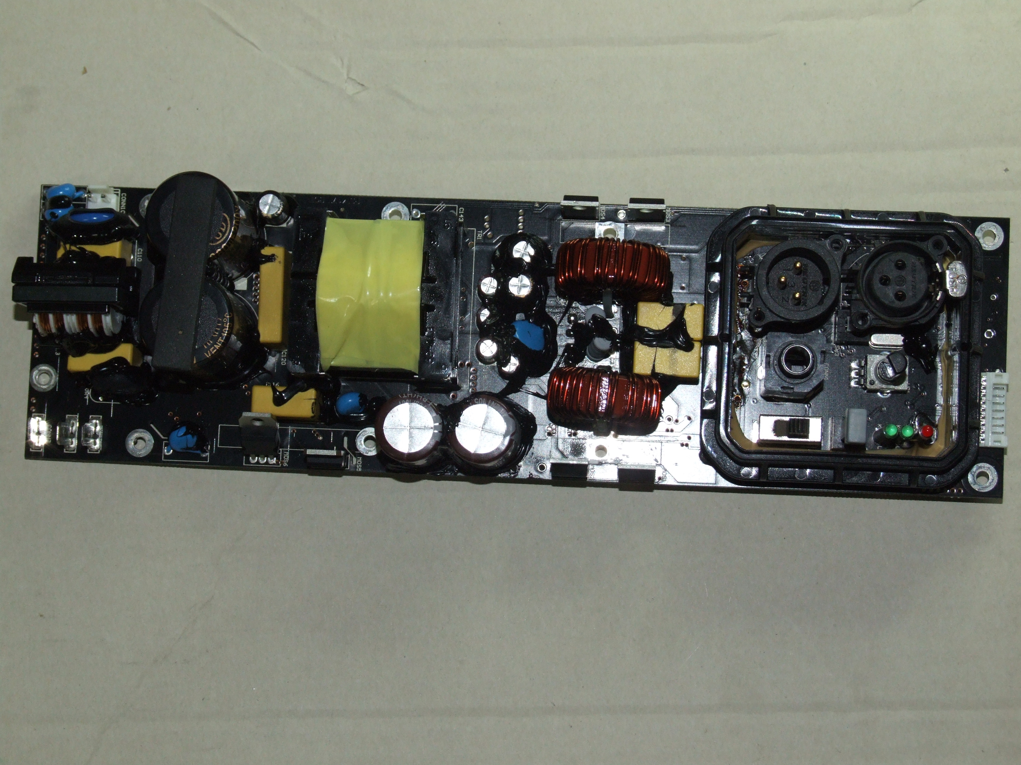

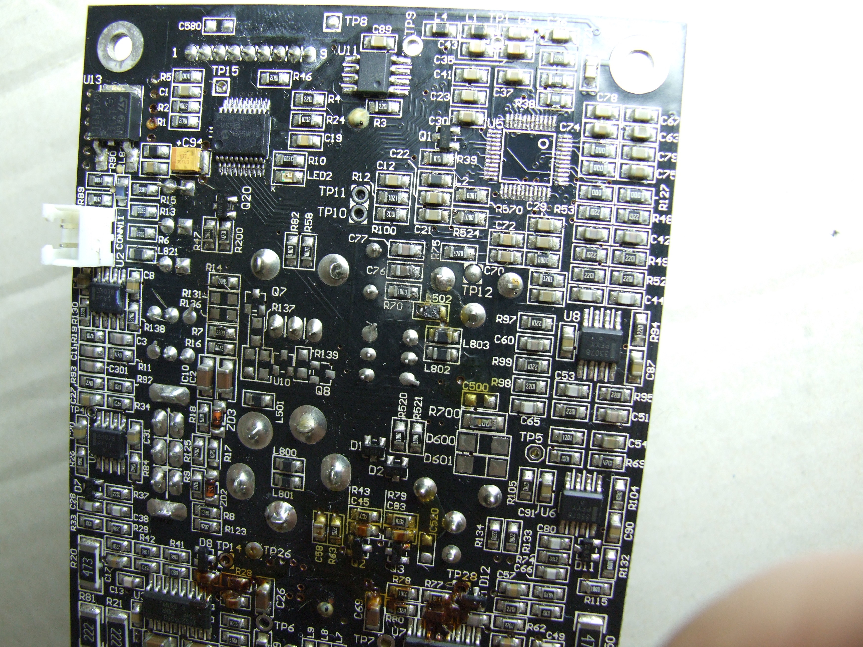

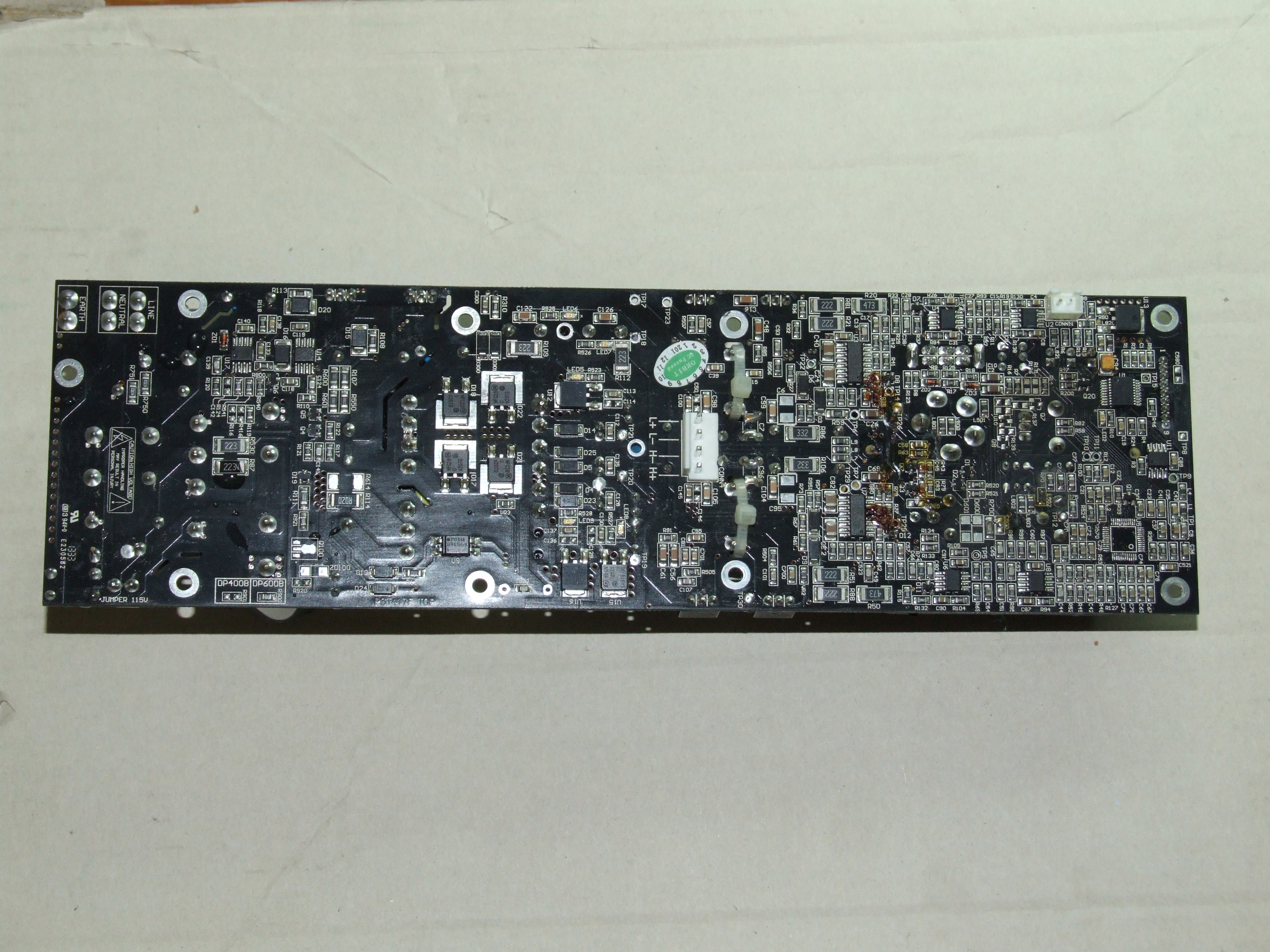

    I need to identify two elements (their values) on the board (PST417F) from the above mentioned columns. One is a choke marked L502 and a capacitor marked C76.
    Will someone help?

    Photo, buddy, clear photo of this plate (on both sides) ... it will be hard to remember.

    Świr

    Here you are (better my camera can't):

    I see two outputs, either find the schematic (which may not be easy) or measure these items in the second column. Do you have access to capacitance and inductance measuring instruments? Expect this capacitor to be something a la 100nF, but it's shooting in the dark. However, it is better to measure.

    The measurement from the second column is out of the question. Unless someone has better meters than mine. I need the value of these items preferably from a service shop. This capacitor is not 100nF. Unfortunately.

    Have you tried to write a mail asking the manufacturer for a diagram? Crate didn't bother me with that.

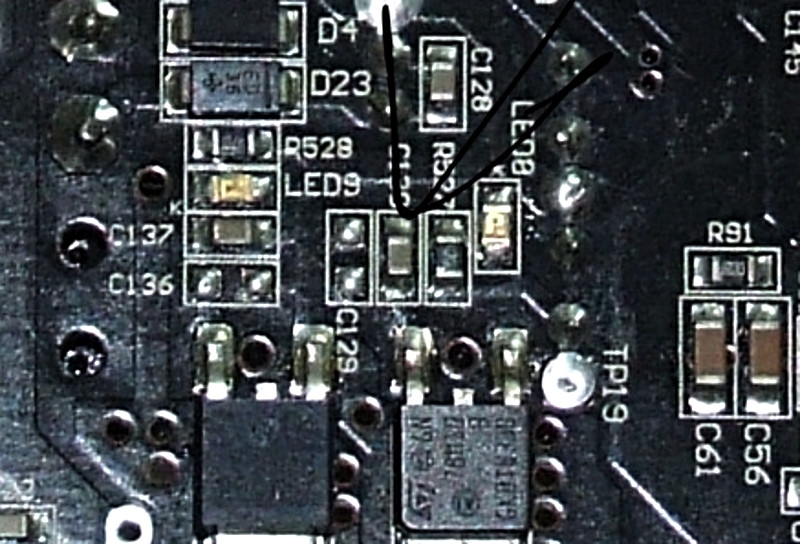

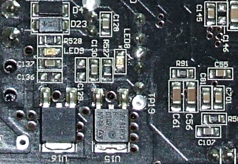

    Hello, the question as above is only about one tiny element that has been lost to me. What is a coil, resistor or maybe a jumper?
    Thank you in advance for your help and best regards.

    You mean the C130? The description suggests a capacitor. Give the markings of these mosfets, maybe the application will tell you something (I would always start with 100nF).

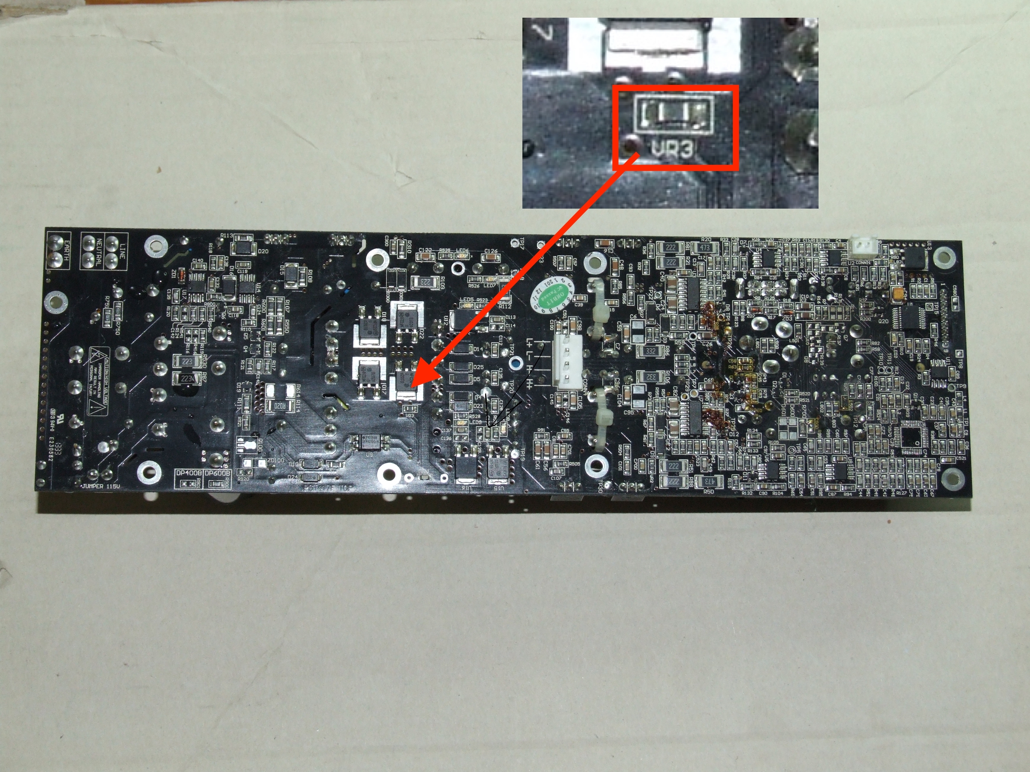

    The capacitor is marked with a black arrow and there should be no problems with identifying the type of element.
    The marking of the element marked with a red arrow and the letters VR can mean a varistor, i.e. a varistor.

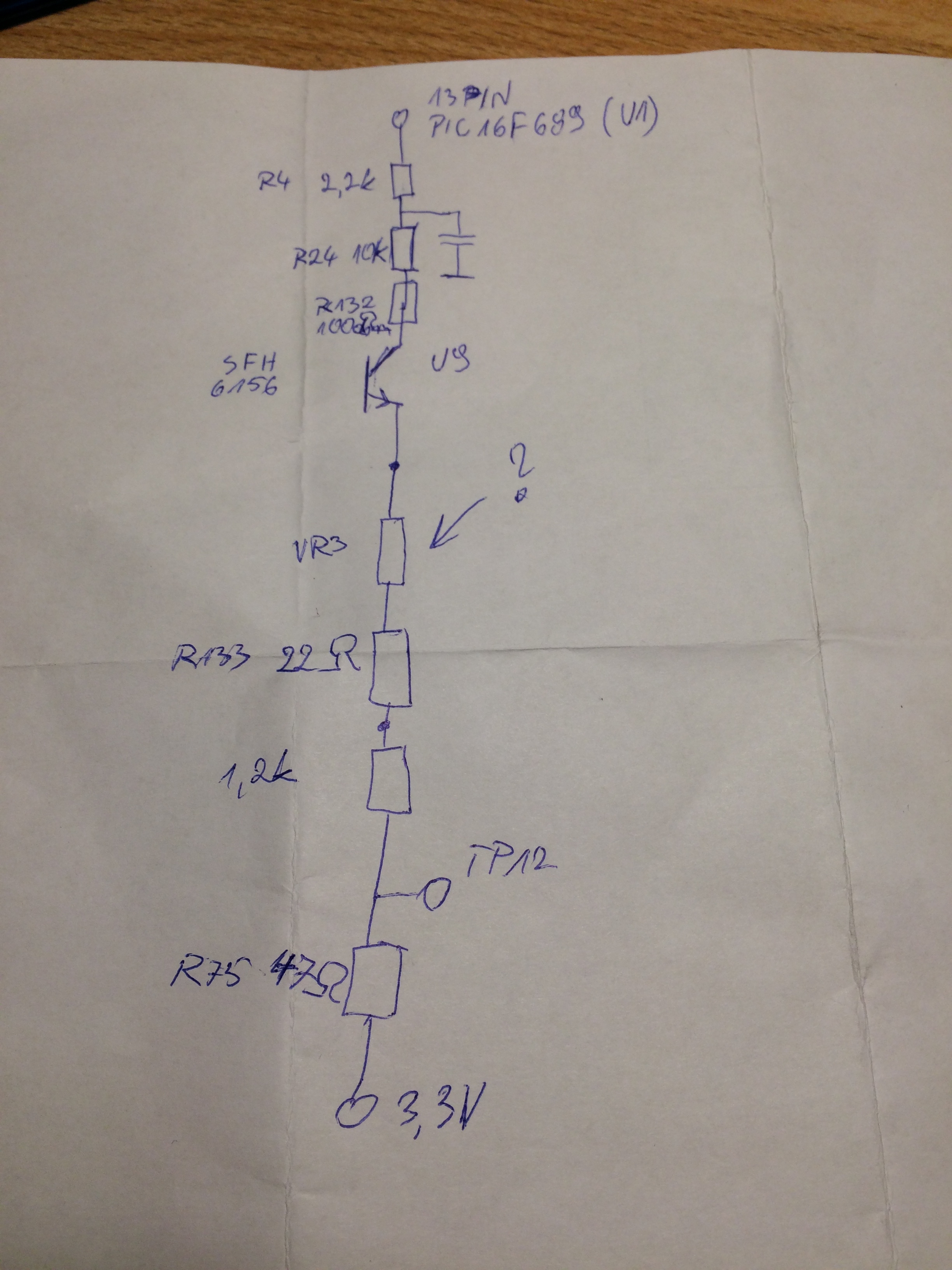

    Hello, I was able to determine that VR3 is a thermistor, but I do not know what resistance it should have and whether it is an NTC or PTC thermistor.
    Please help.

    It is located next to the rectifier circuit, so maybe it is an NTC with a value of single ohms, used to protect the diodes against too high a charging current of the capacitor.
    In the photo I cannot see if VR is connected to ground or to a thin path leading to the via, which is very important as it determines whether it is a varistor or a thermistor.

    RCF Art 715: Identifying L502 Choke & C76 Capacitor Values on PST417F PCB Board 100% is a thermistor because on the other side is VR4 and it is a thermistor at the mains voltage input. One leg goes to the optocoupler emitter, the other leg goes towards the dsp and power amplifier. In the evening I will find out where exactly.
    I measured this arrangement:
    [url=https://obrazki.elektroda.pl/8624278200_1517861327.jpg]
