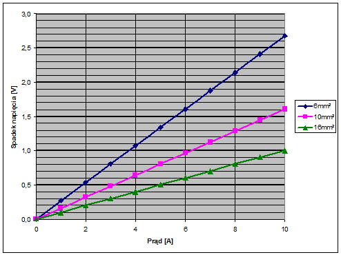

    luke666
    Posts: 2445
    Help: 182
    Rate: 119
    Here you have a graph of the voltage drop versus current value for three different wire cross-sections. Due to direct current, the total length of the cable on which the voltage drop occurs is 90 m.
