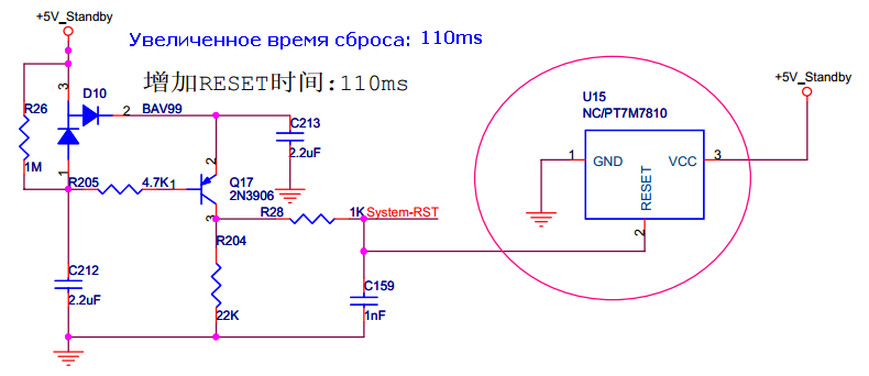

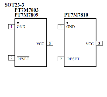

    Taki main Link_ssb:UE46C8000-BN94-02755B
    Sprawdz taki scalak opisany jako IC1014 (Microprocessor-Supervisors) z serii PT7M7xxx czyli po prostu układ RESET z "dodatkową funkcją nadzoru " (Watchdog functions)
    Monitoruje napięcia zasilania procka .
    http://www.dz863.com/datasheet-826589563-PT7M7803_Microprocessor-Supervisors/
    Microprocessor family PT7M7xxx (microprocessor) is the supervisory scheme aimed at increasing the reliability and accuracy of supply chain systems and microprocessors. These devices reduce the complexity and number of components required for control functions and battery.
    Main features are:
    1. Asserting reset output during power-up, power down, and brownout conditions for the system microprocessor;
    2. Detection of a power failure or low battery with 1.25 threshold detector;
    3. Watchdog function;
    4. Manual reset.
    Zależnie od literki na case nadzoruja rózne nap. od 4.36 (L) - 2.20V (Y)
    Są dwie wer. z ujemn. oraz dodatnim wyj. sygnału
    -lewa fotka z Ujemnym
    SAMSUNG UE46C8000 LED/SMART TV - Frequent Freezing and Red LED Blinking Issues
    Przykład włączenia

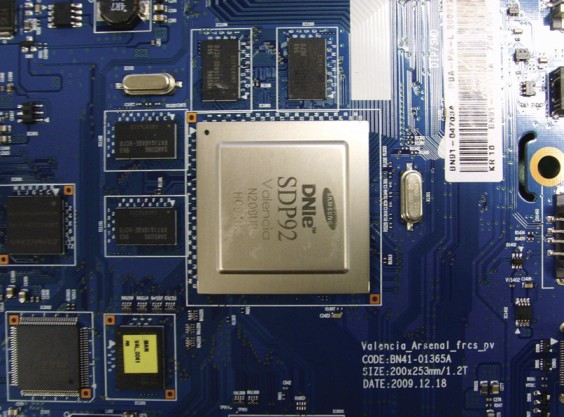

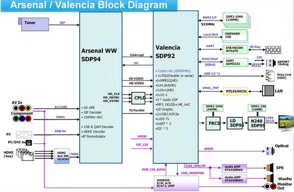

    on the BGA chipaxch described as SDP92 mainproc./ SDP94 videoproc.
    No data about them.
    It is known only from the diagram and photo. below what he is responsible for
    SDP95 and SDP96 ---- Luna = SDP95 240Hz, and SDP96 for Local Dimming
