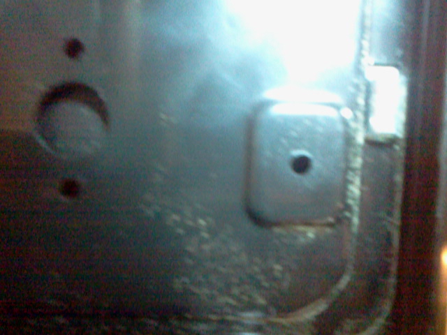

    I need to replace the thermostat in the oven, and to remove it I need to dismantle the glass cover.
    The problem is that it is attached with latches and I am afraid to force it.
    Maybe one of my colleagues knows how to disassemble it and will give you some advice.

    I don`t know what exact model you have, but the latches look similar to those in my oven (it`s hard to tell from these photos)... try to squeeze the latch lightly with a pair of pliers and push it forward... it should pop out nicely without using much force.

    The only thing is that the glass won`t break when I push out, for example, the first latch.
    The plate has five latches and the glass is not flexible.

    I have the EBP8752 model and it also has glass and 5 latches all over it... after removing the first one, the rest may deflect a little... the latches are glued to the glass so they work a bit... of course, don`t overdo it with pushing it out because if you squeeze it it will pop off a little... you start from the extreme corner (preferably the bottom corner because you probably don`t have a latch in the middle), then the next latch above it, then the middle one and the latches from the other corner... I`ve already pulled it out several times and everything it`s OK, nothing broke... I don`t encourage you to disassemble it, you do everything at your own risk, but if you don`t feel up to it, you`ll probably have to call a service technician... I don`t know what model of oven you have, but is it really necessary to remove the glass? for this exchange? In my case there is only a touch panel under the glass... of course, if you have any knobs on the outside, it is a good idea to remove them before removing the glass.
