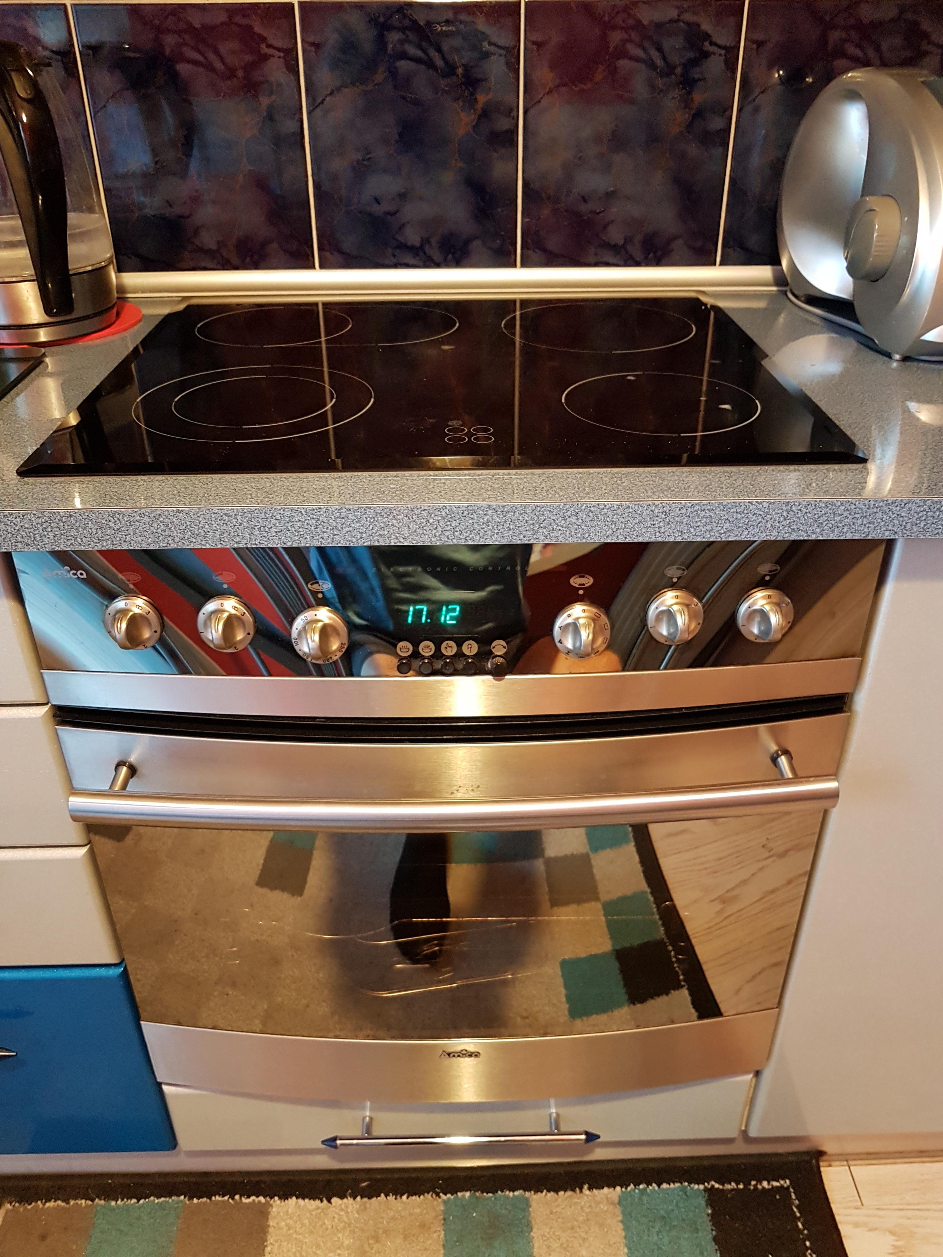

    In an Amica cooker from 2002 with an electric ceramic hob with the symbol EHbk 2.8. Those with an electronic programmer with a thermosensor do not work the lower right heating field. How to lift the plate to see what happened or possibly replace the field right away
    • How to Lift & Replace Lower Right Heating Field on 2002 Amica Cooker (EHbk 2.8) with Ceramic Hob 1507475574916725812465.jpg (1.21 MB) You must be logged in to download this attachment.

    Just pry by inserting something narrow between the plate and the table top, disconnect the sliders that control the fields, unscrew the plate, measure the field and replace it if damaged.
    At least I don't have any fasteners to unscrew anything from the bottom.
    Of course, I don't have to mention the disconnection of the voltage?

    Yes, maybe carefully. Because if there are fasteners from the bottom of the tabletop, it's not very undermined. You have to pull out the oven and check if there is none, it is mounted on silicone.

    Amica provides its hobs with a set of 4 latches attached to the worktop and, of course, the hob has a glued gasket. Levering from above is unacceptable - the plate can be chipped. You should first remove the oven and then push the plate out from the bottom (it should pop out of the latches) or properly disengage it from the latches, e.g. with a flat screwdriver.

    I found the instructions for this cooker under the plate, only some screws and brackets are shown that hold the plate unless it does not move. I don't see any other mounts. But I will take a photo of the drawing from the instructions, maybe someone will recognize if there are any fixings that prevent the plate from being lifted

    These brackets are the latches holding the plate, they are screwed to the edge of the cut-out hole in the tabletop. Usually the plate pops out of them when pushed from underneath (may require some force but feel).
