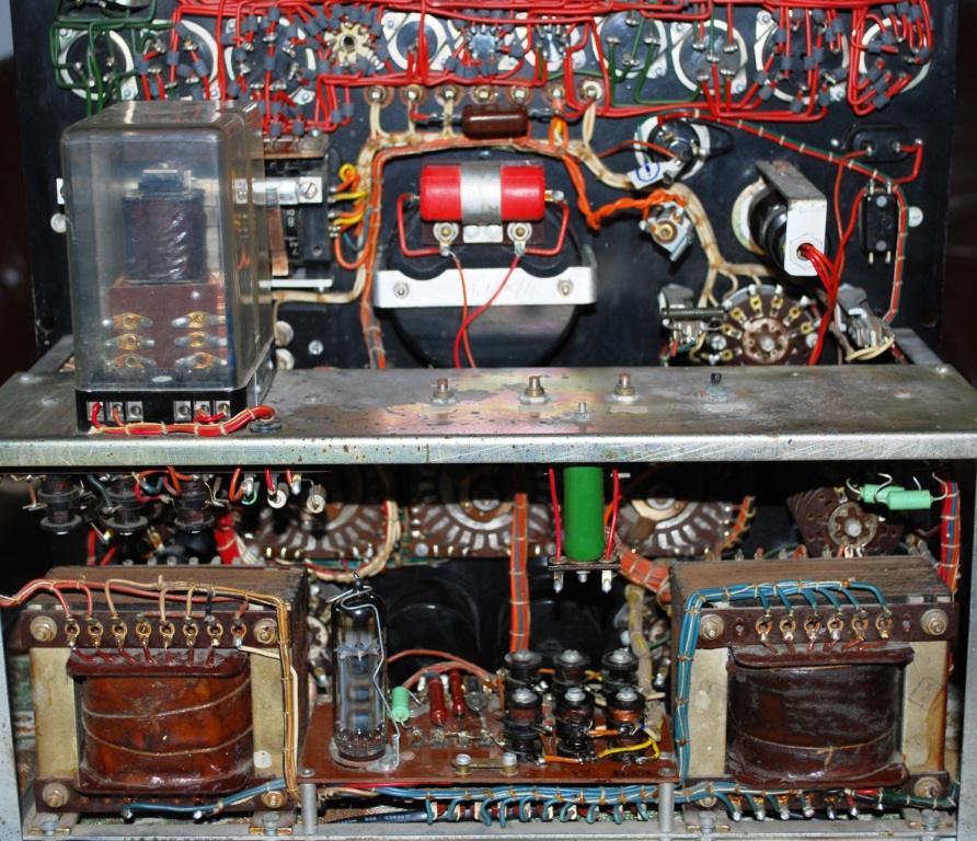

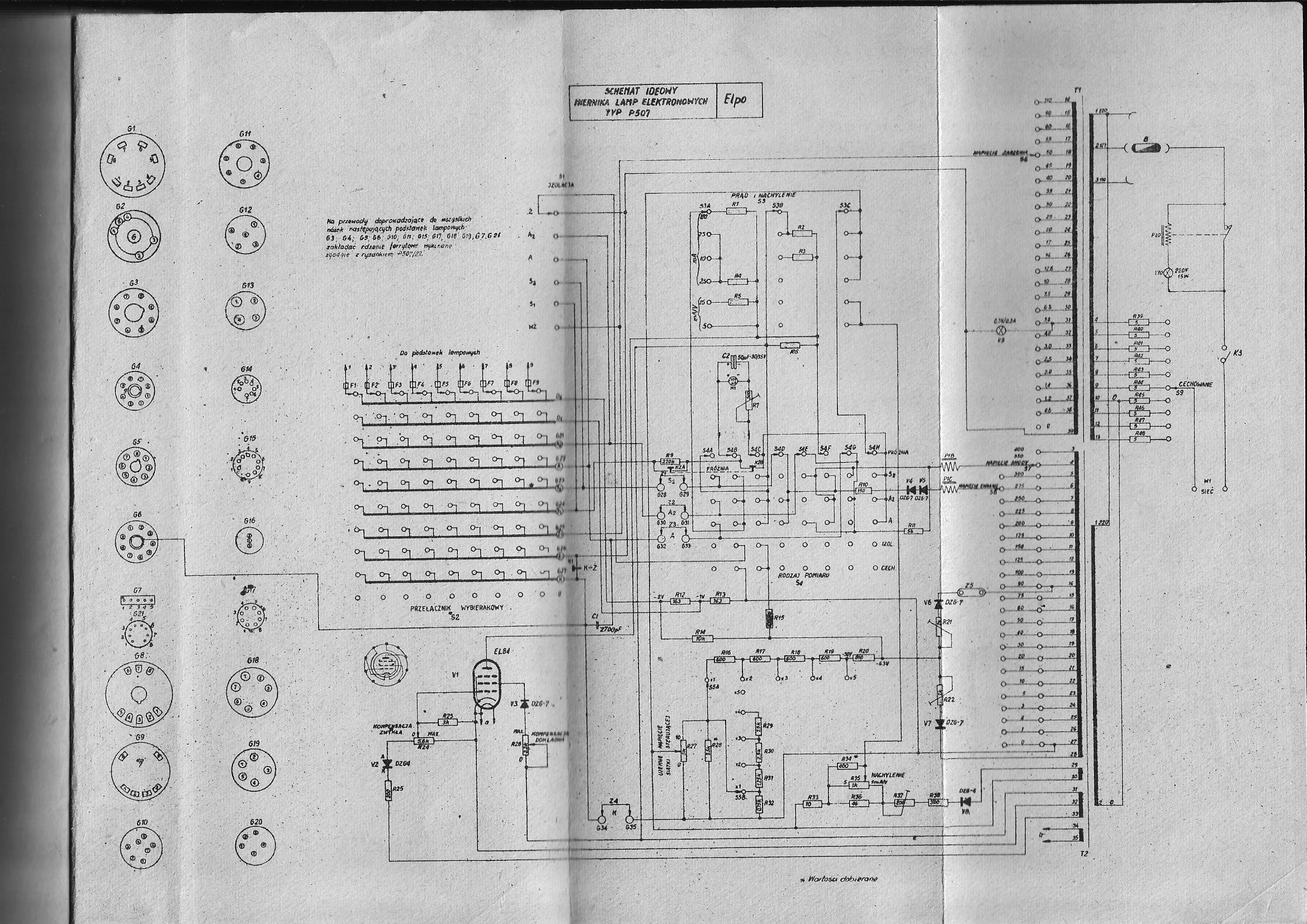

    With respect, if it is possible, please help me to get the Electronic Diagram for Valve Characteristic Meter Type P507 - Made in Poland (1963).
    I fixed some precision resistors made like in a coil (I found them interrupted) from slope divider circuit (x1, x2, x3, x4, x5), but I don't know the precision value for these.

    I hope this information is very helpful for me.
    I think my problem was R26, R27, R28, R29. These were interrupted and I restored them from remaining wire pieces, obtaining a smaller value than 600 ohms. Now I will put it o.k. for a precision measure.
    If there will appear any news about this instrument documentation, please notice me again. In the future I want to make a complete documentation.

    >>12273566 @TM85 do you have these documents still, please? I've got this equipment but without any papers. Thanks very much!

    zdenoeddie wrote:
    I have this equipment but without any documents
    See attachments.
    • Seeking Electronic Diagram for 1963 Polish Valve Characteristic Meter Type P507 P 507.jpg (925.68 KB) You must be logged in to download this attachment.
    • P-507 INSTRUKCJA.doc (140.5 KB) You must be logged in to download this attachment.

    #7 21297901
    zdenoeddie
    Cześć to everybody.
    Is it possible, that "current" relay can be faulty on P507 please?
    If I measure bigger tube (like 6L6, El34,...) when current goes over approx. 40-50mA device goes to faulty state (red bulb). But this current threshold is changing randomly.
    If I understand correctly circuitry, the anode (and G2) current is sensed by this "current sense" relay only (in P508 there is few more parts around).
    Thanks.
