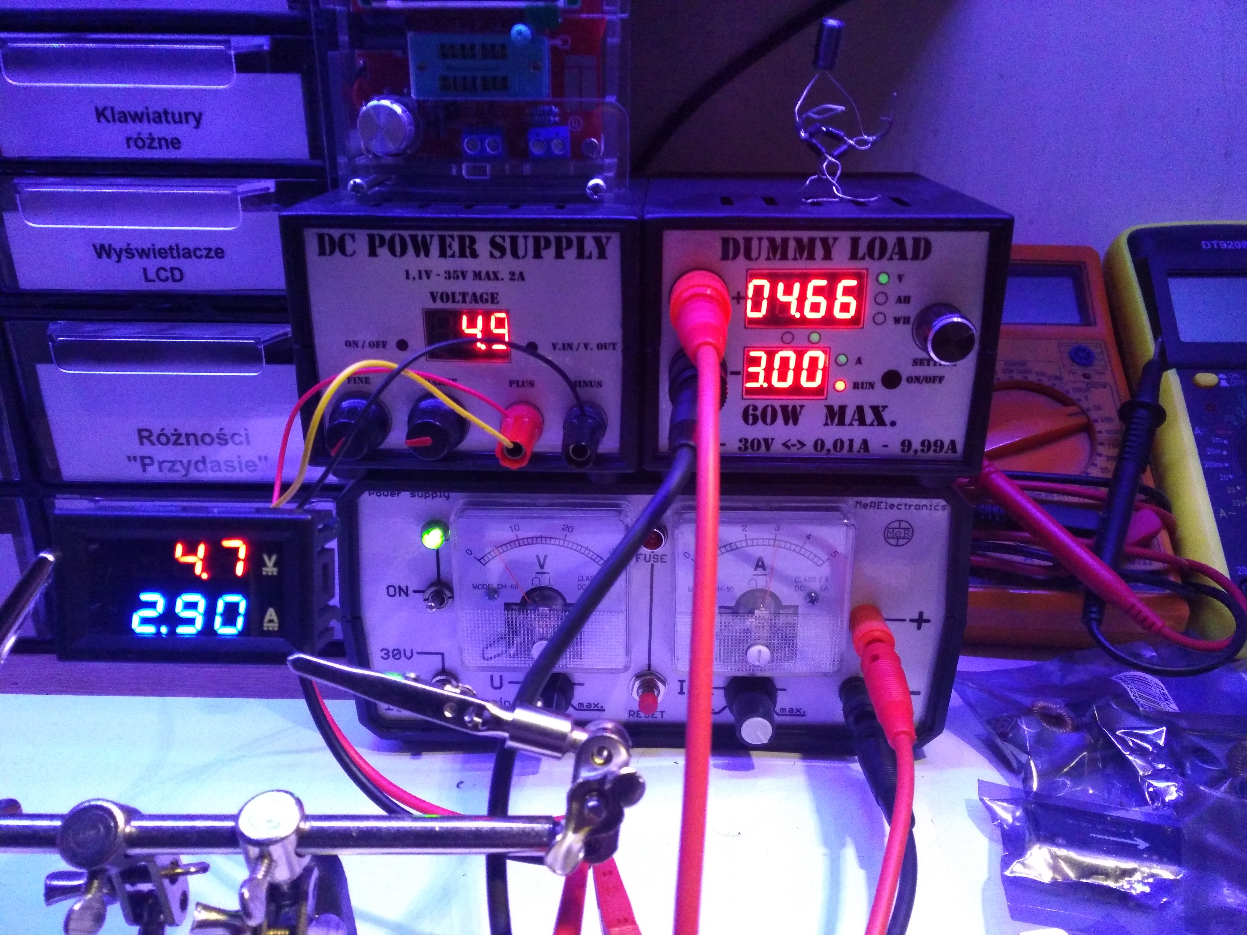

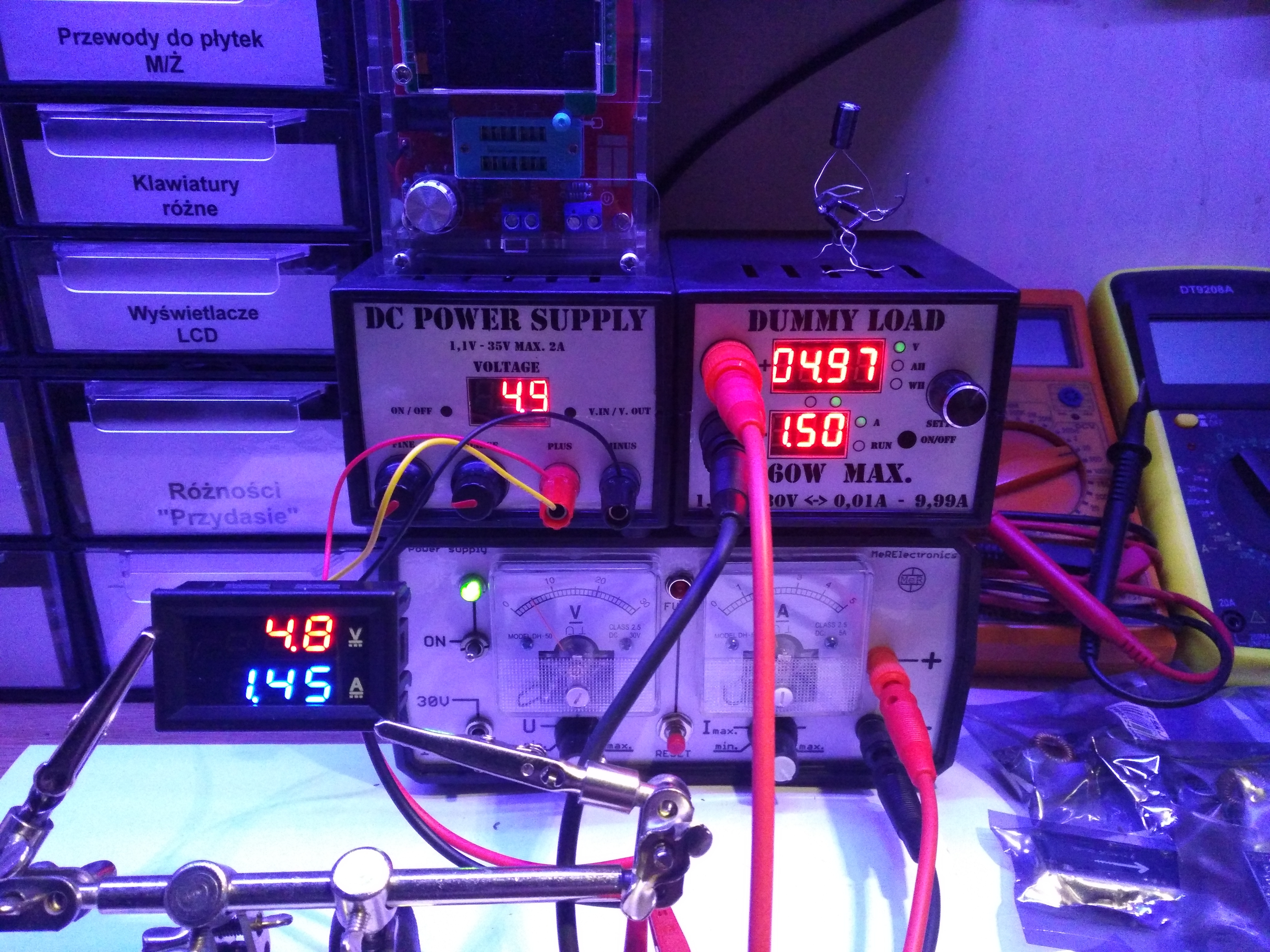

    3. The ammeter should indicate correctly in the range of 1-10A, which the seller clearly indicates and asks not to leave negative reviews due to inaccuracies in the range of less than one Ampere.
    The fact that the ammeter is already activated at 0.01A, but its indications in the range of up to one Ampere do not match the "real" ammeter. However, in the case of my copy, the indications above one Ampere were also not very accurate.
    Digital panel meter - Voltmeter / Ammeter - made in China. Digital panel meter - Voltmeter / Ammeter - made in China. Digital panel meter - Voltmeter / Ammeter - made in China.
    Sequentially 200mA; 250mA and 300mA. As you can see, it lies on average by 20mA
    Now 500mA; 750mA and 1000mA. We can see that it distorts even more, because in the first two cases by 0.03A and in the last one even by 0.04A.
    As you can see, at higher currents it is better, but still not very precise.
    It's just that this is the state after taking it out of the package, and yet we have two tiny "peers" for REGULATION.
    After that, it turns out that in the lower ranges it can be quite accurate
