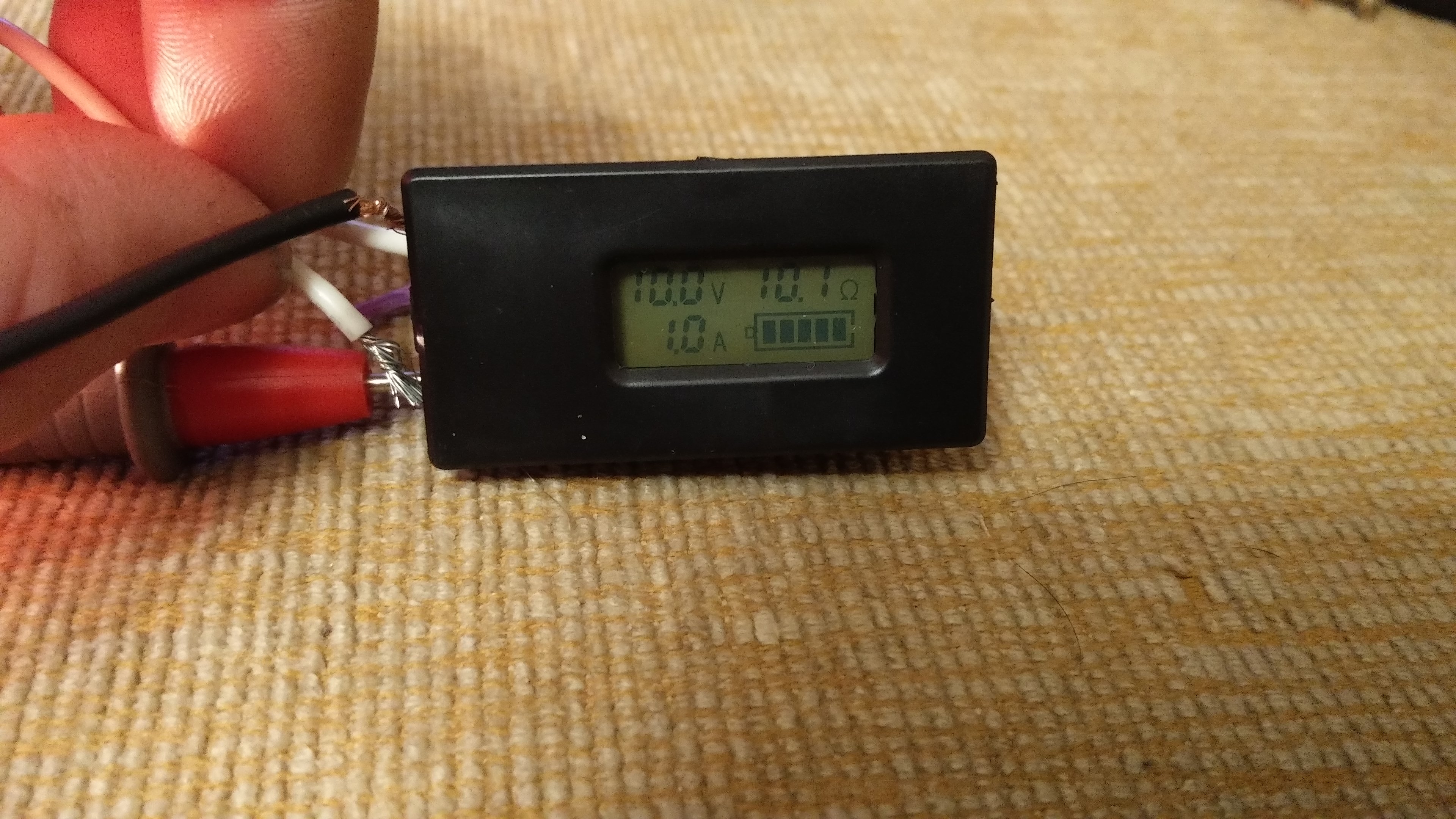

    Normally, after connecting the power supply, the indicator is not illuminated and consumes at 12V about 65uA. After switching on the backlight, the power consumption increases to 480uA.
    Panel meter. Voltmeter, ammeter etc.
    This is what it looks like without backlight,
    And so with.

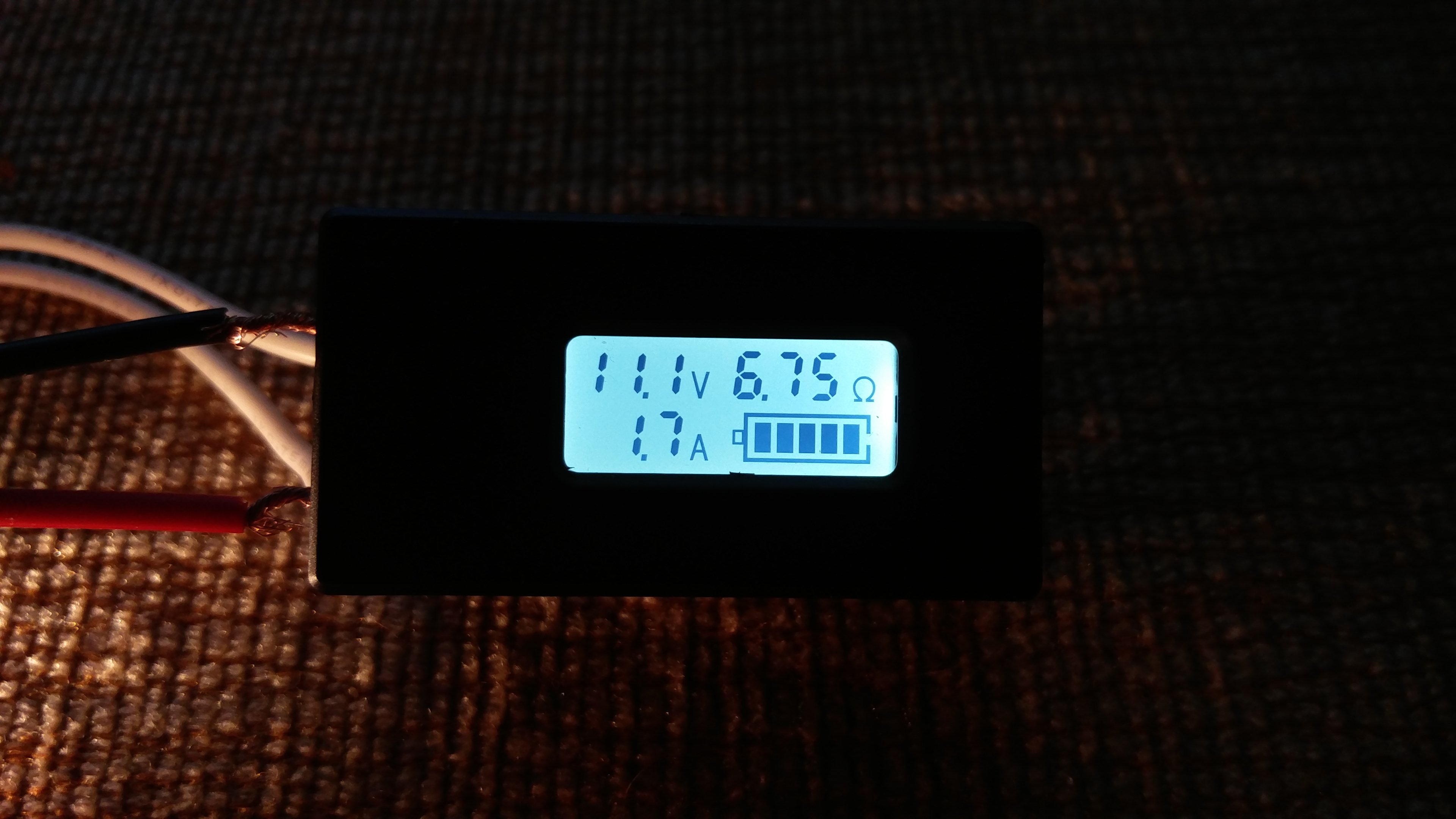

    To turn on the backlight, just press the set button briefly.
    As you can see, the screen is divided into 4 parts. We have a quite accurate voltmeter and ammeter for this resistance measurement and a five-position indicator of the remaining amount of energy in the battery. Which is freely customizable.
    After pressing the set button for three seconds, you can set the voltage at which the indicator shows the discharged battery and at which it is charged.
    Panel meter. Voltmeter, ammeter etc. Panel meter. Voltmeter, ammeter etc.
    So it can be adapted to each cell and battery pack. Of course, in the measuring range.

    I wonder what the parameters of such a miracle really look like ..
    I would argue with that 2% accuracy
    I also read at the auction:
    Resolution: when the resistance is less than 10 ?, the resolution is 0.01 ?
    There are also stun guns on ali that have 7 million volts
    So these parameters must be taken with a pinch of salt
  • #9 17048215
    kkknc
    Posts: 23753
    Help: 1915
    Rate: 6706
    It is sometimes the spread of a given series or range. I did the measurements with a separate meter quite well. At this resolution, the measurement is rounded, but correct. So there is nothing to pick on about this copy.
