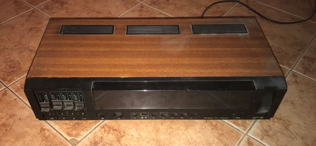

    Here I will present another popular piece of equipment from the communist era - the Amator radio, or more precisely the 2B version (DSS201). The Amator 2B differs from the Amator 2 in that it has no tuning indicator.
    Amator 2 allowed the reception of long wave, medium wave, short wave and FM frequency ranges. The AM intermediate frequency was 465kHz and FM 10.7MHz. Details later in the diagram, and now pictures.

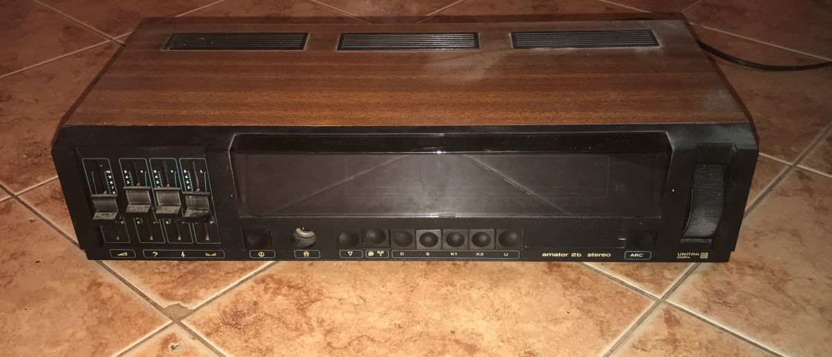

    Front and top with the characteristic three vent inserts:

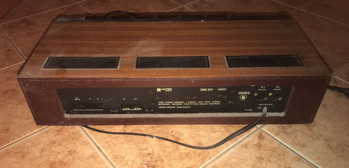

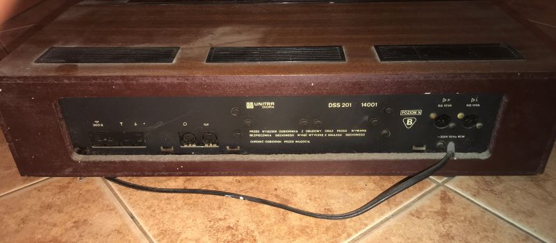

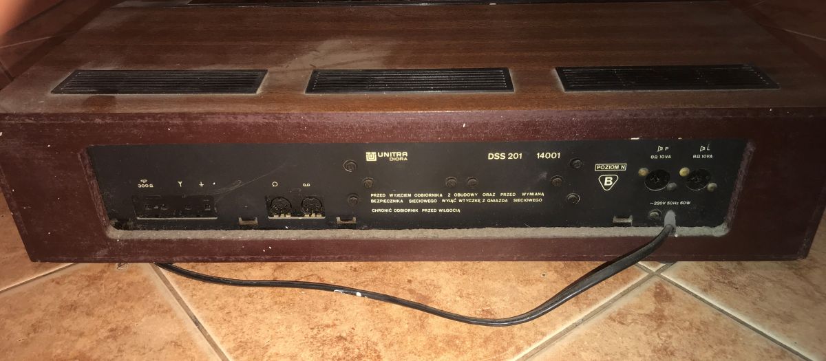

    Rear:
    Old Polish radio Amator 2B stereo (DSS201) - schematic diagram, gallery Old Polish radio Amator 2B stereo (DSS201) - schematic diagram, gallery .

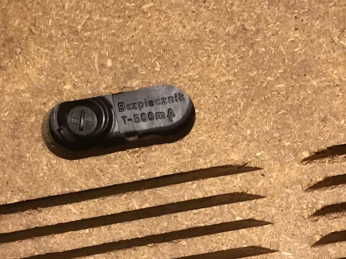

    It is also worth adding that there is a fuse hiding at the bottom of the case to be removed:

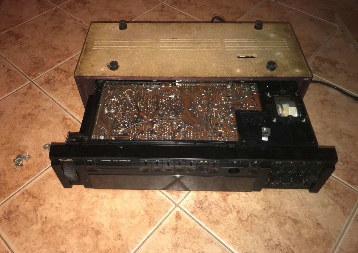

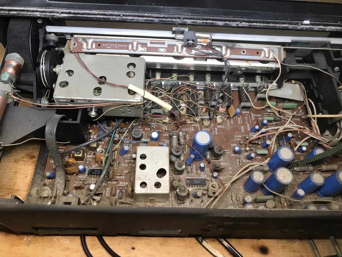

    Looking inside:

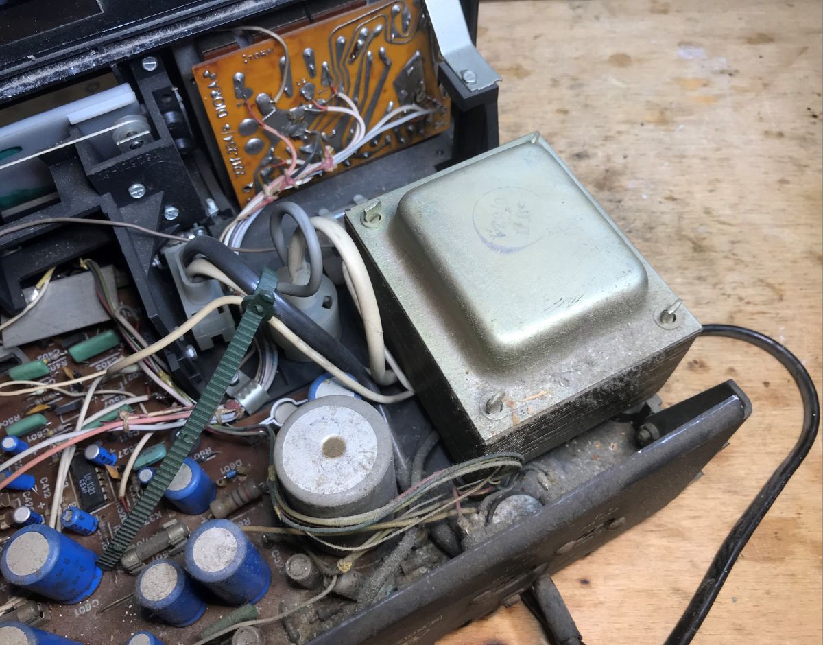

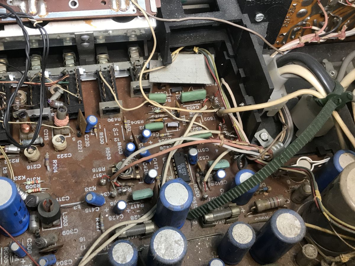

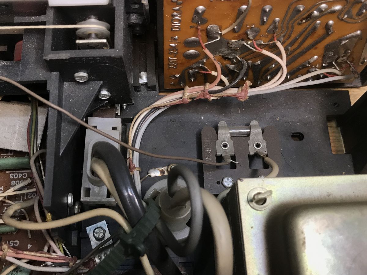

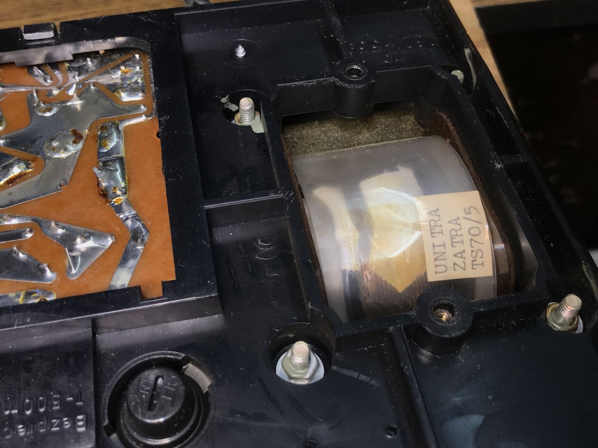

    Let's start perhaps with the power supply, of course there is a 50Hz mains transformer:
    You can see the fuse and the separate PCB from the slide potentiometers:

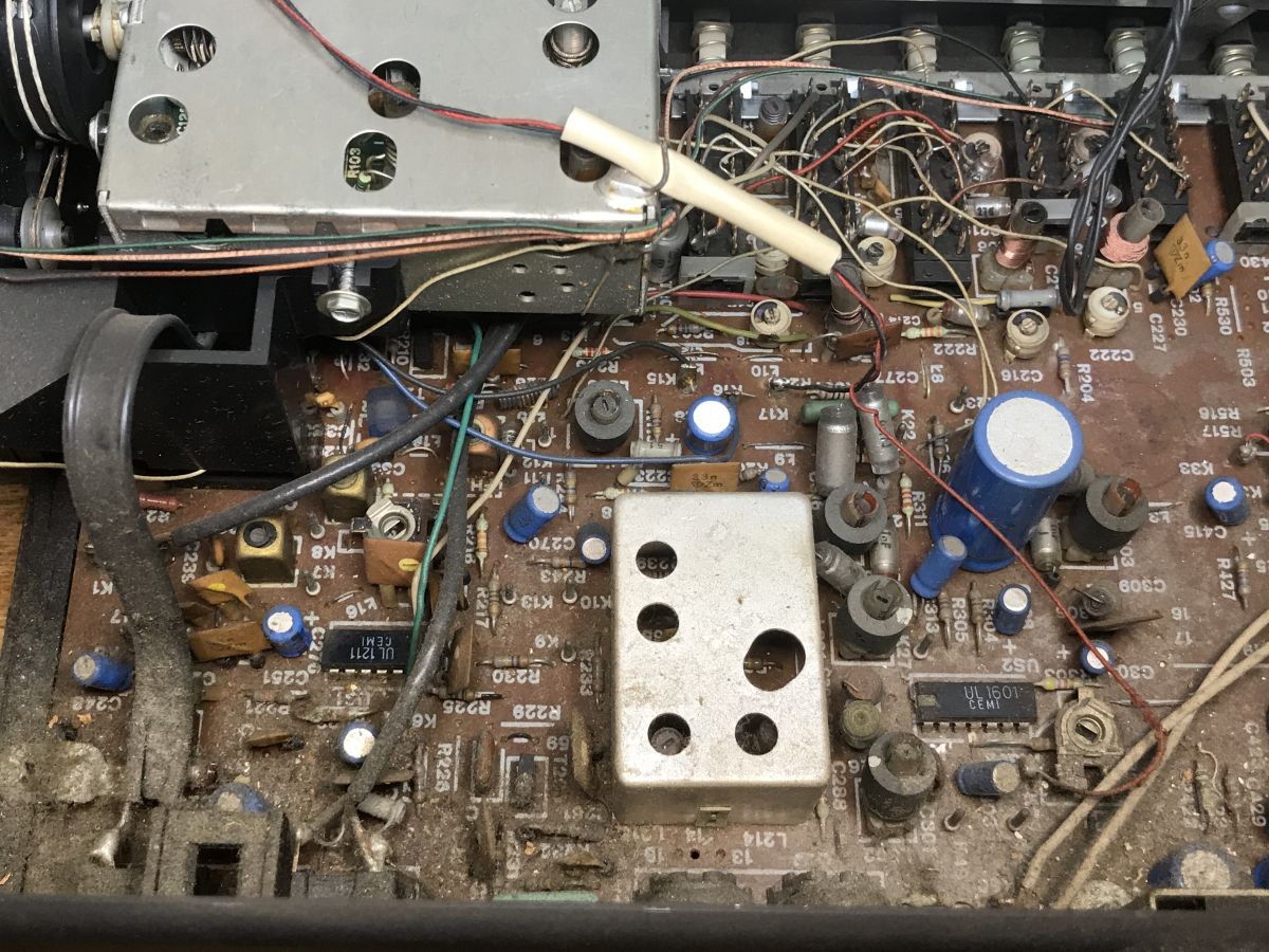

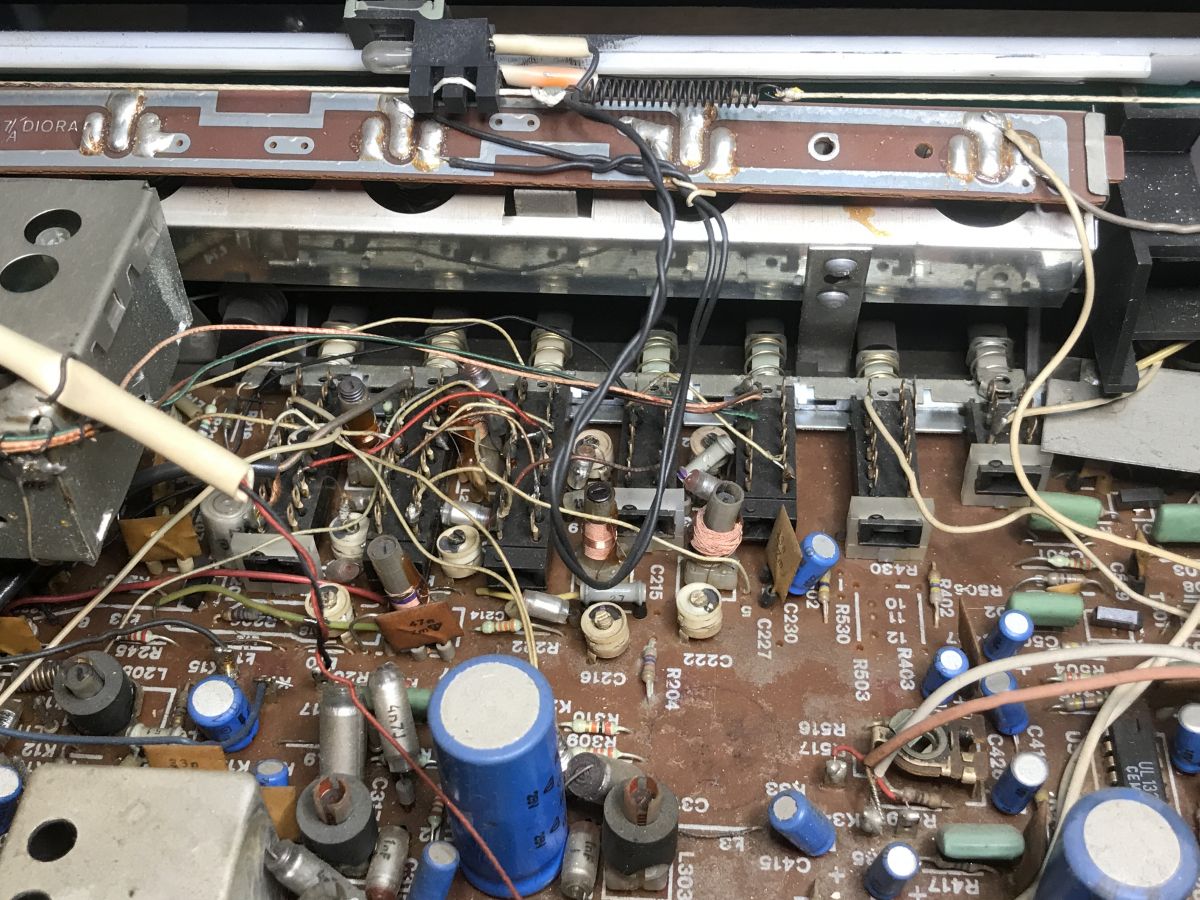

    PCB, isostat type buttons, tuning scale;
    Old Polish radio Amator 2B stereo (DSS201) - schematic diagram, gallery Old Polish radio Amator 2B stereo (DSS201) - schematic diagram, gallery Old Polish radio Amator 2B stereo (DSS201) - schematic diagram, gallery Old Polish radio Amator 2B stereo (DSS201) - schematic diagram, gallery Old Polish radio Amator 2B stereo (DSS201) - schematic diagram, gallery .
    CEMI, UL1321, UL1601, UL1211 circuits can be seen.

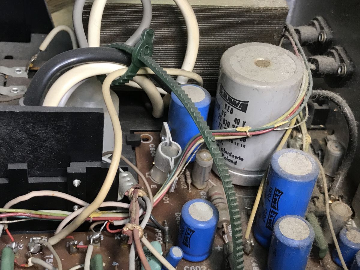

    Elwa electrolytic capacitors:

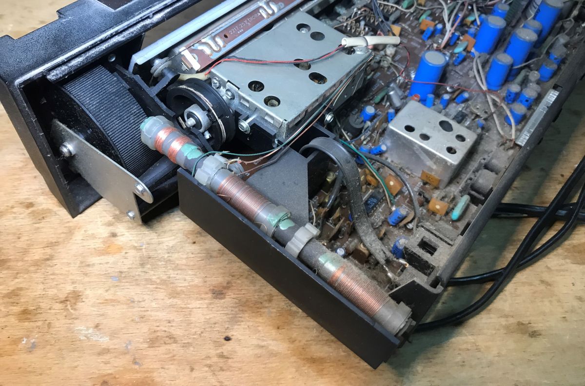

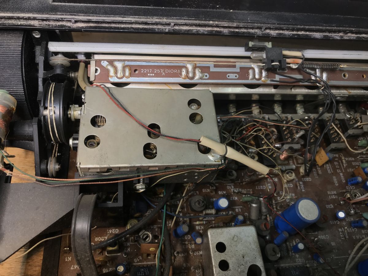

    Tuning mechanism and bulb (incandescent, not LED) from backlight:
    I really like the tuning mechanisms on these types of old radios. This is probably because I grew up with much newer equipment. Here you can see how the bulb is fixed:

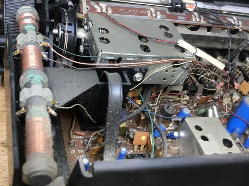

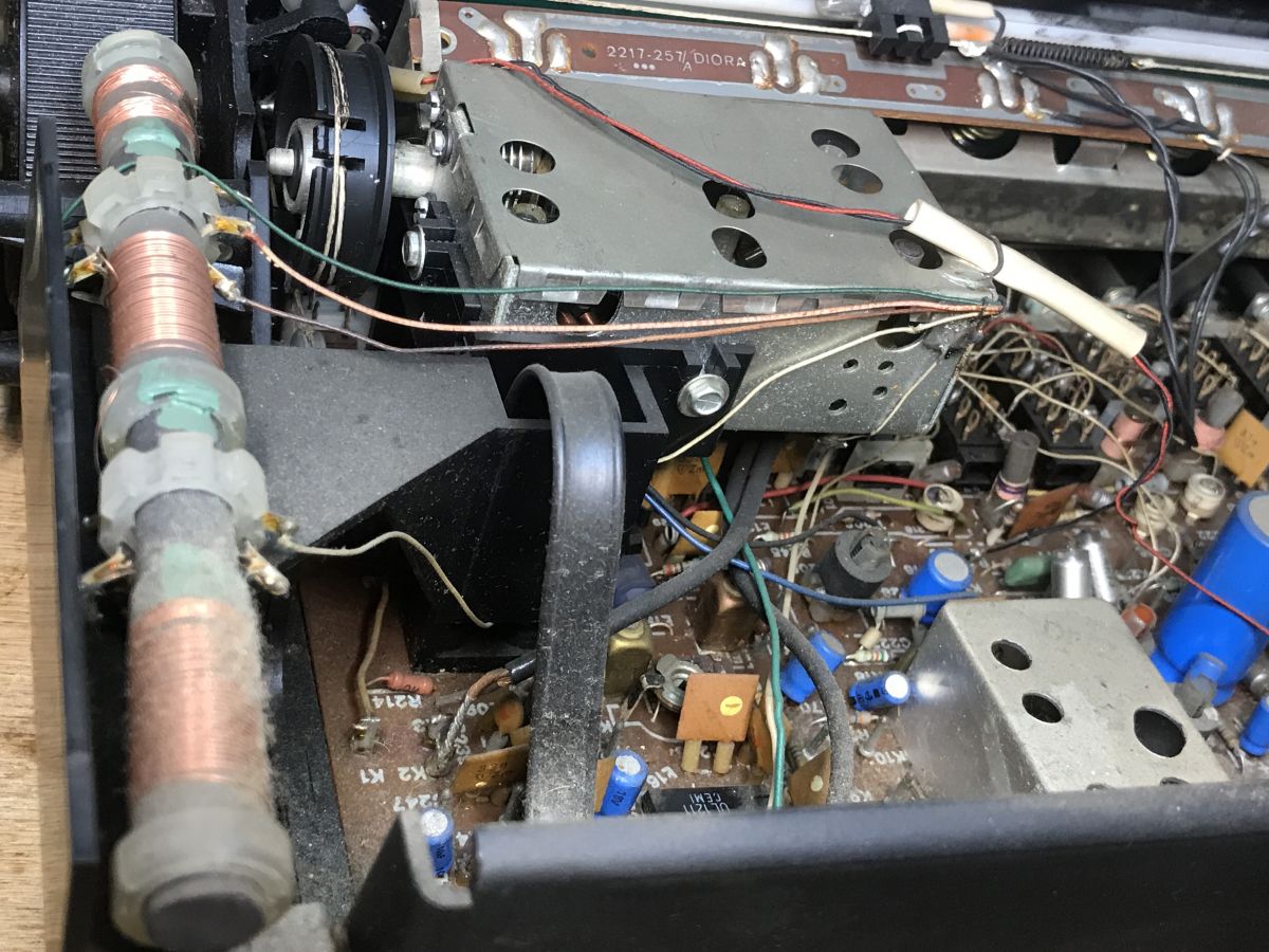

    Ferrite antenna:

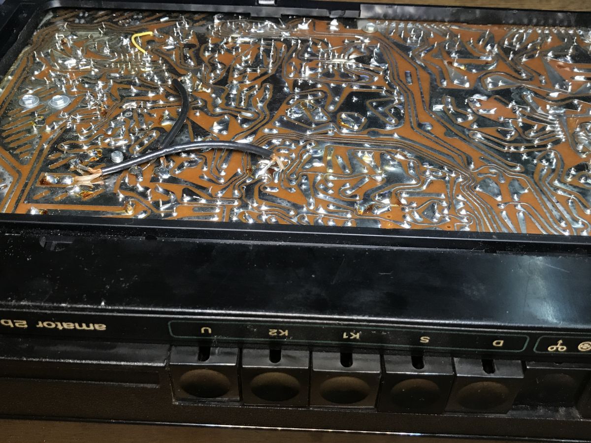

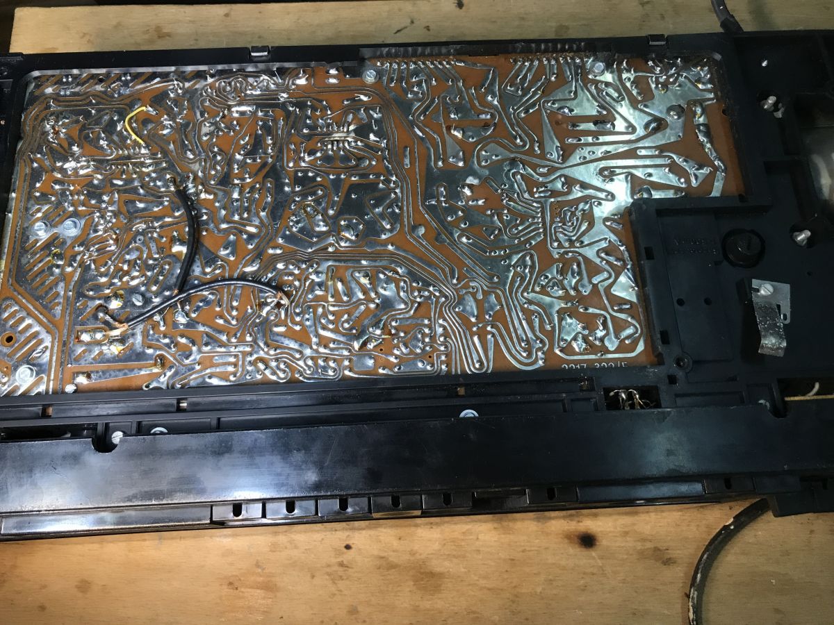

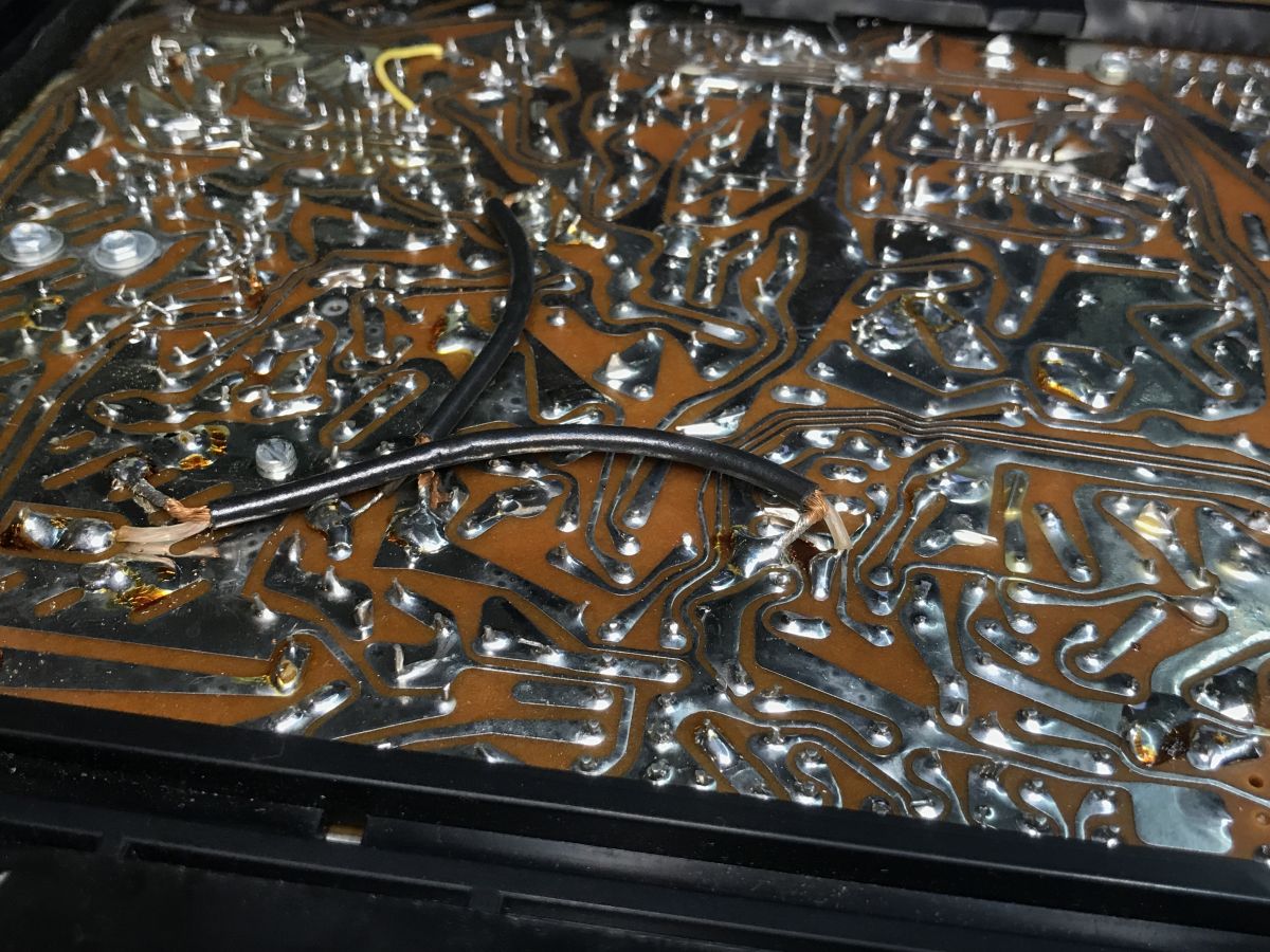

    PCB underside:

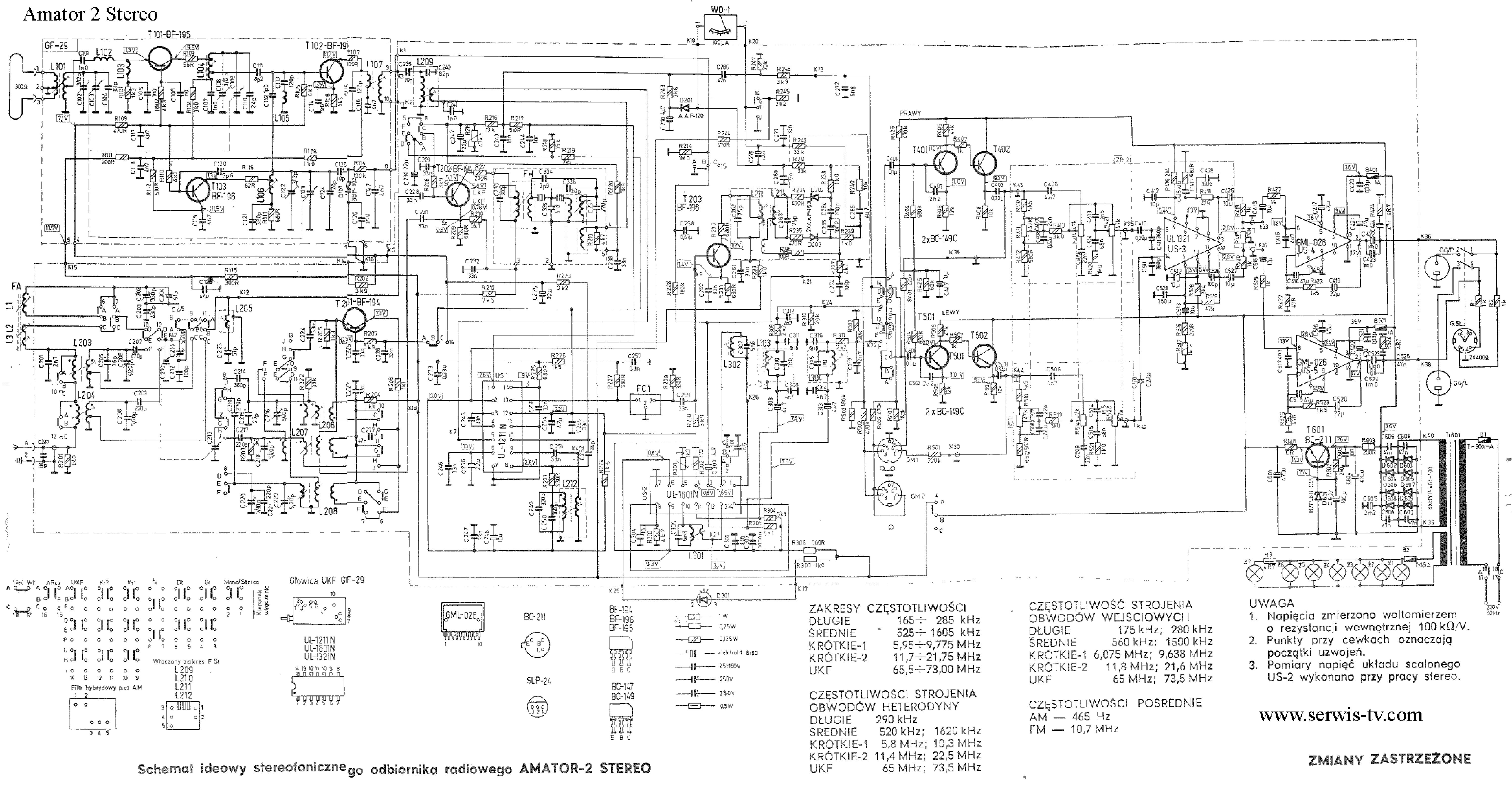

    However, photos can't show everything. It's time for a bit of documentation.
    Schematic of the Amator 2 stereo:

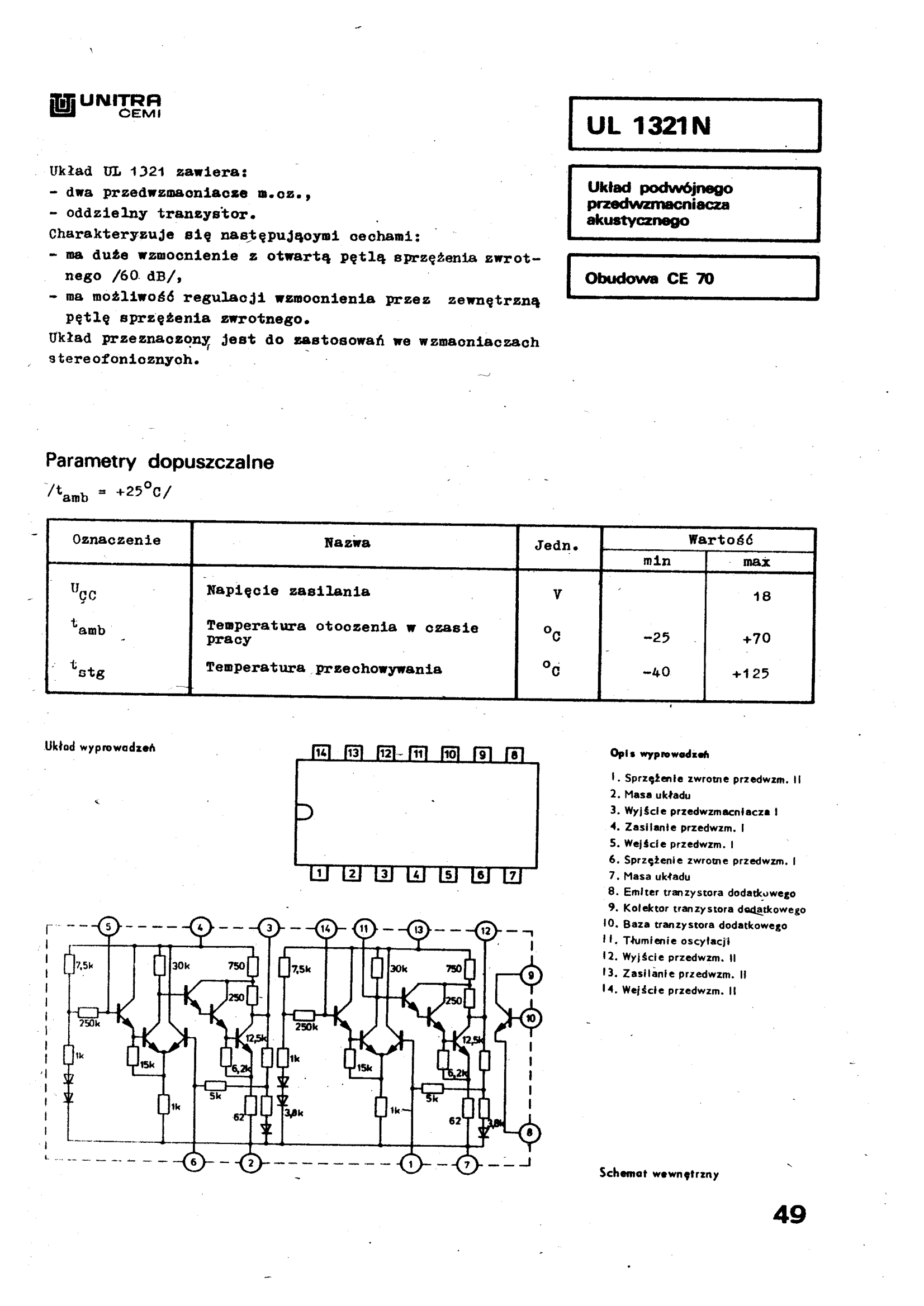

    UL1321 (dual acoustic preamplifier circuit):

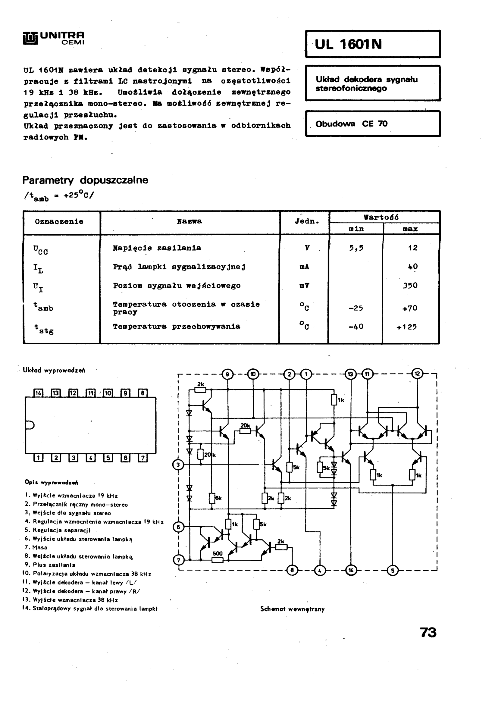

    UL1601 (stereo signal decoder circuit):

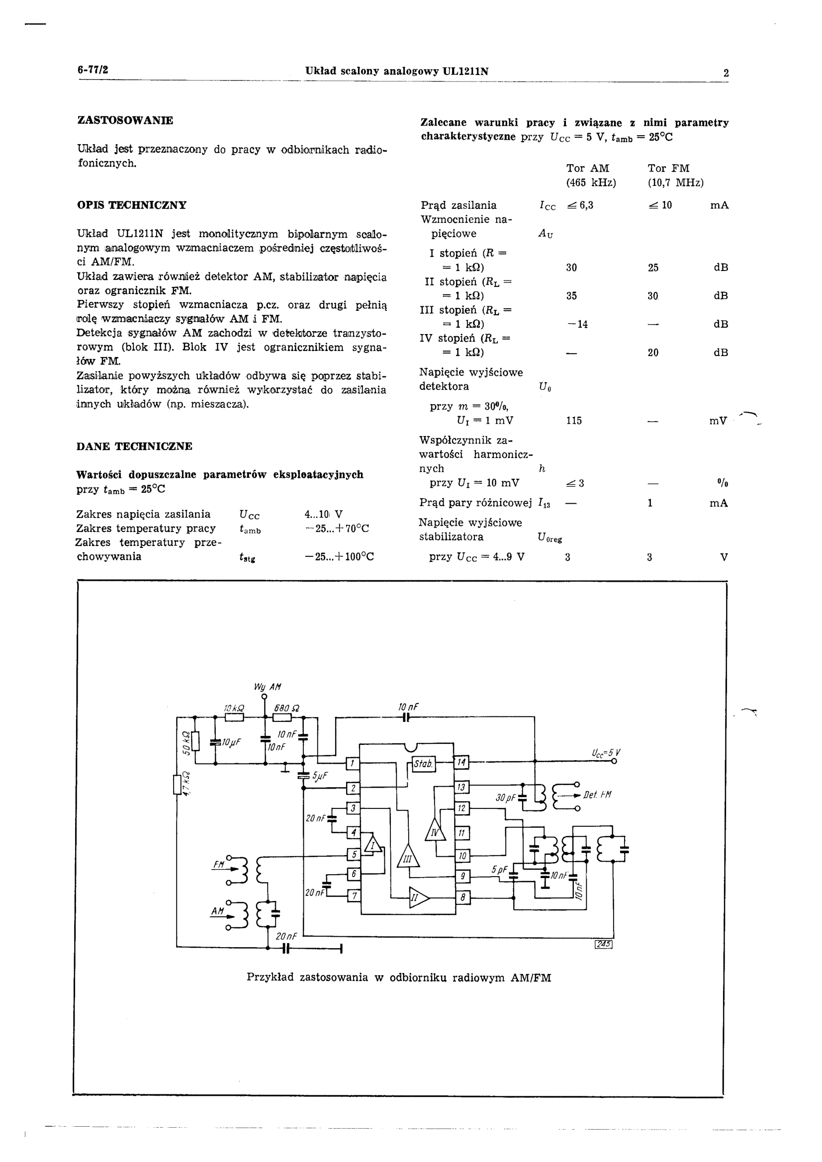

    UL1211 (AM/FM intermediate frequency amplifier):

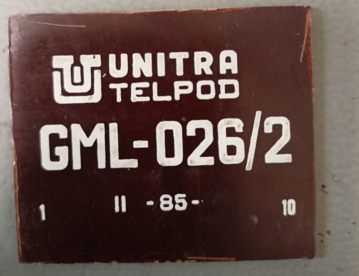

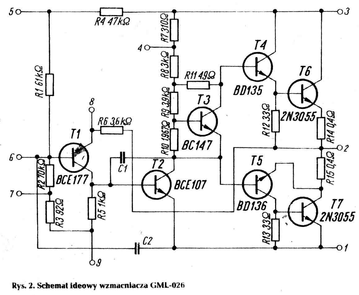

    The power amplifier is based on two GML-026s. GML-026 schematic:

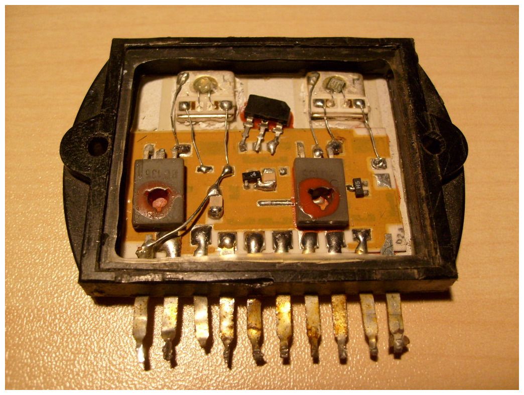

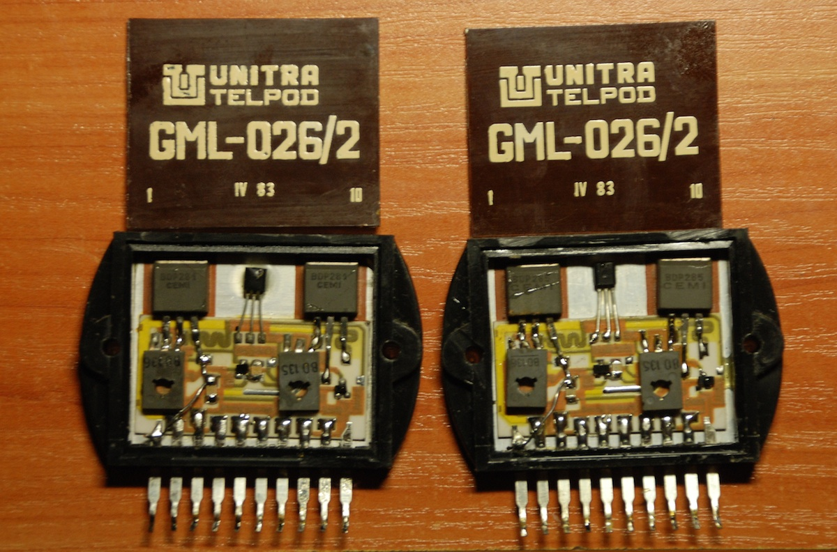

    By the way, I see now that I didn't take a photo of them, you can only see their legs in the PCB photo, so I'll use a photo from another topic:
    The photos above show a slightly different circuit, GML-026/2, but I was unable to find GML-026.

    Where are the 2N3055 transistors from on the schematic of this GML?

    The colleague is confusing concepts.
    First of all: GML-026 and GML-026/2 are two different circuits.
    At the same time, the radio presented appears to have a factory-installed GML-026/2.
    It is impossible not to mention at the occasion of this discussion the fact that there are two variants of GML-026/2, with standard transistors mounted inside and with the structures themselves mounted inside and for this a different transistor model.

    Indeed, the photo in the linked thread shows GML-026/2 and not GML-026. When I get a chance I will take a correct photo, unless anyone has one to hand?

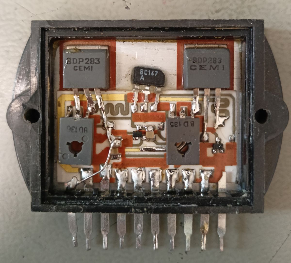

    These are 2N3055 structures bought with the then valuable foreign exchange, hence the later switch to locally produced power transistors,
    Please, and a beautiful description of 'our' ceramic hybrid:
    http://qann.wikidot.com/hybryd-gml

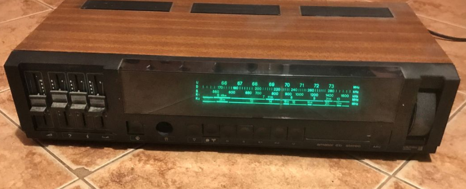

    this article came to me perfectly here ;p I no longer need to dismantle what I have to look inside out of curiosity :-)
    Some time ago I told my neighbour that if she had any old electronic equipment to throw away, she could give it to me for parts instead of going to the PSZOK. By old, I mean late 1990s and upwards. How surprised I was when she gave me an Amateur 2 radio last week....
    To be honest, I'm wondering what to do with it - for parts it's "too old" and on the other hand I realise it's such a collector's classic and it's probably a shame to throw it away. Apparently there's one taker for it already, but I'm not hearing from him.
    Out of curiosity, I plugged the radio into the speaker and all I can hear is a hum. And all in all, no wonder, because the radio is probably not tuned (old FM range). In addition, the frequency change knob doesn't have a full range of movement - something must have mechanically shifted inside, probably this string is to be rewound/corrected.

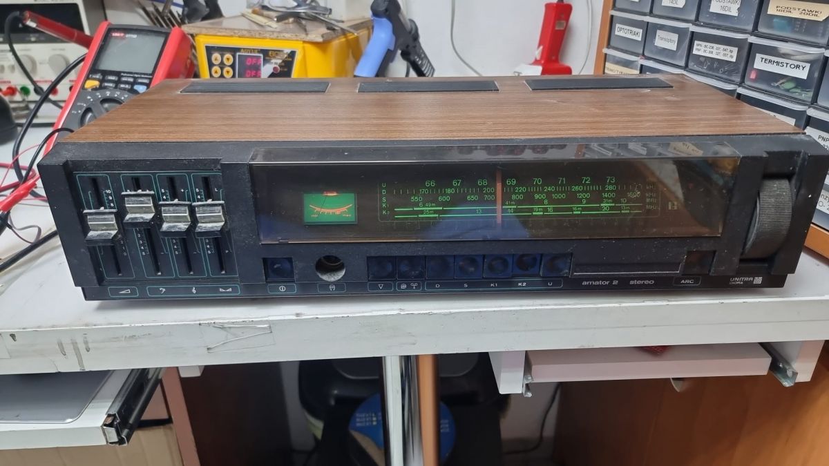

    @MarekS6 don't throw it away because it's a shame. A little work and patience and it will play and be a pleasure to the eye.
    And I found something like this and a vintage one in my stash.
    But functionally they are identical and can be used interchangeably.

    The Amateur 2B differs from the Amateur 2 in that it has no tuning indicator.
    There is also a difference in the schematic, as the preamp is made with only one transistor + UL1321.

They are associated with certain GML versions because some modules used 2N3055 structures inside the ceramic hybrid. One poster says those structures were bought with scarce foreign exchange, while another counters that 2N3055 was also produced by Tungsram and Tesla and later matched domestically by CEMI with BDP620. The key point is that the 2N3055 reference belongs to specific internal GML constructions, not to every module equally. [#21072606]
How do GML-026 and GML-026/2 differ, and which one was actually factory-fitted in some Amator receivers?
GML-026 and GML-026/2 are different circuits, not two names for the same part. A correction in the thread says the linked photo actually showed GML-026/2, and that the presented radio appears to have factory-installed GML-026/2. The same comment adds an edge case: GML-026/2 itself existed in two internal variants. [#21072021]
When replacing a failed output module in an Amator, how do GML-026 and GML-026/2 compare in practical interchangeability?
They are not identical internally, but one commenter says they are functionally identical and can be used interchangeably in practice. That makes them a service substitute, not a schematic match. Use that interchangeability for repair decisions, but keep the earlier warning in mind that the circuits themselves differ. [#21073125]

How hard is it to retune an Amator 2B from the old OIRT FM band to the current FM band, and which stages usually need adjustment?
The thread does not describe a retuning procedure, but it does show why retuning matters: one owner heard only hum and noted the radio was “probably not tuned” because it used the old FM range. In this discussion, the practical first step is to confirm band compatibility before blaming major faults. No specific adjustable stages are named here. [#21072611]
