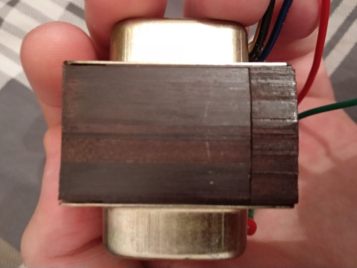

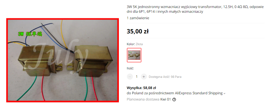

    90-a pair of zlotys for two transformers? I take.
    Here's what these transformers look like in real life
    Budget PCL82 stereo tube amplifier
    There is a gap, the performance is so-so, but we won't complain, after all, it is supposed to be a budget amplifier, not an audiophile's dream. Primary resistance approx. 500 ?.
    By the way, I will notice that by connecting the 8? loudspeaker to the 4? tap, we get a load impedance of 10k?, which allows the use of very cheap and easily available PCL84 (or any lower power tube) in audio applications (for PCL84 such "atypical" load impedances were used, if you believe the catalog who described such a use).

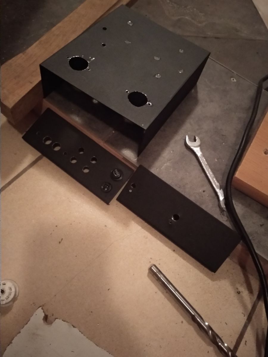

    As a housing I bought an ELGIG E145 with dimensions of 50mmx140mmx160mm (height, width, length). It cost me PLN 21.

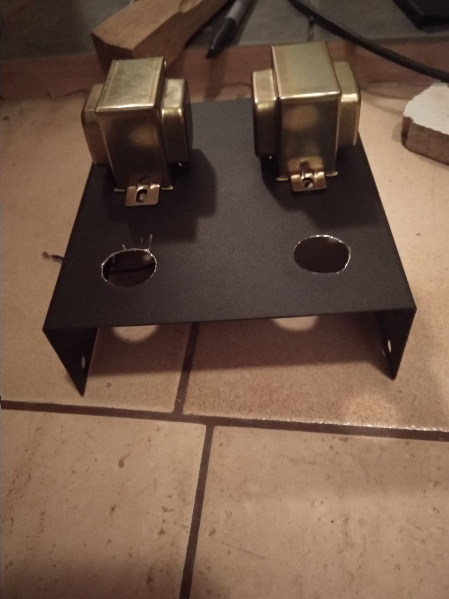

    First thing, cutting holes for lamps and fixing transformers.
    Cutting holes with a dremel is average, he slipped and made a scratch, difficult, it is right behind the lamp so not very visible. In the future I will buy a larger diameter conical drill for making holes for lamps.
    Then drilling holes in the panels for banana connectors for speakers and phono sockets.
    Passing OK

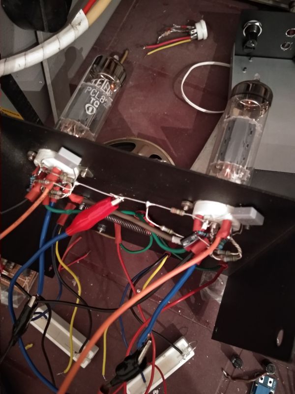

    Did you leave these wires for measurements soldered to the resistor in the power supply? It doesn't look very good.
    And I still have doubts about this spring. I understand that she has to fasten everything mechanically. And is it not too close to the output of this electrolyte? You are not afraid of short circuits.
    And .. do you have PE on the housing?
    The wires were cut as I had already established the primary current.
    As far as I remember, there are 4 resistors of 3.92 ? in parallel.
    The spring is a mechanical fastening, although it is not the only one that holds the resistor, because the copper wire itself is mounted in an eyelet connector screwed to the housing.
    This wire is at the same potential as the spring, i.e. at the ground potential. It is simply a ground point where the signal ground and the cathode and mesh resistors are connected. The incandescence is carried out separately because the series resistor is on the ground side.
    The electrolyte, as you can see, the minus has an open, because why insulate something that has nothing to short-circuit, while the plus of the capacitor, where we have about 170V, has a stretched heat-shrinkable tube so that there is no short circuit.
    There is no PE, the three-core cable did not fit into the factory passage through the housing. At most, I can add a housing ground terminal and a third PE conductor attached parallel to the current two-wire.
    The mains potential cables are double insulated, each has a stretched heat shrink tube, the power supply is mechanically mounted on distances and I took care of decent separation gaps between the paths from the mounting points to the housing.
    Nevertheless, I like the current state on average and I intend to design this power supply from scratch so that it is on one laminate (currently 3) and has stabilization of the filament current.

    You figured it out very sparingly (I'm wondering if not too much), but the effect is quite complete. (Thought you might be a production accountant :) )
  • Mounting strip would be more secure than spring fastening

    pawelr98 wrote:
    the spring is only a mechanical fastening
    "1001 patents for the use of a spring". Yours is 1002 a patent. Haven't heard about mounting strips? You could even make one yourself on your knee (a strip of laminate with cuts every 0.5 cm for soldering the tips plus two 3.2 mm holes for screws. The mounting was more secure, and the aesthetics would also gain a bit.
    By the way - from what I can see (?) The spring is sticking to the screw threads. Have you thought where it will fall as it will fall from this thread? From practice and Murphy's Law it follows that where he does the most damage.

    Olkus wrote:
    Everything is nice, the only thing you could find fault with are unshielded cables
    They are not always needed, especially with high value signals of 1V and more.
    As for the driver tube, PCC85 or PCC88 (E88CC) double triodes can be used in amplifiers with P-series output tubes.
