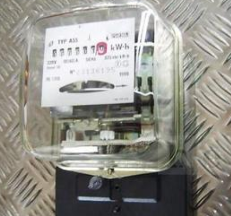

    I want to install a computer device at my friends that consumes about 200W of electricity. For billing, I would like to use a numerator like this:
    Connecting Single-Phase Sub-Meter for Billing: Wiring, Grounding & Installation Queries Connecting Single-Phase Sub-Meter for Billing: Wiring, Grounding & Installation Queries
    However, I would like to connect a plug to the L and N cable.
    My quick questions:
    1. It is enough that I connect the phase to L and zero to N, and where it is * I connect the cable to the computer device for which we want to settle?
    2. What about the ground wire (third)? I connect this one outside the meter?
    3. Do I have to somehow connect the ground wire (third) to the meter?
    4. Can I connect the meter via the above-mentioned contact plug?
    5. In case of reverse connection of the plug with such a meter, will the counter simply not work, - or if there is no protection, will it count down?
    6. Can the meter work horizontally - lying down, being screwed to the upper casing of the computer?

    1. Yes.
    2. Outside the counter.
    3. If there is no PE terminal, then no.
    4. Yes.
    5. L goes to the L terminal and N to the N terminal. If we reverse the plug, the counter will not work.
    6. The operating position symbol should be on the "white rectangle" on the front of the wattmeter where all markings are found.

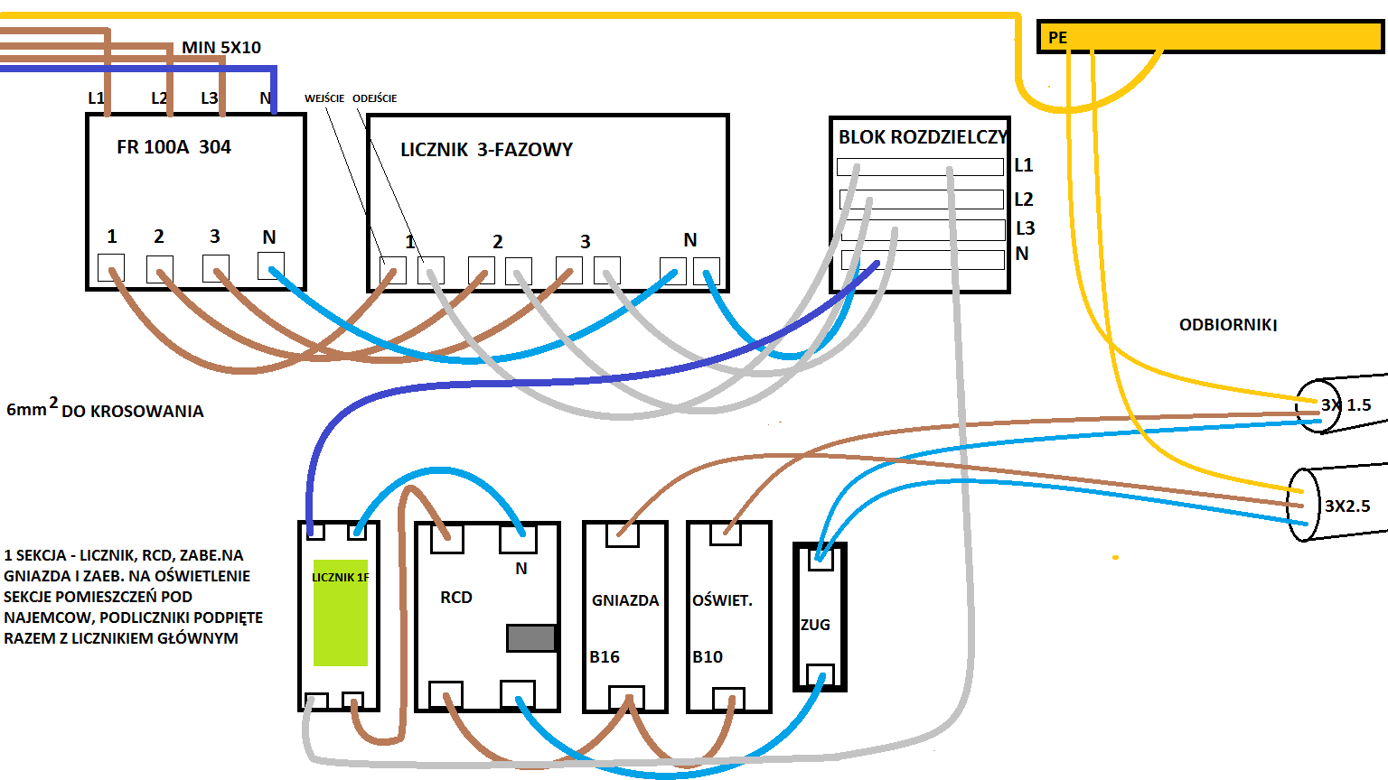

    Reprint mentioned.
    And he drew a strange "schematic" of a 1-phase counter.
    How is it supposed to work? If only he could mark entry-exit!
    Reversing plug does not stop meter; keep it vertical
    #8 12327403
    masonry
    Level 30  
    Posts: 2742
    Help: 106
    Rate: 832
    Buddy modrih, changing L from N (i.e. inverting the plug) does not change the direction of rotation of the dial, nor does it stop it.
    On the other hand, this counter will not count correctly in the horizontal position (if the disc is able to start moving in such a position at all, this is due to, among others, the disc axle bearing system used in the counter).
    It is very good that my colleague Elpapiotr quickly reacted to the nonsense written by his previous speaker.
