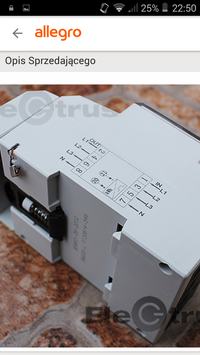

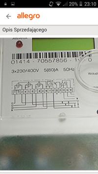

  • #9 15966682
    kojak2464
    Posts: 28
    Rate: 27
    I am bound by the tn-c chart, i.e. the top two. There are two, one for 3 phases and the other for one and it connects in one meter? Got it right?
    Added after 39 [minutes]:
    I have a 3-phase lcd counter here and where to connect 1 phase Connection of a three-phase meter. Connection of a three-phase meter. Connection of a three-phase meter.
    Added after 14 [minutes]:
    Or one more thing Connection of a three-phase meter. Connection of a three-phase meter.

    These are three-phase meters, not single-phase meters. You won't connect one phase here.

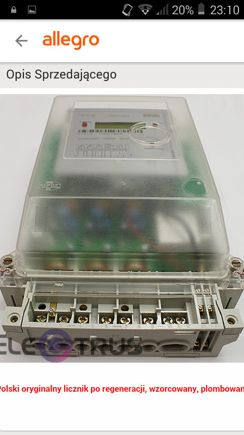

    kojak2464
    Posts: 28
    Rate: 27
    But you shouldn't take one phase out of three phases, because you overload it even though I gave the cable in a 4x4 garage. From what I watched today, the clown counter is of the type of the second photo and somehow everything is normally focused on the whole house and the hall. So, to sum up, I connect the power cable to the meter input, output and output, additionally the L1 and N cables, which will serve as 230, understand it well?

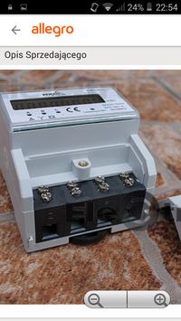

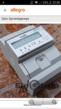

  • #18 17468627
    lukasz_ziel
    Posts: 64
    Rate: 25
    I checked, the search will not always lead to the topic I am looking for. The indicated topic does not give a clear answer, but after analyzing it, I assumed that the phase sequence when connecting the meter does not matter. I installed an electronic meter which, according to the topic in the link, should inform me when it is connected incorrectly. The meter does not communicate anything, so I assume that it is ok.
    I would like to add that I continued an old topic started by someone, and I did not start a new one. What does it mean that I am browsing the forum and not mindlessly letting someone answer me .... That's it when it comes to answering the question "Why?"
    Now I am doing an inquiry. I assembled the counter as in the photos.
    What are pins 2 for; 20; 21; 13; 15;
  • #19 17469140
    _jta_
    Electronics specialist
    Posts: 48943
    Help: 3205
    Rate: 4220
    2 is bridged from 1, I don't see any use for it, but maybe something was written about it in the manual from the counter. Maybe a lamp to illuminate the meter when reading?
    You can connect a pulse meter to 20 and 21 - from the marking I conclude that there is optoisolation there, so the meter input must have its own power supply, '+' to 20, '-' to 21, and it will not get any voltage - only connecting / disconnecting; it could be connected, for example, to a computer port (only which? not USB; printer port can be, but what computer has it now? serial has + -12V voltage, and there can be only one character; some Raspberry Pi or Arduino input can be connected there, it must have its own pull-up) so that the computer counts the pulses and has an independent counting (the conversion of energy into pulses will be the same), there are probably the same pulses that control the LED blinking.
    13 and 15 looks like the ends of the relay coil - but I do not know what it should connect, you would have to look in the manual. But ... I don't see them in the picture. Maybe they are in a place that is only accessible after removing the seals and are used, for example, to reset the error signal?
