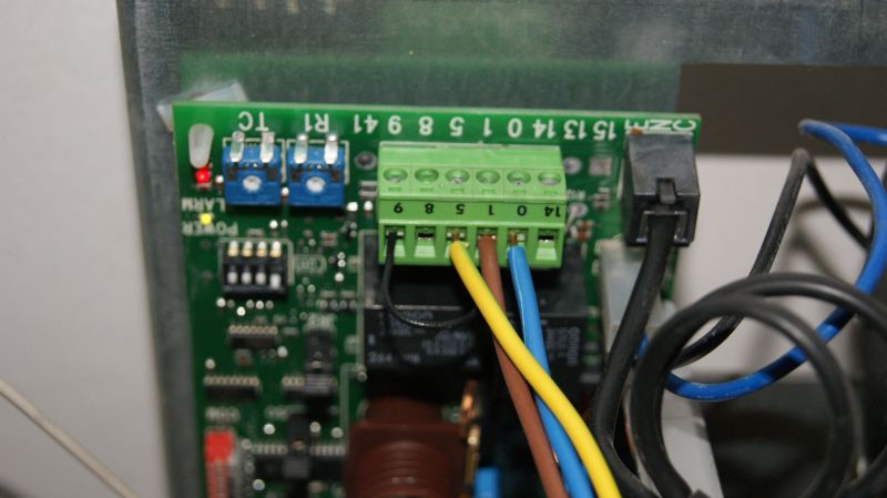

    I bought a drive for the Ditec garage door from Globe from a friend.

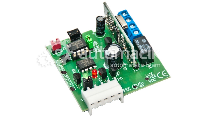

    I would like to connect it to a radio that is compatible with my FAAC sliding gate operator. And there is a problem how to do it.
    Globe has a radio on the motherboard. It seems that it is possible to connect another manufacturer's radio, but for which pins to connect.
    Radio receiver (lux 2/25) I own. Ditec a radio FAAC - Radioodbiornik FAAC (lux2/25) a napęd Ditec Globe
    The photo of the drive plate is here:
    Please help....

    It proposes to connect the radio supply to the terminals in Ditec 1+, 0-, while the signal for terminals 1-5, and DIP1 = ON. the gate in this setting will automatically close after the time set on the TC interval from 0 to 120 s. With TC set to MAX (above 130s), automatic closing does not work,

    Thanks for the answer, and if you can draw me on the picture under which pins should be hooked because the tile probably has no description.

    I put instructions with the radio diagram, it is nicely marked there, and the terminals in Ditec are described on the cube. Unfortunately, you need to connect wires to the radio or to top up or make an adapter from some old pins.

    I have a problem,
    the drive does not respond to anything.
    My settings:
    Jumpers:
    JR2 - shorted
    JR3 - shorted
    JR4 - open, external radio
    SO - open
    Ankle :
    0 - minus to the radio
    1 - plus for radio
    5 - K1 from the radio
    8 - bridge from 1
    9 - bridge from 1
    Small black cube with switches (probably DIP)
    1 - on
    2 - off
    3 - off
    4 - off
    I also tried to make a jumper between 1-9 - it did not help.
    The radio works for sure
    I am asking for help, below I attach photos:

    topic resolved:
    Ditec:
    JR4 - puller pulled (internal radio turned off)
    0 (ditec) - - radio (lux)
    1 (ditec) - + radio (lux)
    5 (ditec) - COM terminal (lux)
    1 of 8 (ditec) - jumper
    1 of 9 (ditec) - jumper
    Radio LUX
     - power supply as above (ditec 0 with GND and ditec 1 with + 24V)
    I made it with 1.5mm2 wire
     - COM terminal with 5 ditec
     - NO terminal with 1 ditec
    With this connection, we use the channel only 2 (because it is carried out by a relay to which we have connected the NO and COM control)
    P.S.
    The radio through the connector k1 and k2 is controlled (-), while the ditec is controlled (+).
    In case of ambiguity, write.
