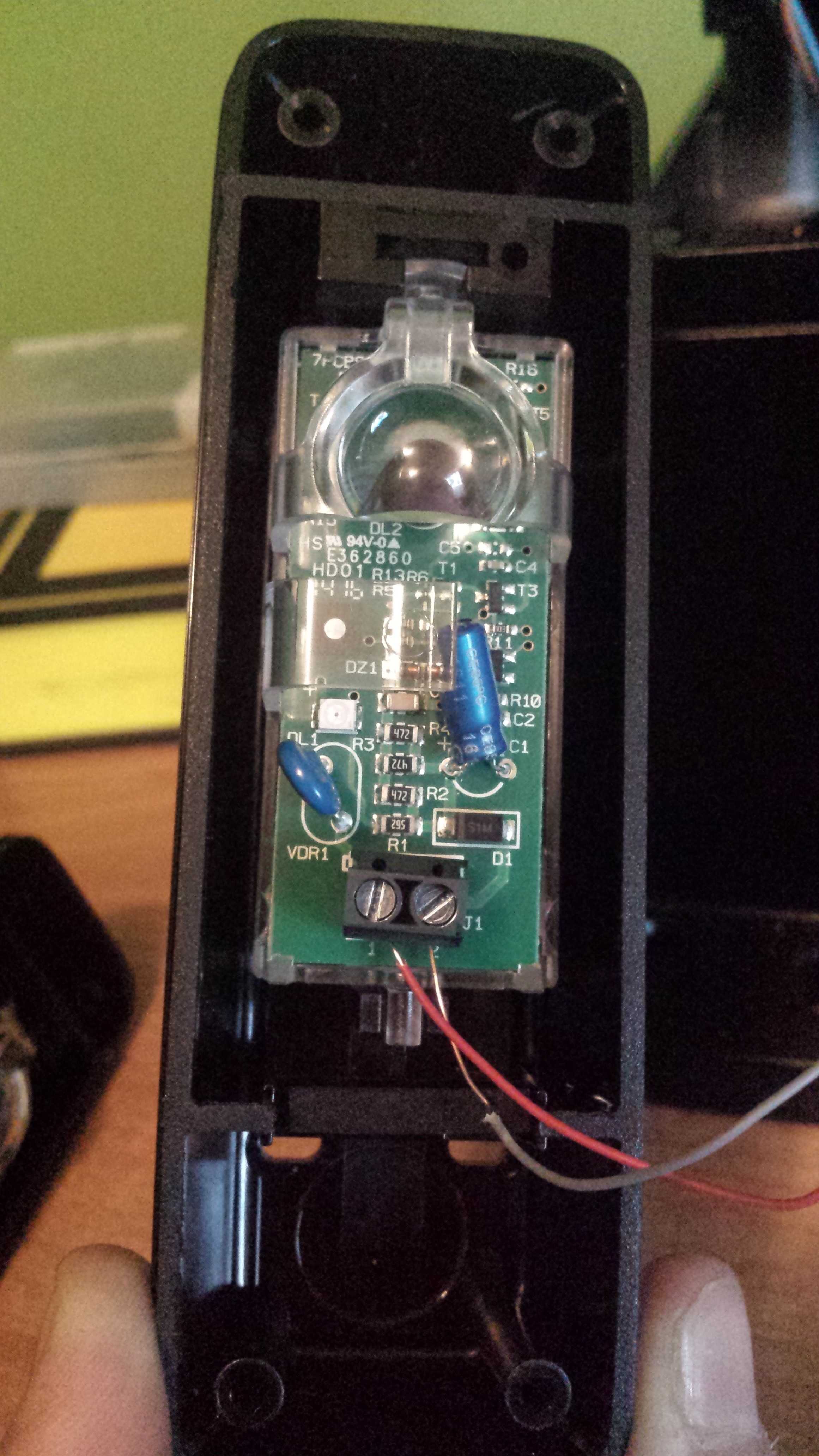

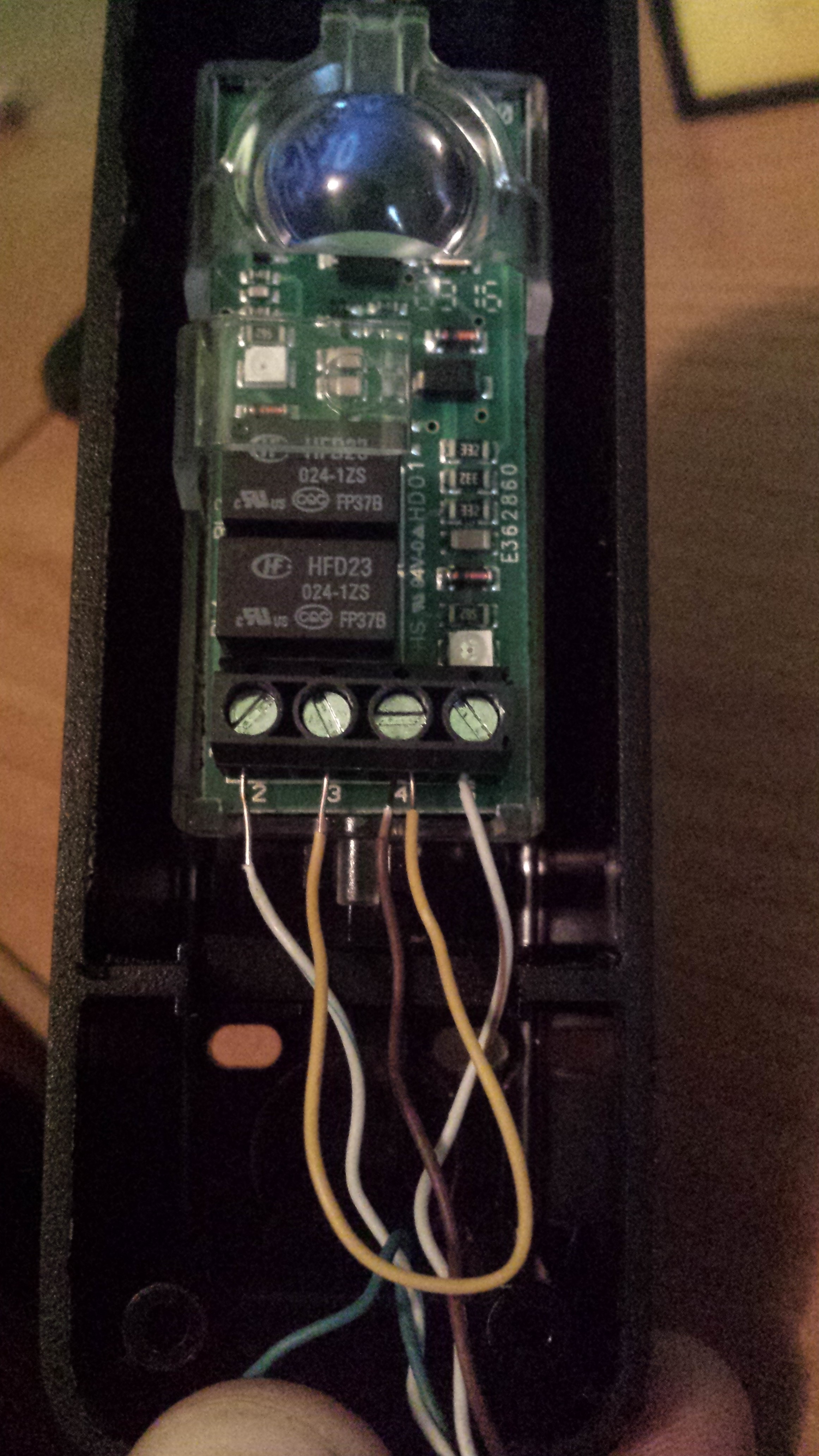

    As in the subject - it's about photocells. The drive has been pre-connected, remotes registered. Everything works except photocells - they "click" and the diode goes out when they are interrupted but they do not stop the motor or change the direction of rotation of the rack. I connected like this:
    Fig. TX:
    1 to 11
    2 to 9
    Fig. RX:
    1 to 4 Faac 740 Drive: Connecting Photocells for Motor Control - Wiring and Motherboard Bridge Setup
    4 to 8
    5 to 9
    and a bridge on pins 3 and 4.
    Motherboard Bridges:
    3 of 11
    4 out of 11
    5 in 7
    6 in 8
    I will add that I connected photocells "to close". I will be very grateful for any advice and help. Below are preview pictures:

    Connection of photocells according to figure 9 of the manual and will work.
    Disconnect the jumper from 5-7 purple wire.
    Disconnect the jumper from 4-11 blue wire
    I am not sure to switch places white-blue and white-brown
    It all depends on which terminals the receiver is powered (I think 2-3)

    Enter tomorrow on which wires the receiver's power supply is, and whether it matters (+, -) to which terminals it comes.
