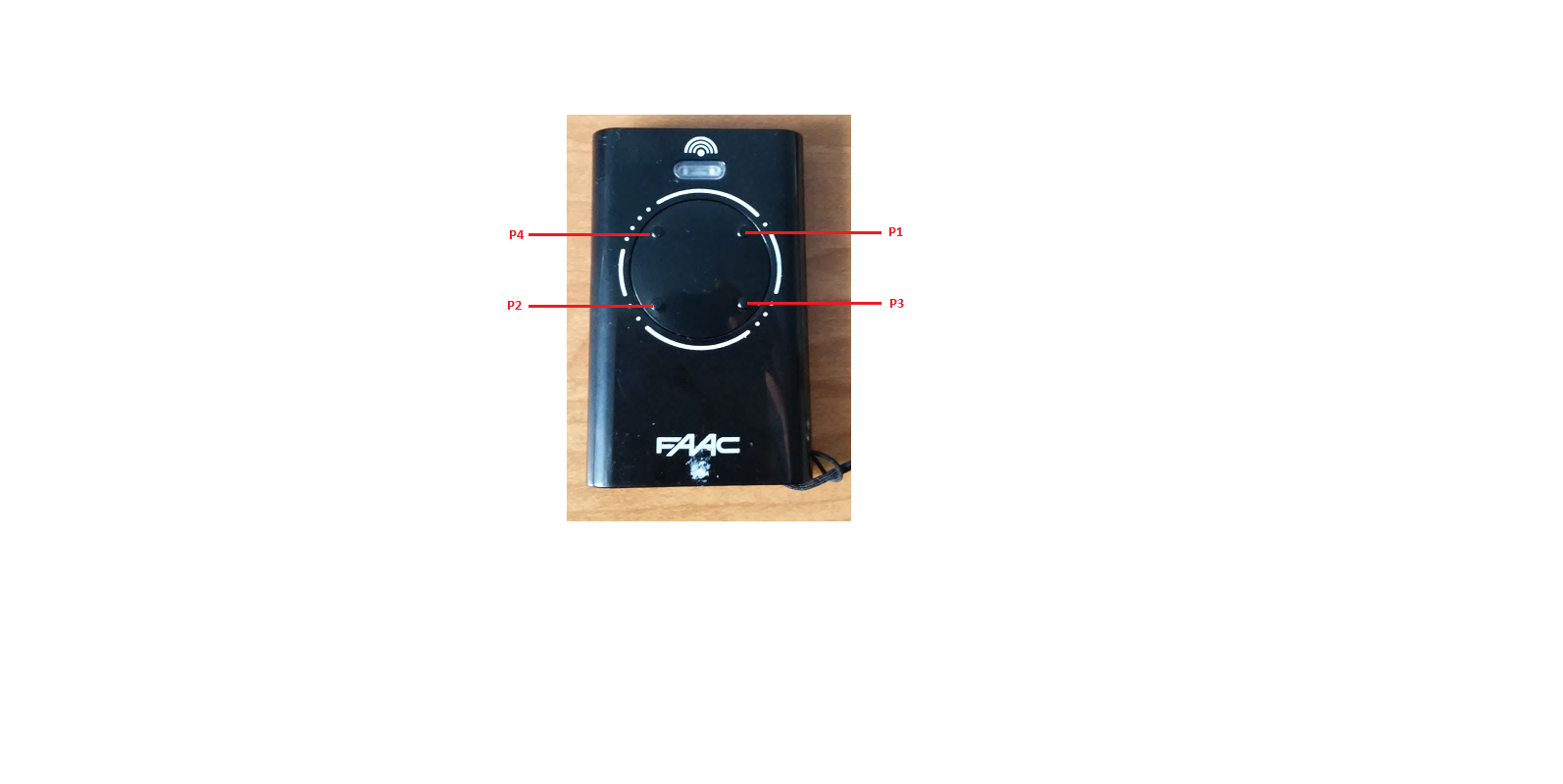

    Hello, gentlemen, automation engineers!
    Well, I have an actuator for the sliding gate FAAC 740. I have already connected everything but I stopped on one thing: how to connect the radio to the entire drive system. The terminals have the following terminals: COM, NC, NO. I think I should connect the negative pole (-) to the COM and the end of the NO contact to the OPEN A terminal (total opening). I will add that I made a local switch via the bell switch (the one with the spring) and this option works correctly. The second problem is coding the control panel and coding the pilots to FAAC.
    I add pictures of the radio and pilots:
    FAAC 740 Sliding Gate Actuator - Radio Connection, Pilot Coding, Terminal Guide (COM, NC, NO) FAAC 740 Sliding Gate Actuator - Radio Connection, Pilot Coding, Terminal Guide (COM, NC, NO)
    I am asking for a hint.

    Place the receiver in the connector and do not connect anything. It must work. The connector in question has a green sticky note attached.
    This is to look like in the picture below (found on the net).
    One channel of this receiver is just output there (except for power supply). At this point, you should already control the remote in the same way as the button connected directly to the drive. I do not know if they are already trained in the receiver when they buy the remote controls. If not, then there must be some instruction to teach them.
    If you deal with this and the drive will work properly (set limit switches and possibly photocells), then you will be able to use the second channel that this receiver has. It can be controlled by something extra, eg garage door or wicket function, or lighting). Then you use the contacts shown in the first picture (COM, NC, NO).
    Is everything now fairly clear?

    I understand, but write me exactly how to code the control panel and remotes. And what are the two buttons for the two channels for?

    PS. I would like to add that channel 1 is received by the central unit through a pin connector and is used for normal gate commissioning (ie step by step) and channel 2 does not support the second channel through the connector - you can connect the COM and NO terminals of the receiver to 7 and 2 of the control panel by connecting them to the function partial opening (wicket) or using peripherals for other purposes (eg to operate an electronic bistable relay and through it to turn the lighting on and off).

    Gentlemen, I set everything as it should, according to the instructions and everything works correctly. Also, I can confidently close the topic.
