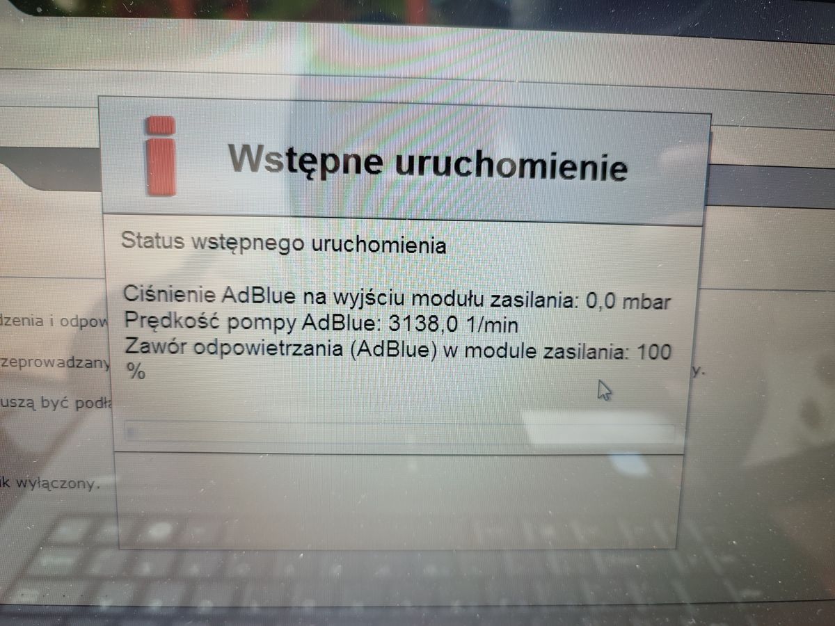

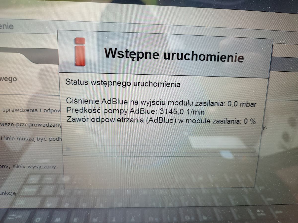

  • Pump runs but fails to build AdBlue pressure
    #11 19624359
    hehe_2288
    Posts: 183
    Rate: 71
    It displays error 05031-02.
    I put in new filters, 3 pcs. The hoses are clogged. I tried to bleed the system with the computer and it failed, the pump works but does not generate pressure. Is the pump to be replaced? I wonder if when venting the system, the vent valve is 100% open and after some time it drops to 0%. Should it be like that? Saw pump repair kits (diaphragms and sealants). Will someone suggest what to do in this case? MAN TGA 440 Euro5 AdBlue error GDK / PDF 05031-02—what causes this fault? MAN TGA 440 Euro5 AdBlue error GDK / PDF 05031-02—what causes this fault?
    I will add that a year and a half ago I installed a new Bosch pump.
  • #12 19625004
    kakibara
    Level 35  
    Posts: 2379
    Help: 202
    Rate: 1283
    Do you have a wire inserted in the dispenser and will you check if it is not connected?
    After such works, I always vent with the unplugged and when it shows up, I turn off and put on the cable.
    The pressure rises when it hits it, it starts to regress.
    Well, when the pump works and it does not beat, it needs to be replaced.

    I didn't have to wait long, the pump lasted a month and a half, new! Same error again, pump does not build up pressure. Could something be the reason why these push-ups sit down so often? It has been my third pump for less than 2 years ...
    Added after 1 [hours] 6 [minutes]:
    I ordered an adblue bleed valve, we'll see if it helps.
    I already have 3 pumps, each engine works and does not generate pressure. I'm not going to buy another one, someone will tell you where I can get a good repair kit for the adblue pump? I would also be grateful for the catalog number.

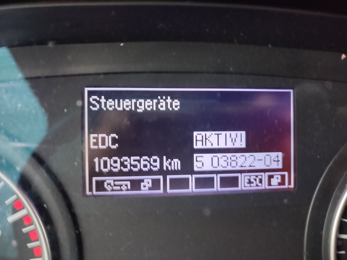

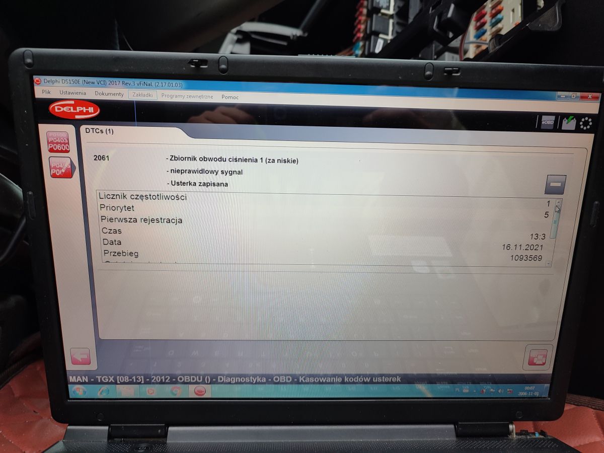

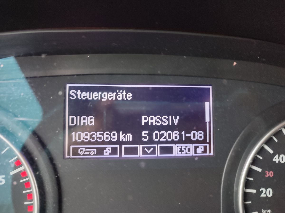

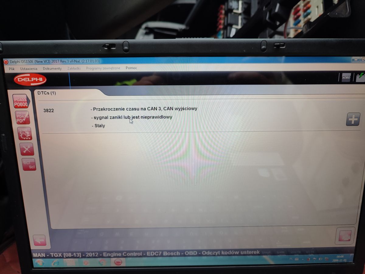

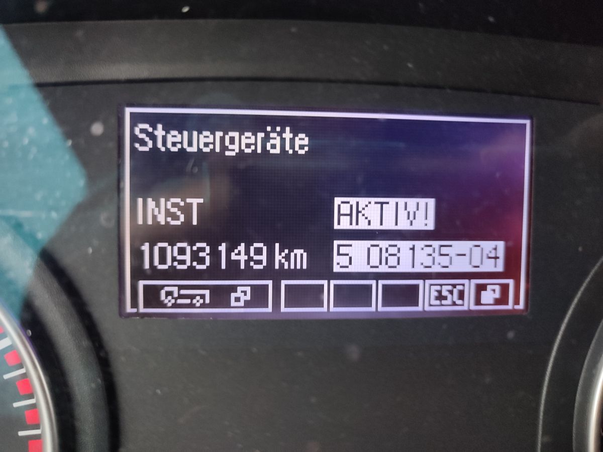

    #26 19712206
    hehe_2288
    Posts: 183
    Rate: 71
    The trail goes me with this adblue ....
    The pump flooded me, I bought a used, supposedly 100% functional, with the same numbers as mine. I have connected everything and I do not want to communicate with the controller. Mistakes keep popping up. Do I have to match the pump with the car somehow? MAN TGA 440 Euro5 AdBlue error GDK / PDF 05031-02—what causes this fault? MAN TGA 440 Euro5 AdBlue error GDK / PDF 05031-02—what causes this fault? MAN TGA 440 Euro5 AdBlue error GDK / PDF 05031-02—what causes this fault? MAN TGA 440 Euro5 AdBlue error GDK / PDF 05031-02—what causes this fault? MAN TGA 440 Euro5 AdBlue error GDK / PDF 05031-02—what causes this fault?
    Added after 32 [minutes]:
    I will add that it does not show the adblue status on the meter
  • #27 19712543
    kakibara
    Level 35  
    Posts: 2379
    Help: 202
    Rate: 1283
    If there was communication with the computer on the other one, then you have no communication with ... or, if possible, move the computer from the old adblue pump to yours.
