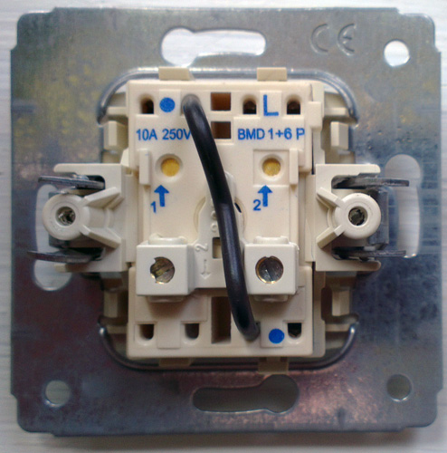

    I can not cope with connecting the roller shutter switch up / down.

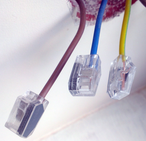

    4 cables come out of the roller shutter (as shown in photo no. 1), and 3 cables come out of the wall (photo no. 2).
    Unfortunately, I can not read diagrams, so I would like to ask for a specific outline where which cable should go, photo 3 shows the switch and number 4 shows the connection diagram.

    Oh man, these are the basic things. Blue N from the installation, blue N from the roller shutter, protective PE with the protective one from the installation. Phase L to terminal L on the connector. Brown and black are "up / down" controls, you connect them to the lower connector terminals. Which one you have to check by trial and error.

    Blue from the blinds from the blue from the tin, the same yellow and green together. Brown from the box for the L terminal of the switch, and the other two, i.e. brown and black, for the other two terminals of the switch. If you press the down button and the roller blind will roll upwards, you will have to swap these wires. Regards
