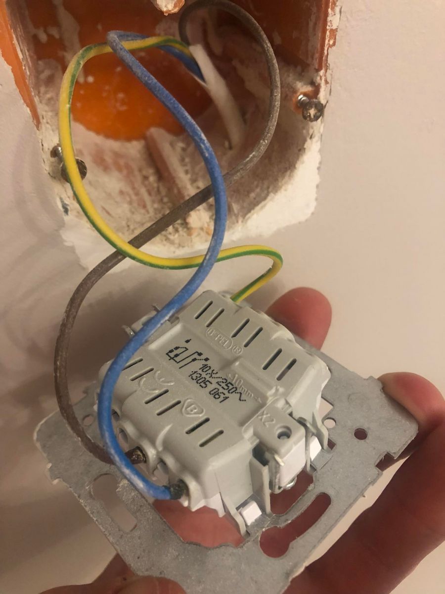

    I would like an answer to the question about the possibility of connecting Shelly 2.5 to the central switch of the roller shutters. My roller shutter installation is based on Bister model RCS4E controllers. In each box at the roller shutter under the switch sits such a controller. In addition, I have a group switch for 4 roller shutters in the living room and a group switch for all the roller shutters. As time has gone on, I have started to think about automation at least on a central level, but I have my doubts as to whether this can be done. Attached is a photo showing what one of the group switches looks like. There are 3 wires coming out of the box and each is live as if L1, L2, L3. When L1 and L2 are connected, the roller shutters close, and when L1 and L3 are connected, the roller shutters stop and open when pressed again. Is it possible to connect the Shelly 2.5 controller to this? I would add that there is a neutral wire in the box upstairs if it would be needed to close the circuit. Is it possible to arrange this in this box or do I need to combine in the switchboard and I do not want to do this myself.

    The first thing that strikes one's eye is an installation done defectively (I don't know who did it).
    The protective conductor must not be used for any other purpose than protection.
    The photo shows that it was used incorrectly (as a phase wire).
    From my side, it is a piece of advice, ask the contractor to do the installation correctly (the wire should be a minimum of four conductors (not as it is)

    If you tighten the N then it is possible to Shelly 2.5 connect.
    Only one is L - the other two are control - there is no L1, L2, L3.
    There are 2 ways to connect - either a connector in parallel to Shelly 2.5 or a connector to Shelly 2.5 and only Shelly 2.5 controls.
    The colours of the wires - as the Col. above writes - are not suitable, in which case they can be properly marked on both ends with shrink sleeves, for example. Lack of such markings is unfortunately a very common problem.
    EDIT: When tightening N, make sure it is "through the same RCD" as L.

    - where is such a provision? In the regulation § 183. 1.? Does it also apply to the control installation or only to the electrical installation - "in distribution and consumer circuits"? Here it is true that there is an L, but this is not a supply installation (no N).... According to the instructions, there should be red (L) and brown and black (control) wires.

    - this is not what I noticed. On the contrary. I pointed out the absence of N (it's not needed for anything here), i.e. it's not a supply circuit - neither a receive nor a distribution circuit. From a function point of view - it is a purely control circuit. So it is difficult here to apply regulations or standards as for a consumer circuit.
    I agree that wires with reserved colours should not be used. It is also unclear whether the installer knew how this circuit would be used, maybe the concept changed and this change resulted in such a situation.

    When all the wires are unplugged from the connector and I check them with a tester then each wire separately is live.
