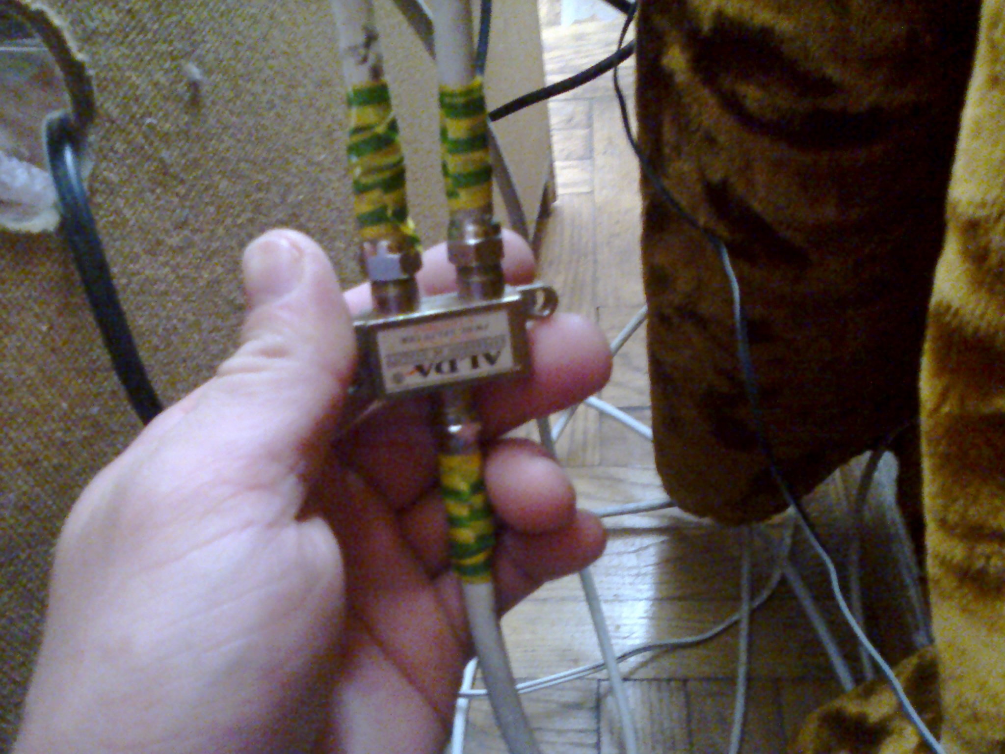

    Such something was in the Alda 5-900MHz store I have not yet assumed, but I have a question what is this screw?
    How to Connect Two TVs to One Mesh Antenna Without Losing Signal Quality
    The whole is "grounded" through the cable shield.

    What am I doing wrong? To in I connect the antenna cable to one socket out the antenna cable that goes to the other room of the second TV to the other out a piece of wire that goes to the main TV with the power supply

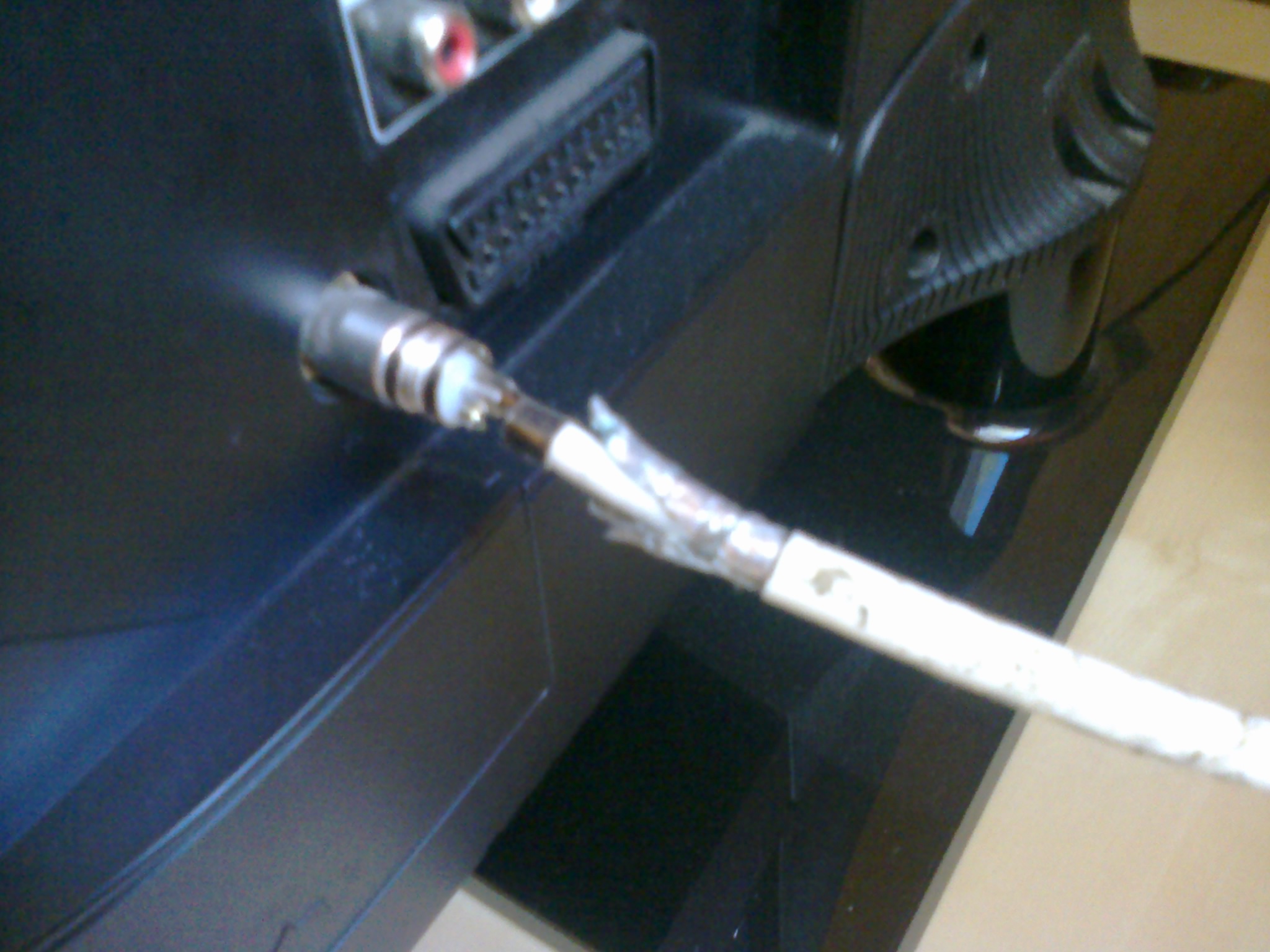

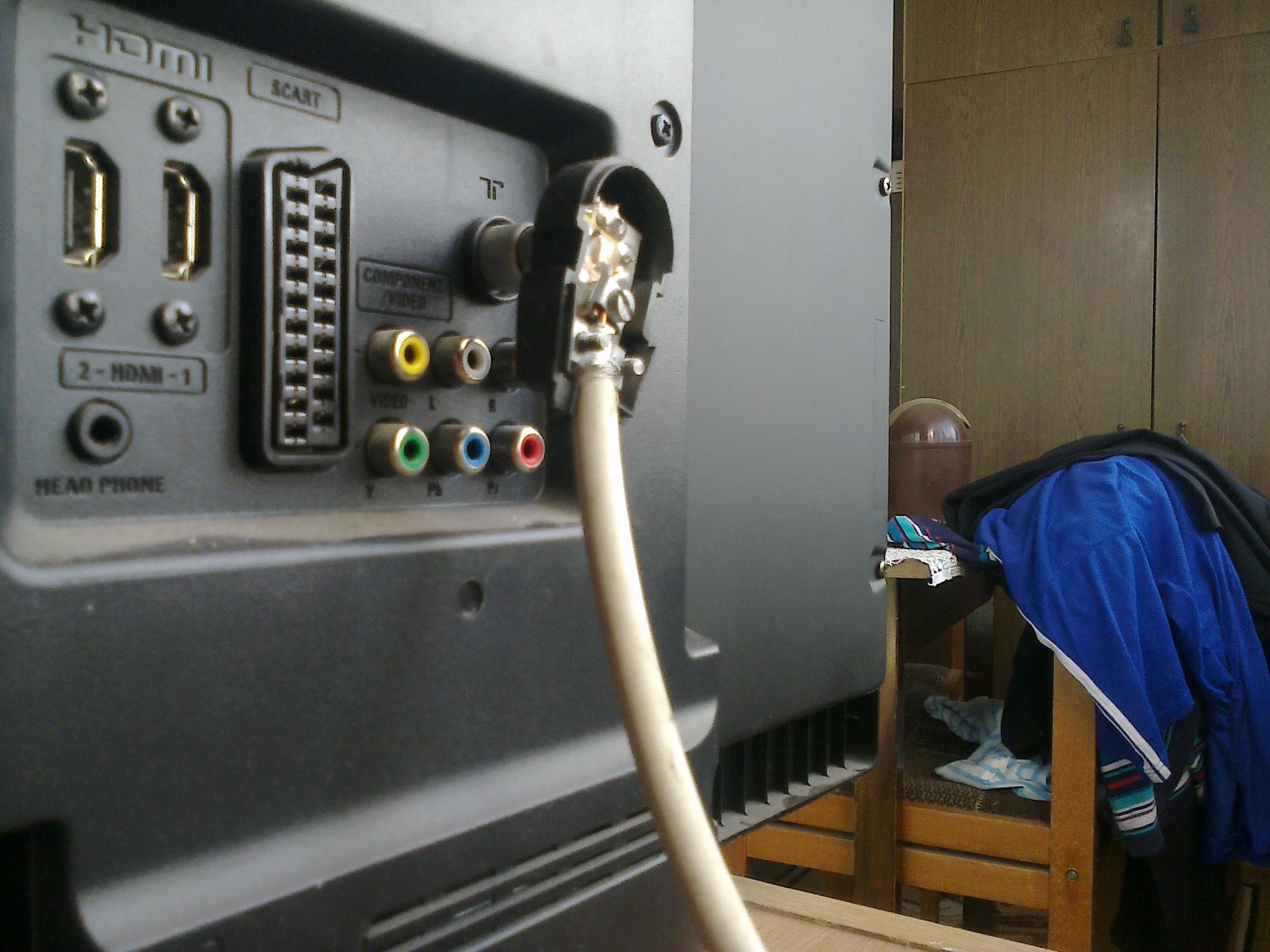

    Current connection:
    Main antenna cable with power supply 024. Main TV 026, splitter 025, second tv 027. The LED in the power supply is on. The main TV works normally TV 027 only has a few channels that are clipping.
    • How to Connect Two TVs to One Mesh Antenna Without Losing Signal Quality Zdj__cie0027.jpg (422.71 KB) You must be logged in to download this attachment.
    • How to Connect Two TVs to One Mesh Antenna Without Losing Signal Quality Zdj__cie0026.jpg (680.09 KB) You must be logged in to download this attachment.
    • How to Connect Two TVs to One Mesh Antenna Without Losing Signal Quality Zdj__cie0025.jpg (589.62 KB) You must be logged in to download this attachment.
    • How to Connect Two TVs to One Mesh Antenna Without Losing Signal Quality Zdj__cie0024.jpg (611.58 KB) You must be logged in to download this attachment.
