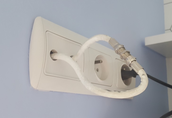

    I have a cable from UPC and it looks like this:
    1. The cable goes to splitter # 1:
    UPC Cable Splitter Setup: Managing Multiple Decoders & Antenna Pass-through Connections
    One of the legs goes to the TV, the other one as below (point 2)
    2. The second splitter, which splits the signal into 3 wires:
    - cable 1 not used (there was a Mediabox no.2 decoder)
    - cable 2 UPC Horizon decoder (everything ok)
    - cable 3, unfortunately, goes to the pass-through antenna socket and then further to the next socket, where the Mediabox decoder number 1 is (works properly).
    Everything worked (when the MB 2 decoder was on the # 1 cable), but now I need the decoder to give it a pass-through antenna.
    So I removed this socket and now what to give a "tee"?
    I have two that stayed when the UPC technician worked for me previously:
    I connected to this on the right, but pixelosis terrible on MB2 (MB1 is OK).
    Someone will help or call a service technician?

    I suspect there is too much signal attenuation as it passes through so many signal splitters and you have pixelosis as a result.

    There was pixelosis once, but they increased the signal strength for me (so they said) and it was ok on all 3 decoders.
    Only then was each decoder on one cable coming from the other splitter.
    Now I have to pull 2 decoders on one cable - hence the need to use another splitter.

    I understand that the receiver did not work when plugged into the socket?
    It worked, but the pixelosis was terrible, so let's assume it didn't work.
    It should work without any problems, especially if the other receiver (M1, the one on the old 'flight') was working. I mean, there is something wrong with this socket:
    - you connected something wrong. It is rather difficult to connect wrongly, the more so because now (for MB1 to work and no socket) I just connected the input with the output. Oh yes:
    - damaged TRIS - just swap the outputs and you will know I tried.
    - damaged or some 'left' cable connecting the socket to the receiver (replace it with another one) Good cable, even once made by a service technician - crimp terminals.
    - not very sensitive M2 decoder in relation to M1 (switch receivers) It's the same model, after all. But if it can be set in them, I would have to call a guest from UPC.
    When it comes to TRISs, in the past there were such sockets / splitters in cable TVs separating the signal into TV and IP modem.
    That's what I had before the Horizon era
    It can also be used as a splitter for receivers - it has equal attenuation on both outputs, but slightly higher than the standard splitter.
    You can also use the one on the left - this in turn is a splitter for three with the separation of the return path on the two inputs.

    I would put the first Teleste DSS2 splitter into the socket, which is at the entrance to the apartment and will be unused. It is needed because a TV (analog) is connected on one leg, the other leg (min.10 meters) goes to the distributor No. 2 (BSS3) Unless it has to remain, then one of the Tris or some decent splitter for two. Exactly! But which???? There is a lot of it on the Allegro, I don't want to buy something bad.
    It doesn't work because those, as you called it, "tees" are multimedia crossovers and it is not assembled as an ordinary tee.

    I used this red Tris (4.6 and 4.0 dB), but most of all I replaced the cables, i.e. the standard antenna cables (those directly to the TV) were replaced with screw-on cables (+ adapter).
    Now it is so that on both TVs (where there are MBs) there is a nice picture. Occasionally there is a brief pixelosis to survive.
    I will do that for now.

    TRIS 307P is a multimedia socket from TRATEC - with 2xDATA + 1x RTV outputs.
    TRIS 212E is a 1/2 splitter terminal socket also from TRATEC - with a return path lock on one of the outputs.

    I used this new distributor:
    There is no data on attenuation, but at the auction it was: 3.2dB.
    Non-pixelated image, signal strength 100%, quality 92% (or vice versa). It's ok
    To sum up: the most important thing is the correct and reliable connection of the wires and a low-loss splitter.
