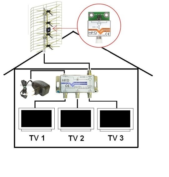

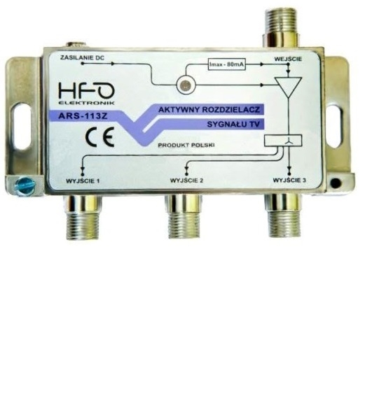

    I was asked by a colleague what to connect to the antenna to watch terrestrial TV programs on three televisions. I showed what works for a few years with me.
    I have a Yagi antenna for a tile, and an ARS-113Z amplifier with a power supply next to the TV set. The system has been operating for several years and a neighbor uses one output.
    Two German MUXs are within reach. Connecting Two DVB-T TVs Simultaneously with One Antenna: Rooftop Antenna Usage & LCD TV Decoders Connecting Two DVB-T TVs Simultaneously with One Antenna: Rooftop Antenna Usage & LCD TV Decoders
    I have a cable TV, but in 2016 during the European football championship we watched all matches. Even those played in parallel, on Das Erste and ZDF programs.
