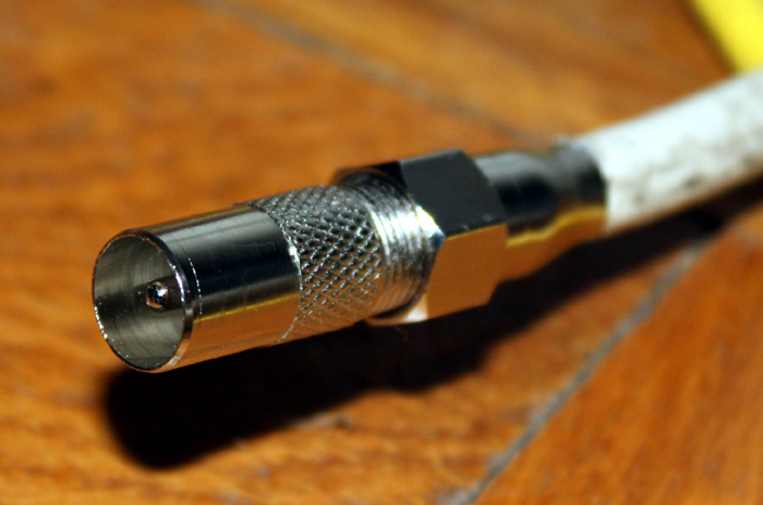

    In addition, one more tiny problem: I wanted to check if the TV would catch any signal at all, so I disconnected the cable from the router and to the TV ... and this end from the router does not go to my TV. I unscrewed the part and tried to connect it:
    Dividing Single Antenna Cable for TV and Internet - Choosing the Right Distributor
    Can it be removed somehow? Do I need to buy a ticket? Maybe some names how it differs, what is the difference between the input to this router and the input of the antenna to the tv? Even that will help me.

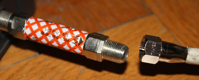

    #10 11345188
    ananaszpuszki
    Posts: 8
    True, there is something like this:
    I bought this passage and connect it to the TV:
    It caught a few channels, but my tv is snowing terribly. I searched for channels, changed frequencies and it still snows. I do not know what to do. Could it be the fault of the cable? I think it's a bit old, but the internet works great (I don't know if that matters at all). The TV is definitely working.
    If this continues, then I will not split the cable, and the TV will only be used to play on the console. However, I would prefer to be able to try other options.

    You have to call the cable operator, let them switch on at least the basic package, only then do not buy anything, the signal provider will install the socket and wiring himself. For example, the Multimedia Internet package 12 Mbs + TV is only PLN 79
  • #12 11346480
    stolarek_1988
    Level 21  
    Posts: 467
    Help: 42
    Rate: 55
    They have an LP filter in the switch box on the staircase - that's why you don't receive a clean TV. Installation should be performed by a TVK installer.
