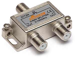

    nostromo6464 wrote:
    How to connect two antennas to one dvbt decoder
    As my colleagues suggest and you can additionally try it with an antenna splitter, e.g. such as https://dvbsklep.pl/pl/p/Rozgaleznik-TV-dwudrozny-R-2-Signal/122
    Connecting Dual Antennas to DVB-T Decoder for Multi-Direction Broadcasting Reception Connecting Dual Antennas to DVB-T Decoder for Multi-Direction Broadcasting Reception
    This is the simplest solution but:
    1. It transfers frequencies from 5-1000Mhz, that is, everything in this band, not only programs.
    2. Has a short circuit to the power (DC) of the antenna.
    In summary, it can be used, but as part of the tests and if the antenna has power, the splitter must have one of the branches intended for DC transmission.
    This is how the proforma wwsplitter can be connected inversely, i.e. to IN = DVB-T tuner and to OUT = Ant.1 and Ant.2.
    nostromo6464 wrote:
    What would be the best
    It depends on which transmitters the signal will be received from.
  • Connecting two directional antennas to one TV tuner

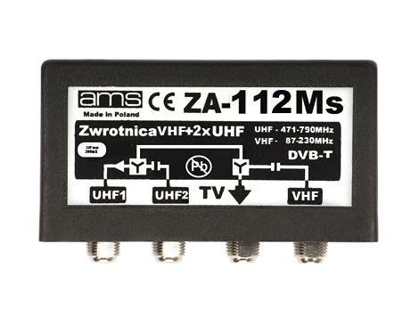

    #10 16461574
    nuszek
    Level 30  
    Posts: 1421
    Help: 123
    Rate: 389
    Without checking the strength of signals from the directions you are interested in, it is difficult to give advice,
    The crossover introduces damping, maybe you need to provide a crossover with an amplifier.
    You can use one for checking, the cost is low.
    ANTENNA SWITCH ZA-112Ms (Z1005)
    It has an additional input on VHF / MUX 8 /.
    We have two antennas installed / direction Gorzów and Śnieżne Kotły / and with this tuning, the decoder tunes all channels from both antennas, then leaves only those that do not double when recording, i.e. the regional TVP Gorzów Wielkopolski adds us to the package broadcast by Wrocław . It's not like I have two TVN, two Polsats, etc.

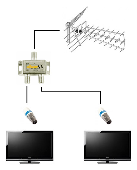

    #12 16462060
    LeDy
    Posts: 19127
    Help: 1992
    Rate: 2940
    Such a thing, for example, and the way of connecting Connecting Dual Antennas to DVB-T Decoder for Multi-Direction Broadcasting Reception
