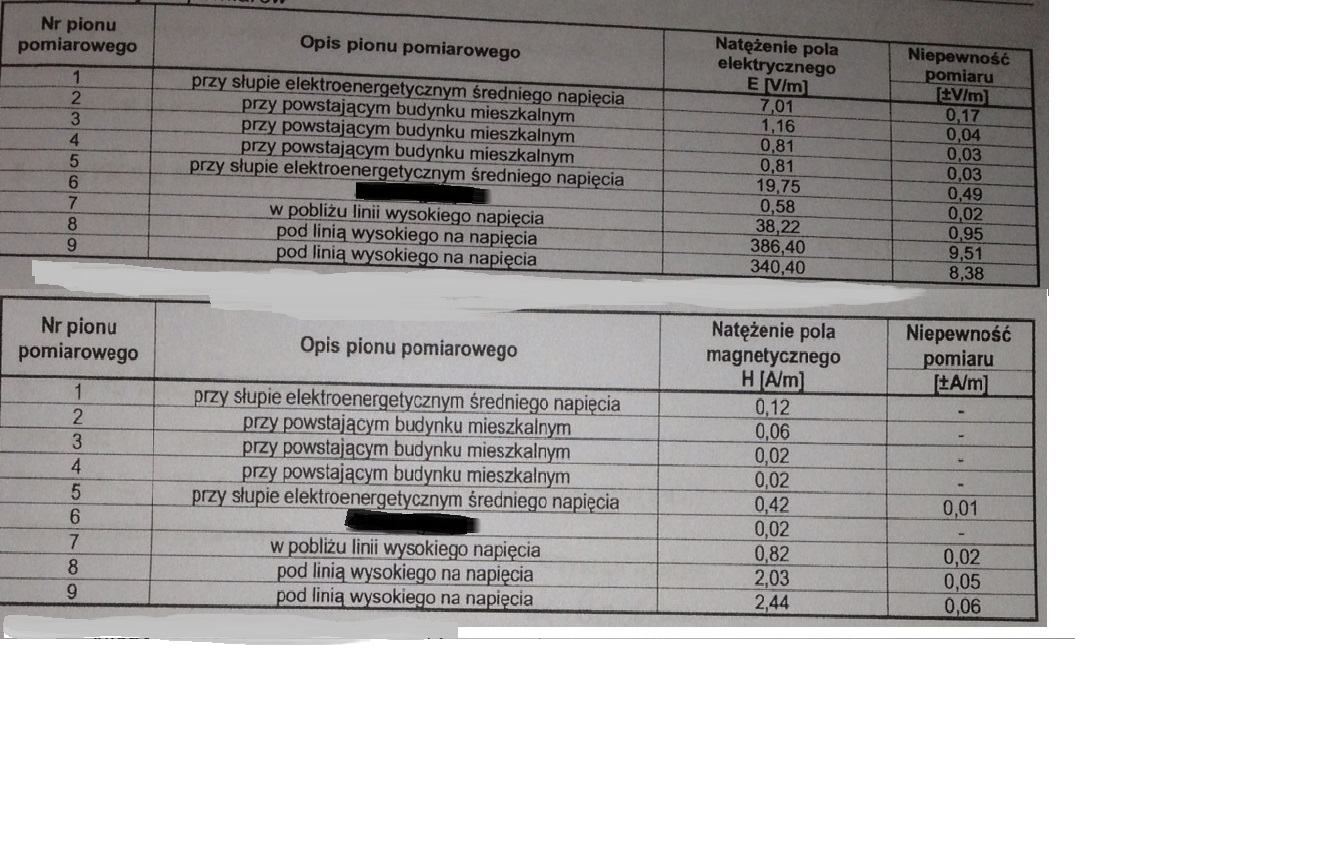

    I am thinking of buying a plot with a house on which there is a medium voltage pole (so I was told) 15kV. I don't know about it and I don't know if it's 15kV or more. I read various opinions on the Internet about the harmfulness of the electromagnetic field generated by this type of poles. All entries are for overhead lines. There is no overhead line across the entire plot on the plot planned for purchase. The pole is the end of the overhead line and from the plot I want to buy the cables are underground. Overview drawing with a photo of the pole below.
    Please, if possible, give your opinion on the harmfulness of this type of construction and information whether it is 15kV?

  • #2 12661650
    ZidaneNS

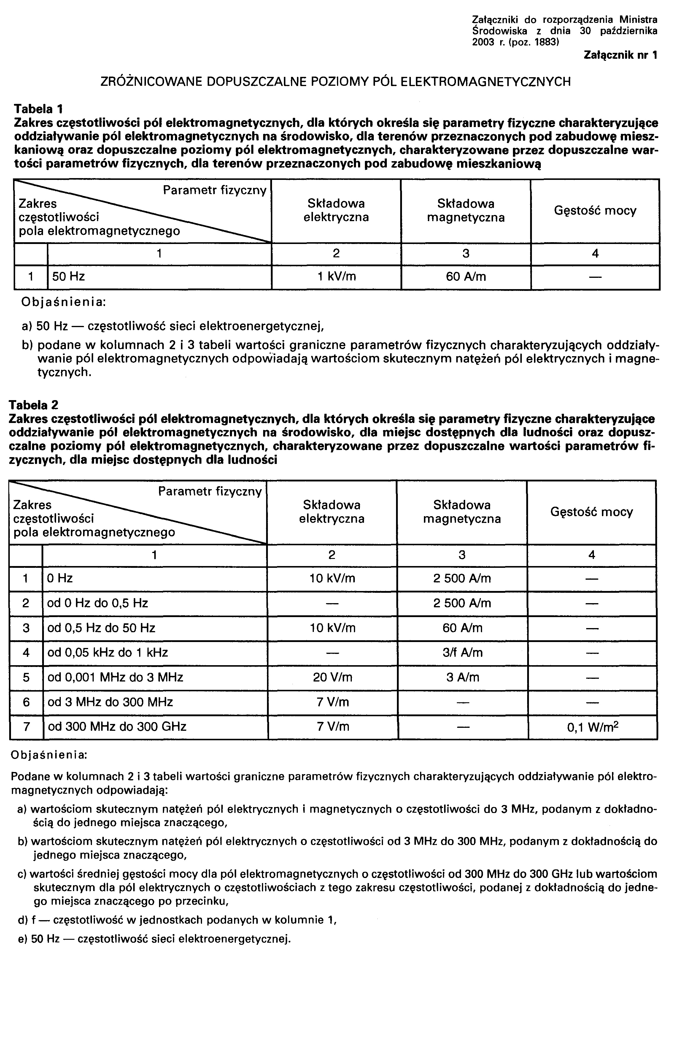

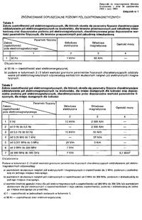

    I have a question for you or the information from the measurements below
    Buying a Plot with 15kV MV Pole: Assessing EMF Harmfulness, Overhead vs. Underground Cables
    are within the standards
    Regulation of the Minister of the Environment of October 30, 2003 on the permissible levels of electromagnetic fields

    Since 1000 V/m is allowed, and there is 386.4 V/m, does it fit or not? Similarly with the magnetic component, 60 A/m is acceptable and 2.44 A/m is.
